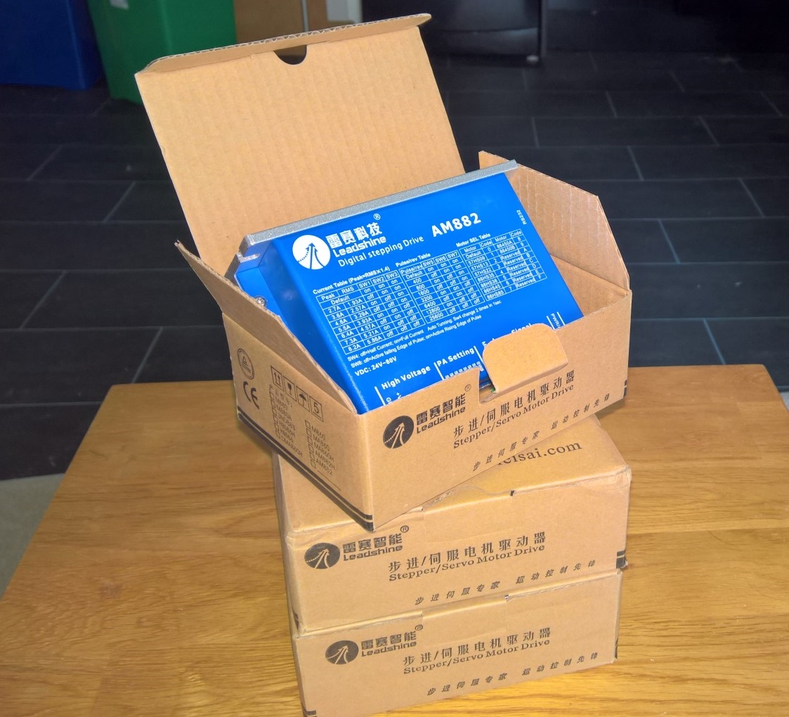

    I just bought some AM882's on Ali Express from Hection's store
    They came in 5 days and including postage, import duty & credit card foreign exchange, they came out at £67 each.
    They are £105 in uk (inc Vat) so saved more than £100 on all 3.
    Your mileage may vary, but it was a lot easier than i expected and i would definately use this method again if i needed more,

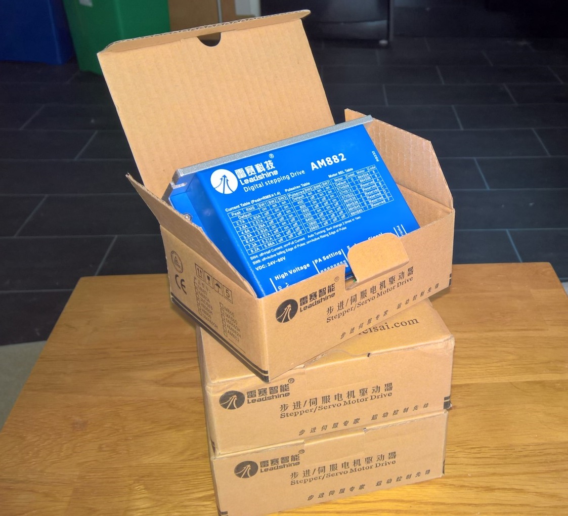

    Quote Originally Posted by Greeny View Post
Name:	WP_20170415_15_15_35_Pro (Large).jpg
    Thanks for the reply. Do you have a link to the seller? What did you end up paying in VAT and customs clearance?
    David
  8. #7
    I got them sent via DHL which was very quick & paying import duty & vat was easy as DHL emailed a link to to a payment screen.
    Unfortunately, that posting option doesn't seem to be available now, and they also seem to have gone up a bit from US$73.99 to US$78.71, so it might pay to shop around.
    They took a couple of days to dispatch & Delivery took about 5 days, so it was about a week in all
    Anyway here's a link & breakdown of what i paid.
    https://www.aliexpress.com/item/New-...608.0.0.OXkOQc
    (I was mistaken I bought 4 not 3).
    4@ AM882 (US$73.99 each)= US$296.00 incl postage = £237.63 on my credit card (incl currency transaction fee)
    Import Duty & vat was £23 paid direct to DHL
    So
    237.63
    + 23.00
    260.63 For 4 = £65.16 Each
    It all went very smoothly for me, but i've only done it once so bear that in mind.
