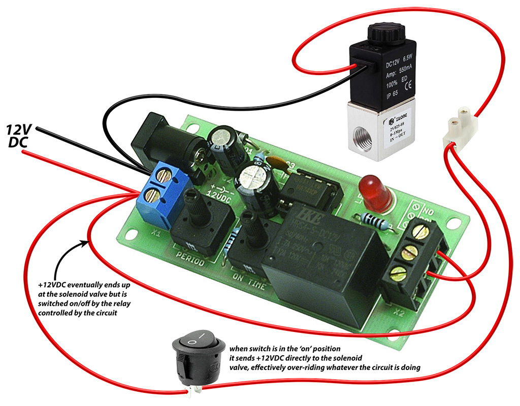

    Right, got this made now. It's flung together into an empty air-rifle pellet tin I had lying about, but it seems to work alright...
    I eventually used this circuit.
    ...you can get essentially the same thing for half the price here - I assumed at the higher price that this was pre-soldered - it wasn't..! The two pots that control the interval/pulse are a bit sensitive, but otherwise it's a decent enough kit and very easy to put together. I didn't need the fly-back diode after all.
    Thanks to Clive for suggesting the switch to over-ride the circuit and keep the air on continuously - useful and pretty much a necessity..!
    Here's a vid of it in action:
    And for fellow electronics dunces, here's a diagram of how it went together:

    Glad you have it fixed up and running Wal. Have you put a grommet around the red/black wires out of the tin ? to stop chaffing.
  4. #14
    Wal's Avatar
    Hi Clive, I didn't have any grommets to hand, so I've hot glued (around the holes) all wires going in/out... stops 'em moving about.
    Wal.
