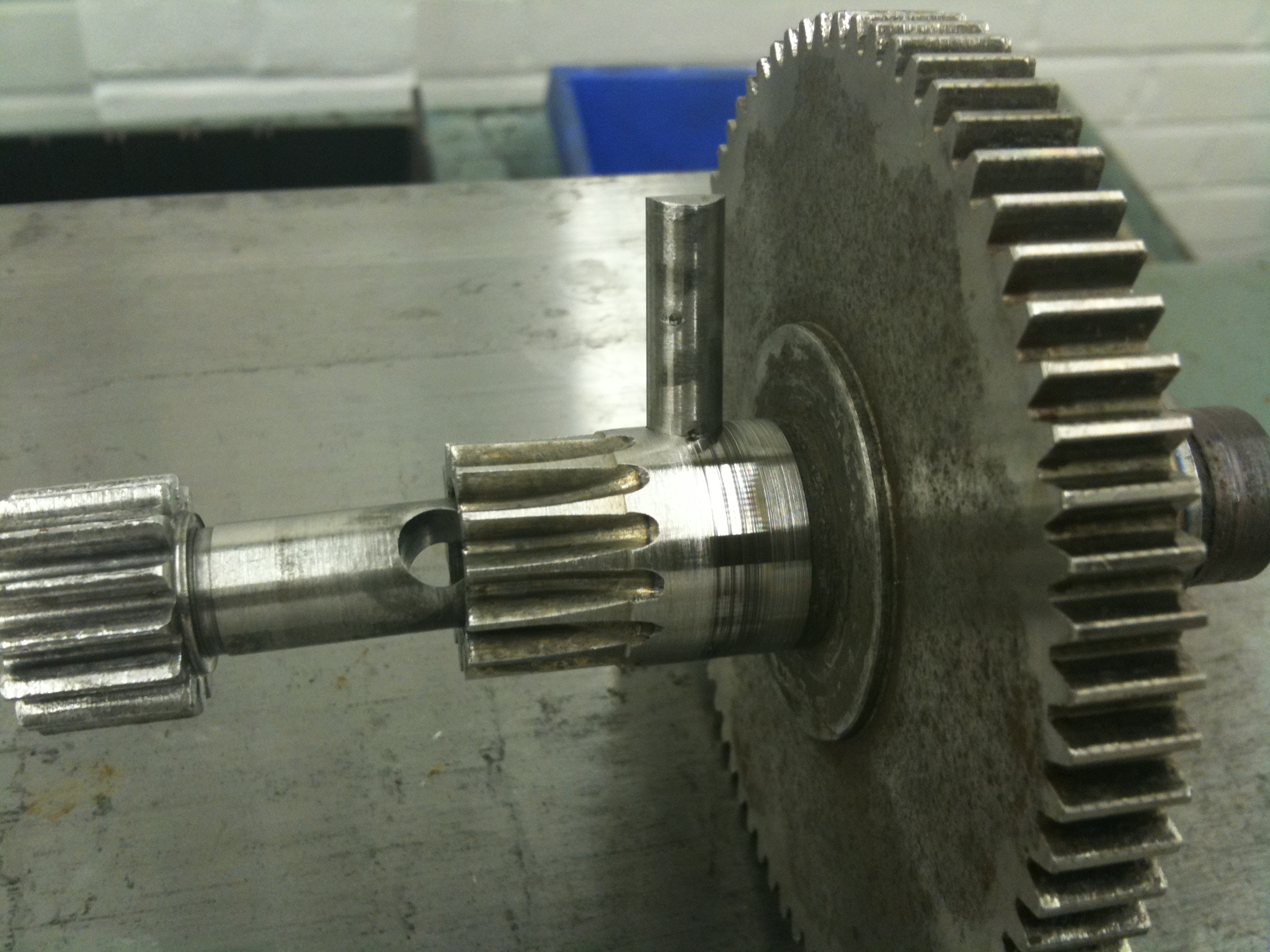

    I've now got the carriage apart and guess what! The gear rack is no good. It has been repaired badly, see pics. I think I need a new one. I've been on to Hardinge because they show two types on their site, English and Metric, but nothing about the EM model. They were being quite helpful until I told them it was for a Feeler at which point they told me that their super precision parts were not suitable for that Taiwanese copied crap and cleared down on me.
    So, mine has a 70 tooth major and 14 tooth minor. If anyone has a similar gear in their machine can they tell me if it's metric or imperial and I'll order it from Hardinge. It may make my Taiwanese copied crap more accurate!!!

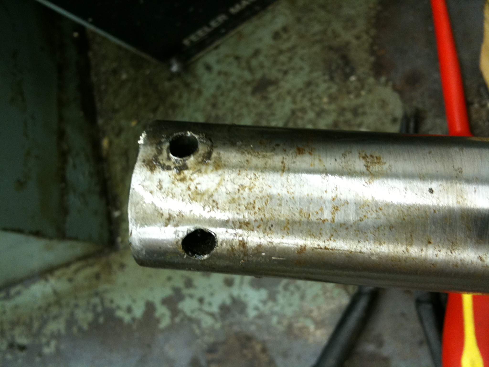

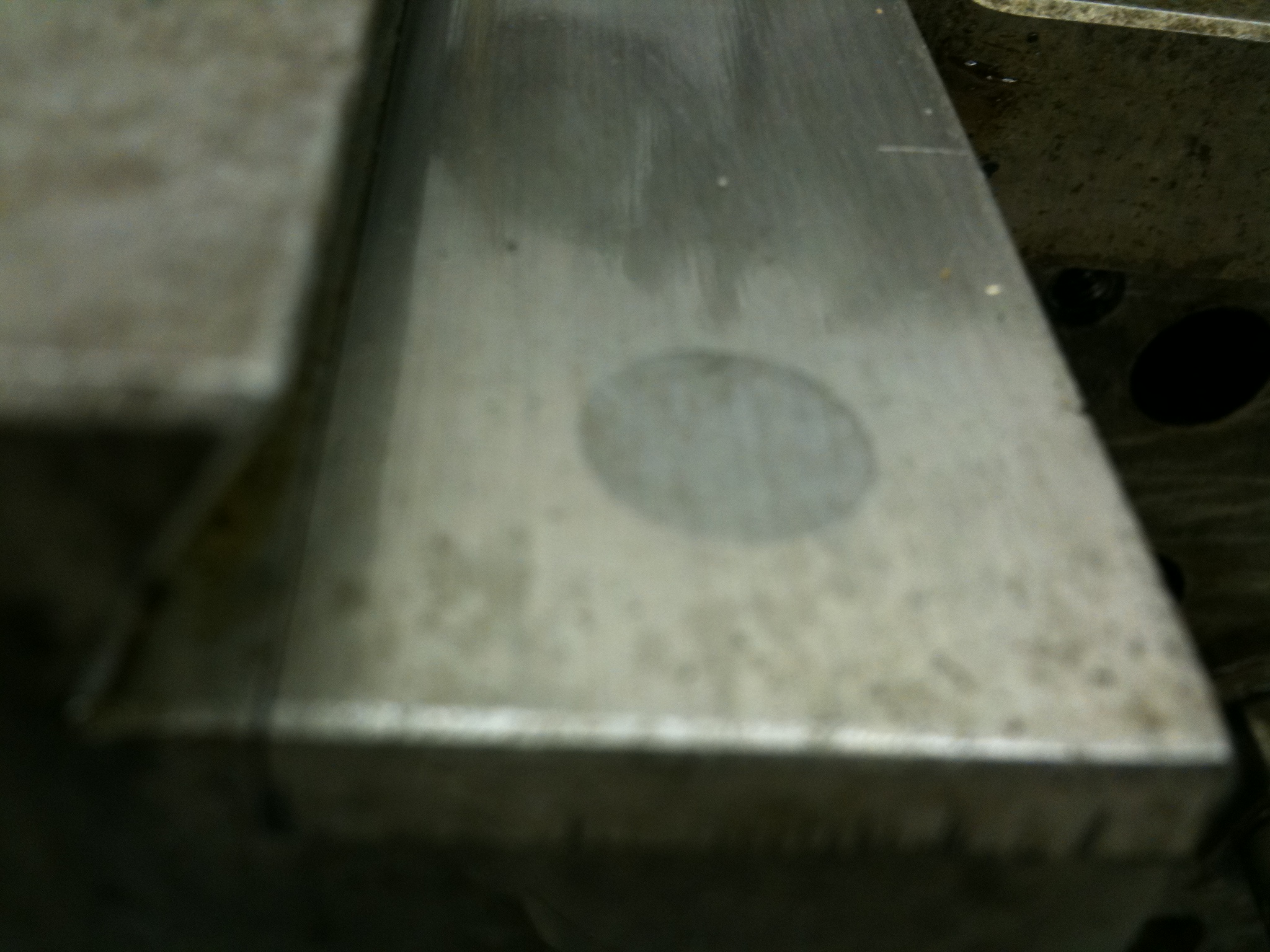

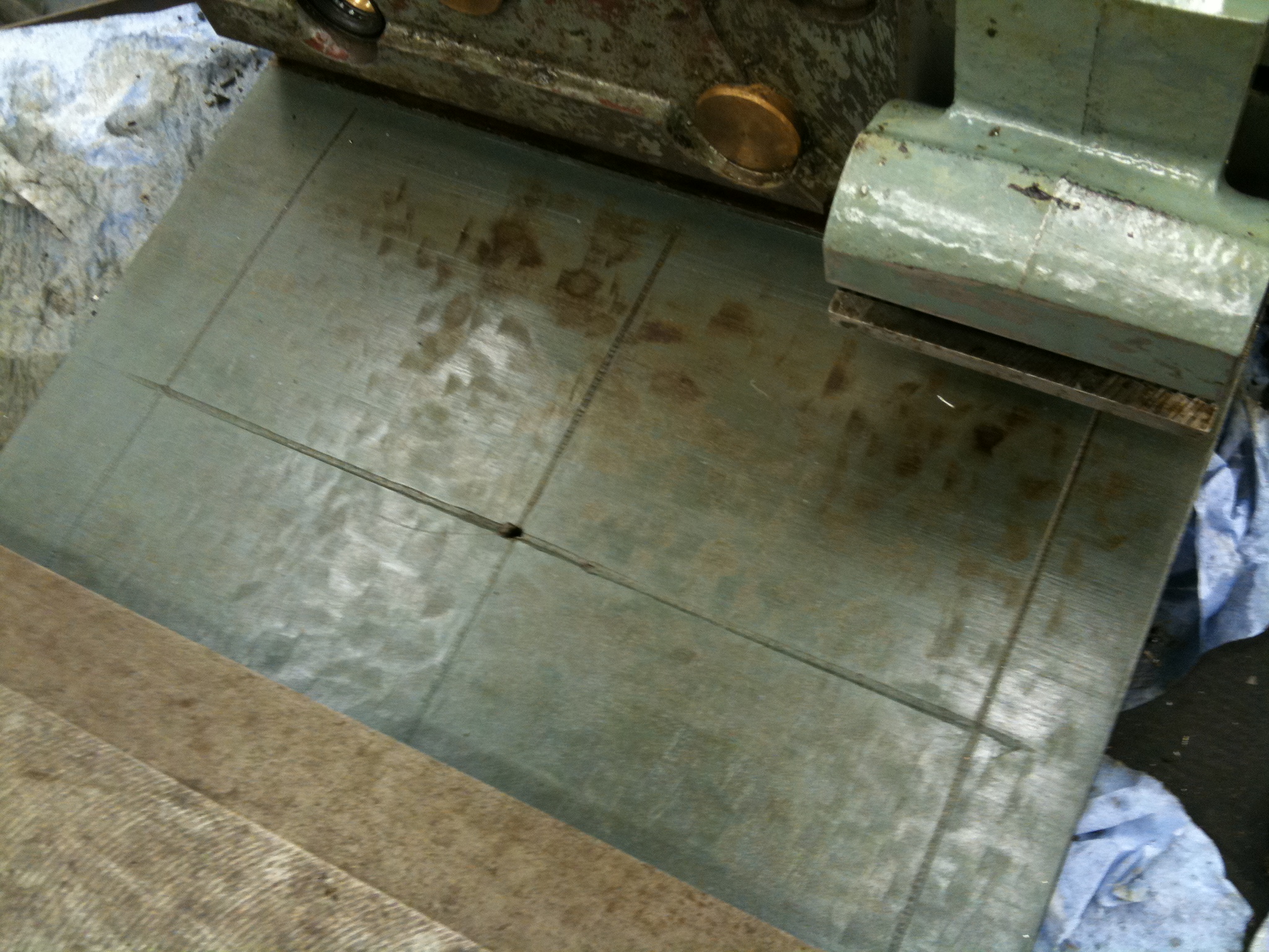

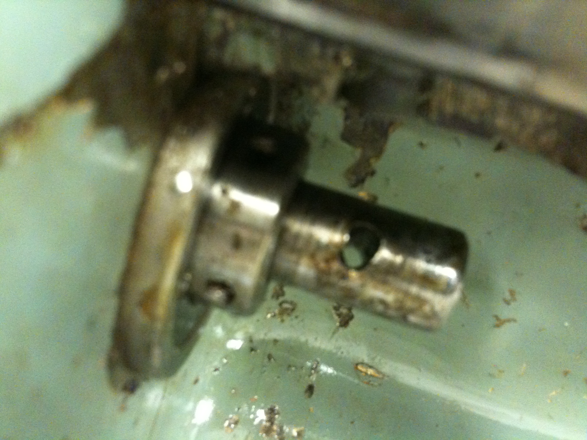

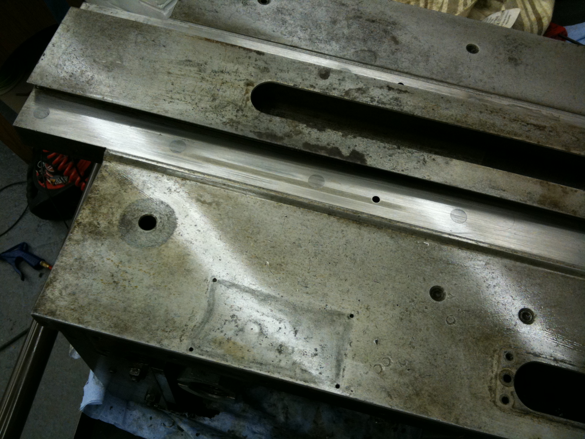

    The saddle on my machine, along with the GIB is teflon coated and this looks to be in good nick, however it looks like the cross slide have been reworked to replace the slide surface at some time. It look slike a fairly good job, unless it's supposed to be like this but I doubt it. I don't think that I'll bother with this right now. A little more disturbing is the lead screw which looks to have sheared it's taper pin at some time and has been redrilled to take a thin nut and bolt. This I will look at to maybe get back to the taper pin arrangement.
    Everything else looks fine. I would guess that the machine has been completely rebuilt at some time in the past. I'll still change all bearings that I come across as I go as these seem fairly cheap and I can get them from a local bearing supplier.

  8. So, mine has a 70 tooth major and 14 tooth minor. If anyone has a similar gear in their machine can they tell me if it's metric or imperial and I'll order it from Hardinge. It may make my Taiwanese copied crap more accurate!!!
    I always wondered if Feeler's were 'approved' Hardinge copies, I guess I have the answer now :) FWIW I understand that Feeler's are very good and very well made.
    Attached is the best picture I have of my (imperial) apron gears I count 14 on the small gear and 70 on the larger one (there's is a bit of guess work involved - so please re-count them and double check)
    That's an interesting repair job - something similar was suggested for mine by Jim Rozen over on the practical machinist site:
    http://www.practicalmachinist.com/vb...-h-174652.html with a bit of silver soldering and a spray and re-grind your gear would be probably be perfectly usable.

    I make the same count as you, 70 and 14. I had a chat with a mate who has a machine shop. He says that one off gear hobbing is pretty expensive so I guess I'll order the one from Hardinge at 210 dollars. Converting to 130 quid it seems like the simplest method right now. While I'm at it I'll get some other small bits that seem to have gone missing over time.
    I'm not really worried about the stupid comments from Hardinge. I know some guys who have had both Hardinge and Feelers at the same time and they say that the feeler compares well.
  10. Converting to 130 quid it seems like the simplest method right now
    It cost me £70 quid to have my gear sprayed and ground, so £130 doesn't too bad at all (it's a very nicely made gear ;))
    Just as a check (in case Feeler haven't copied hardinge exactly) ,it'd be worth visually comparing my gear with yours:
    http://www.mycncuk.com/forums/attach...1&d=1234469223
    http://www.mycncuk.com/forums/attach...6&d=1236984035
    The large bearing is 3/4" ID and just under an inch OD (presumably for a press fit)
    According to my parts list the hardinge bearing part number is now FLH1481 (Replacing 6700) . I found an equivalent double seal needle roller at Simply Bearings but chose to make a bronze bush instead.
    I can't remember the sizes of the small end (I'd guess 7/8"). Hardinge part is LH4144-1
    The gear itself is FLH1402 (from mid '71 onwards)
