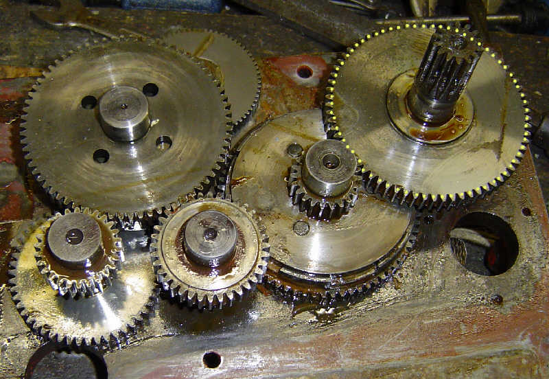

    Attached is the best picture I have of my (imperial) apron gears I count 14 on the small gear and 70 on the larger one (there's is a bit of guess work involved - so please re-count them and double check)

    [edit3] Thinking about it, your lathe will be imperial i.e. 8tpi lead-screw, 10tpi dials because the dials and gearbox convert english to metric not vice versa. Only an all metric machine would have metric threads and a different carriage gear :)

    I make the same count as you, 70 and 14. I had a chat with a mate who has a machine shop. He says that one off gear hobbing is pretty expensive so I guess I'll order the one from Hardinge at 210 dollars. Converting to 130 quid it seems like the simplest method right now. While I'm at it I'll get some other small bits that seem to have gone missing over time.

    It cost me £70 quid to have my gear sprayed and ground, so £130 doesn't too bad at all (it's a very nicely made gear ;))
    Just as a check (in case Feeler haven't copied hardinge exactly) ,it'd be worth visually comparing my gear with yours:

    The large bearing is 3/4" ID and just under an inch OD (presumably for a press fit)
    According to my parts list the hardinge bearing part number is now FLH1481 (Replacing 6700) . I found an equivalent double seal needle roller at Simply Bearings but chose to make a bronze bush instead.
    I can't remember the sizes of the small end (I'd guess 7/8"). Hardinge part is LH4144-1
    The gear itself is FLH1402 (from mid '71 onwards)
