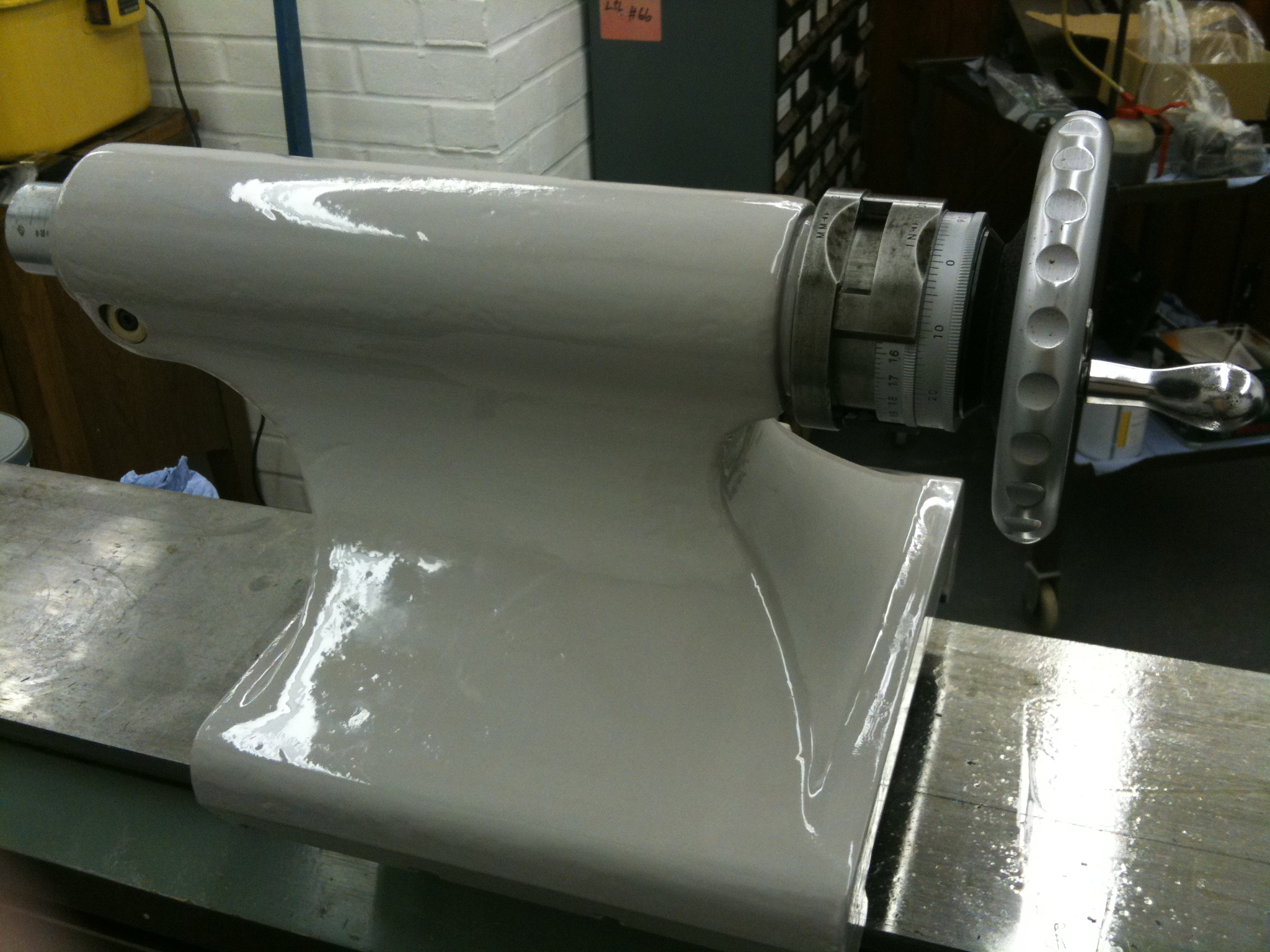

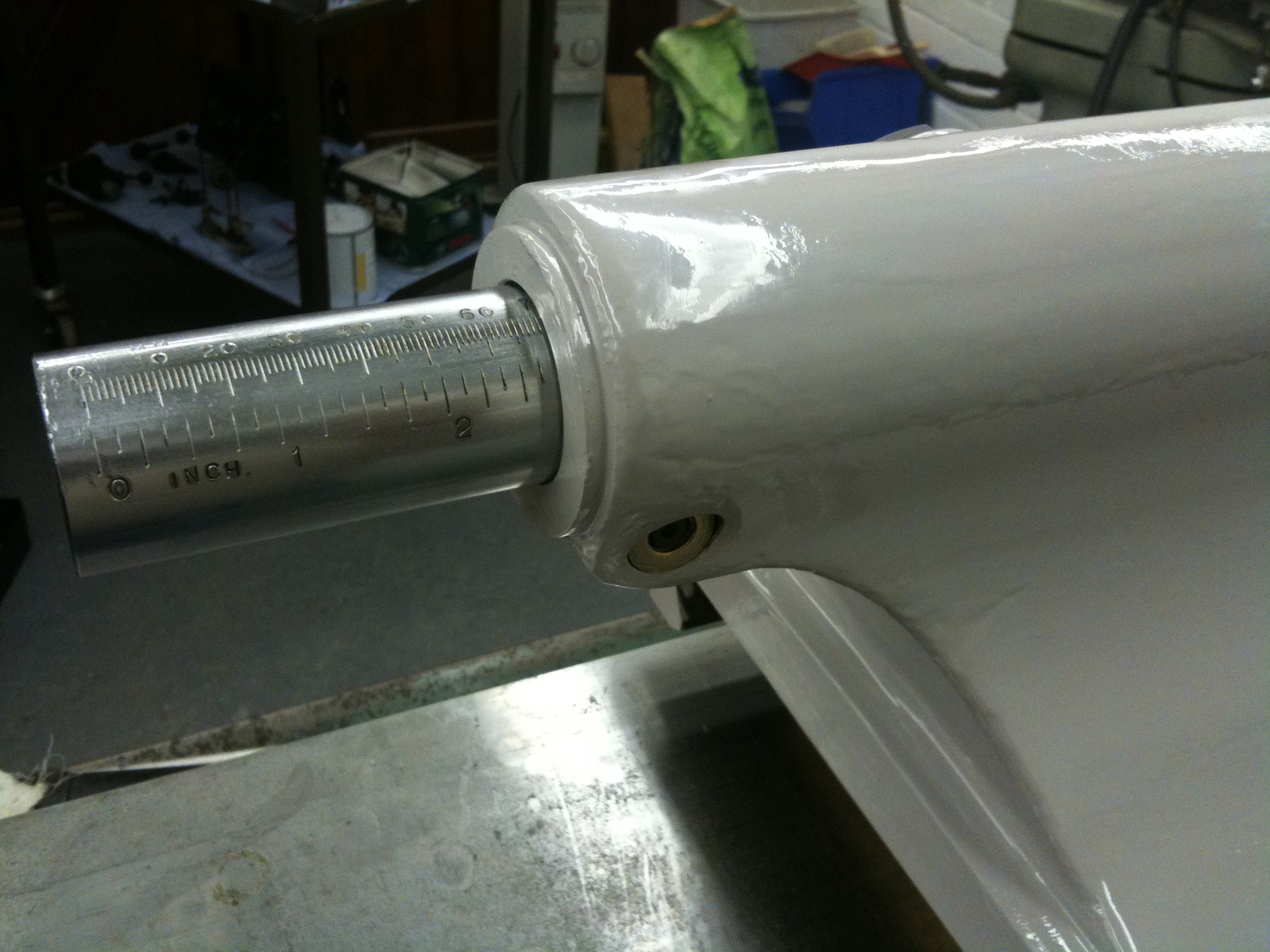

Thanks Bill,
That was fairly easy; I had a couple of goes at tapping all around and then it just pulled off as easy as that.
