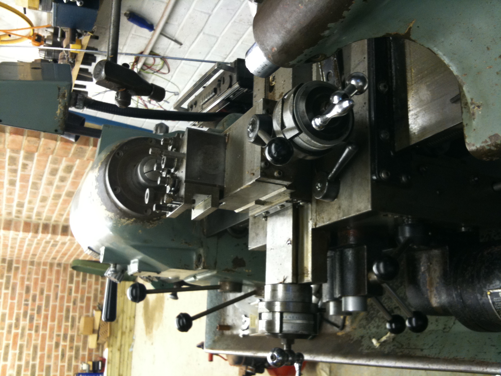

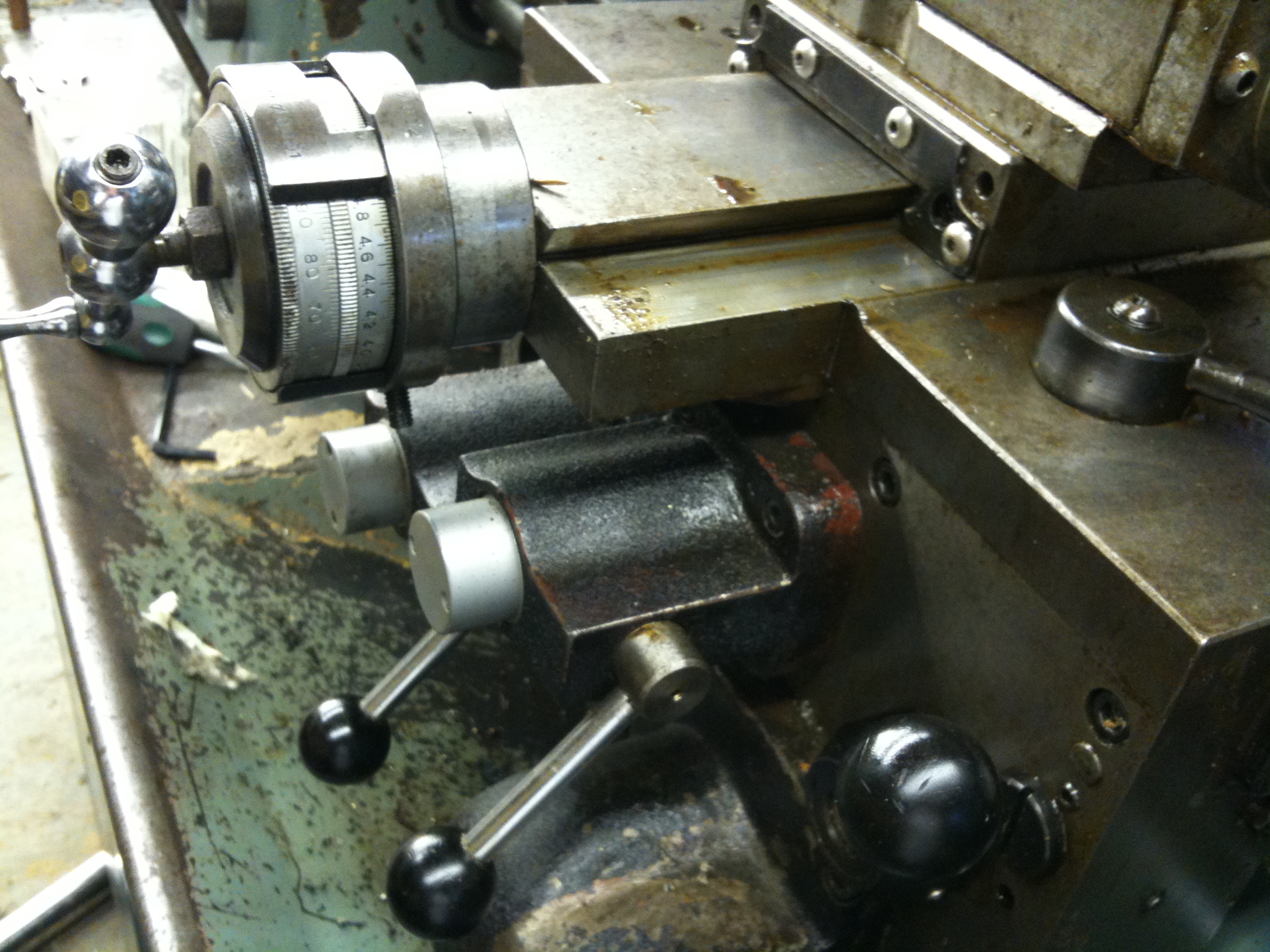

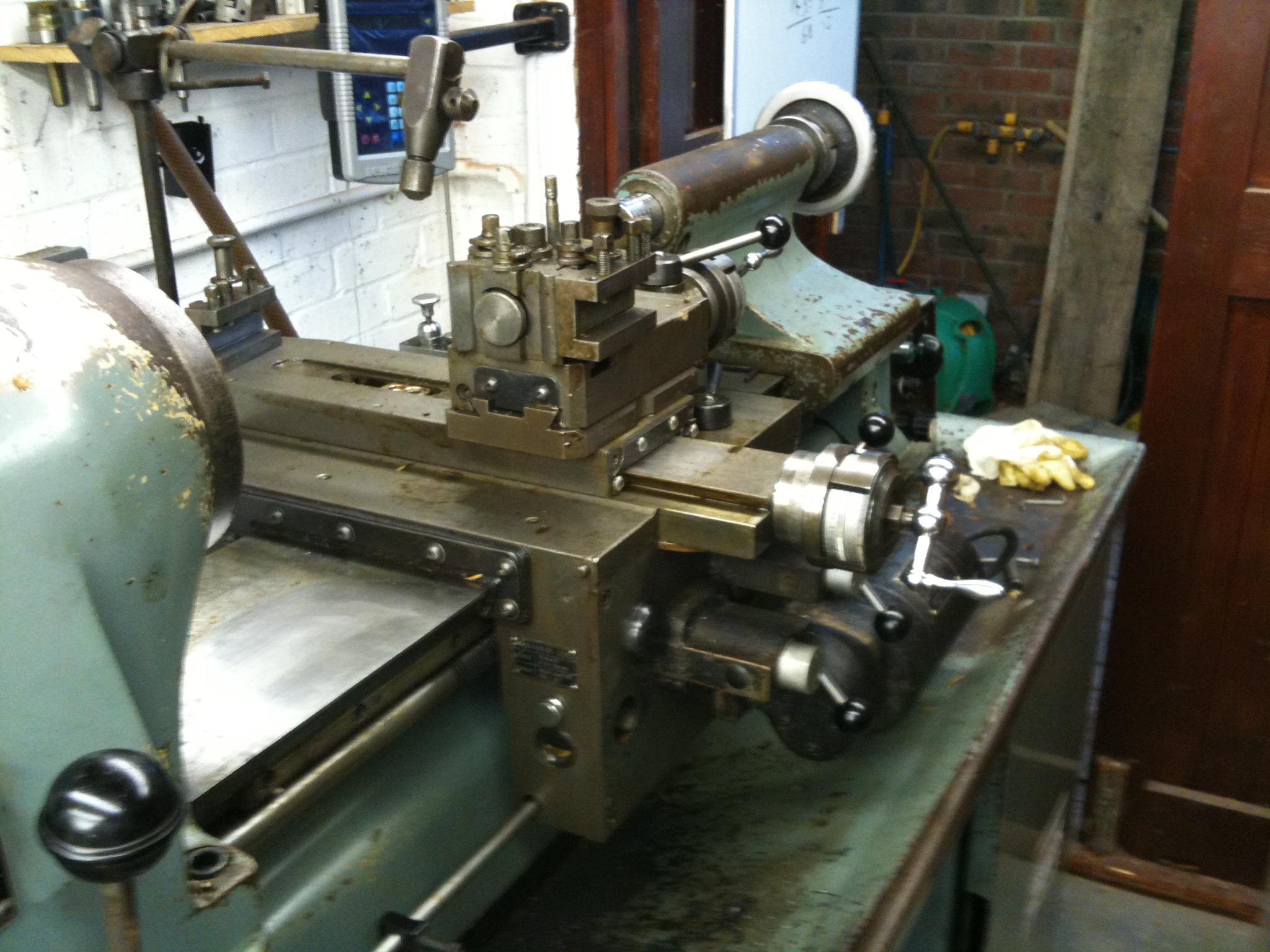

    OK, I've got my lathe. I had hoped that it would be a worker when it arrived but I was a bit disappointed as the carriage assembly was hanging out and the whole thing was covered in thick sticky crap. I have now stripped down the carriage assmbly, cleaned and repainted and there is no wear whatsoever. Feeling a bit better about it.
    The lathe is a dual imperial metric gearbox and feeds with lubrication.

  2. It looks in generally good order :)
    Feeler seems to have copied the Hardinge exactly, so it might be worth checking for wear in the carriage drive gear (a HLV weak spot).
    If you don't know already, the apron gearbox uses automatic transmission fluid (e.g. TQF) and Mobil Vactra in the Carriage oiler reservoir.
    Very envious of the english/metric gearbox (BTW are those change gear necessary?)
    Thanks for the advice on the oil Bill, I was going to use the gearbox oil for my Myford. I've now ordered an Hardinge maintenence manual, so maybe I'll not screw up in future.

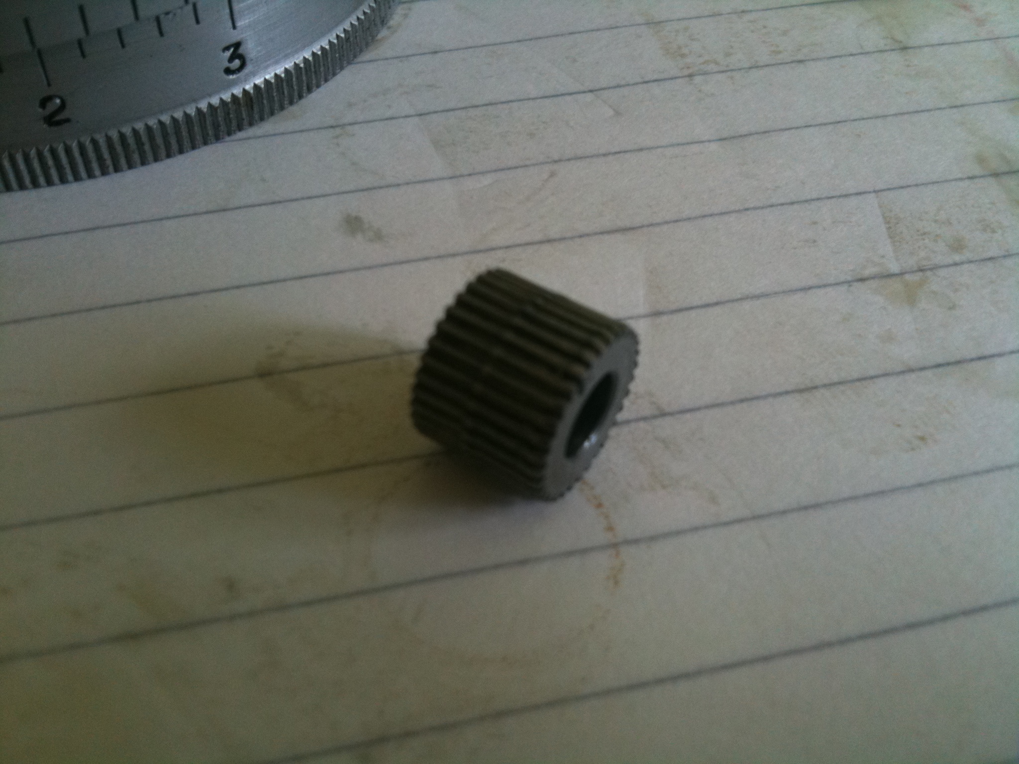

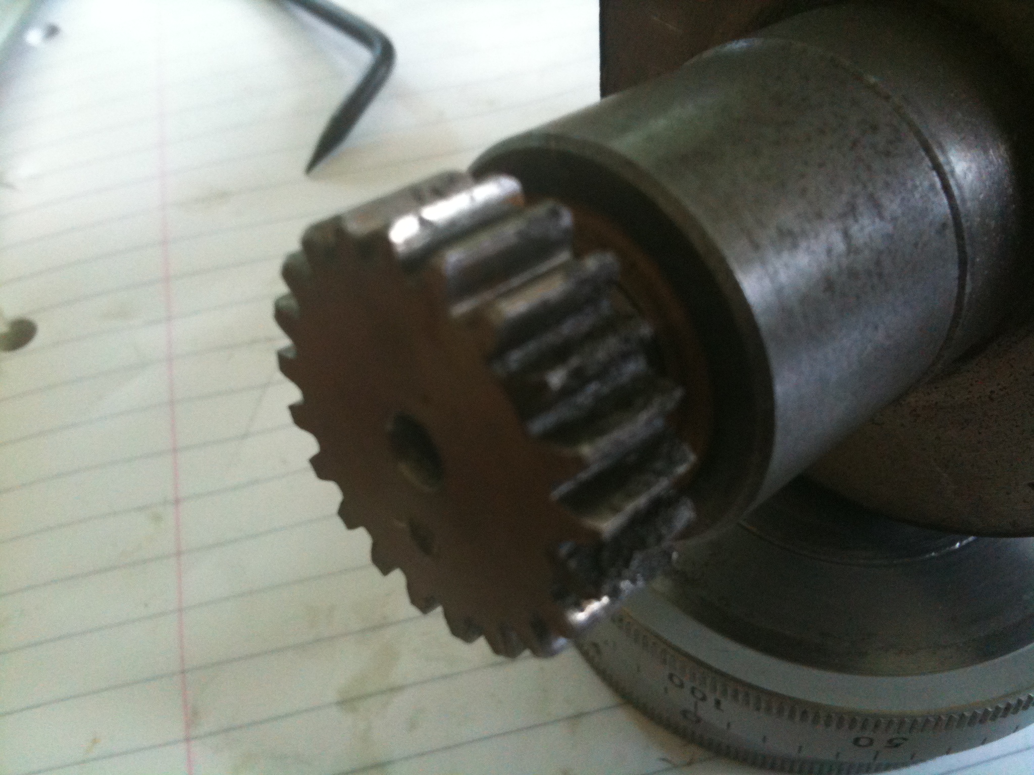

    I have now stripped down and cleaned the carriage wheel assembly and it shows some wear as you suggested. It looks like some cutting fluid ingress has caused some rot on the drive gear (see thumbnail).

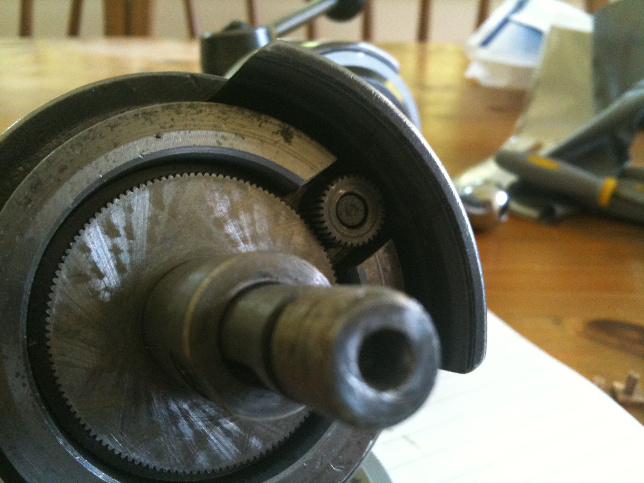

    Also, the dual dial models have an idler gear which causes the dials to move at different speeds when selecting imperial or metric (see thumbnail). The pin and idler are very worn on the carriage feed but are near mint on the top slide as you would expect. I don.t know if this is the same in the HLV. Anyway, any idea where I can get spares for these things, as whilst I'm at it I may as well change the pin and idler in all of the feeds. If I can I'll also change the carriage drive gear.

  4. The carriage handle gear has taken a bit of a pounding (water/coolant ingress into the apron?) but it's relatively unimportant to the finish you'll get, so don't worry too much. It the gear that that gear drives (IYSWIM), the carriage drive gear, that suffers bearing failure in the Hardinge.
    It might be an idea to crack open the apron just to check there's nothing untoward inside. It's not difficult to strip down.
    Mine's imperial only it doesn't that the dual scales. You might try ringing ZMT (don't bother emailing they "don't have email in the workshop") but HLV-EMs are like hen's teeth, so you may have to make do and mend. I.e. make a new pin and fit a bronze sleeve into the idler gear.
    Not much use rebushing the idler gear, it's well worn (no teeth left), fortunately it's not hardenned so the drive gear is fine. However, I've checked out the Hardinge US site and they have full parts lists for the HLV models including the HLV/EM. As the feeler looks like a pretyy exact copy I'm going to order the idler gears and pins direct from Hardinge. Hardinge UK tell me they do spares for the HLV so maybe I'll strike lucky and not have to order from the US.
    You can find the full Hardinge Parts Lists at the follwong URL: http://www.shophardinge.com/partslist.aspx
    I think, following Tom's advice. I'll strip down the entire saddle and replace any worn parts whilst I'm at it. There's a pretty good bearing place close to me and I should be able to get all the bearings over the counter. Looking at the parts list, I'm surprised how many bits there are. My previous experience is on a Myford Super 7B so I'm really looking forward to much more accuracy and better finish when this is done.
