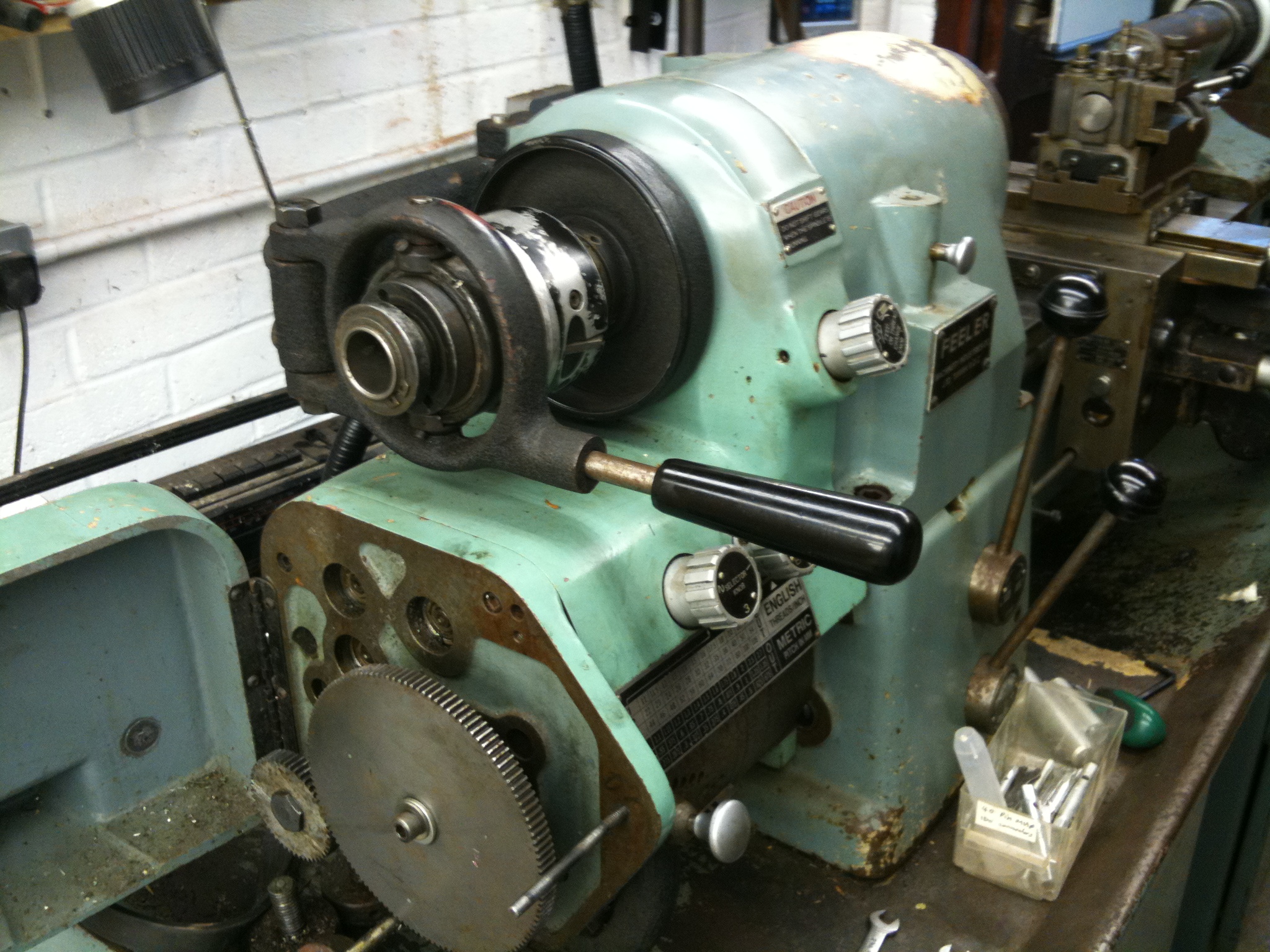

    OK, I've got my lathe. I had hoped that it would be a worker when it arrived but I was a bit disappointed as the carriage assembly was hanging out and the whole thing was covered in thick sticky crap. I have now stripped down the carriage assmbly, cleaned and repainted and there is no wear whatsoever. Feeling a bit better about it.
    The lathe is a dual imperial metric gearbox and feeds with lubrication.

  2. It looks in generally good order :)
    Feeler seems to have copied the Hardinge exactly, so it might be worth checking for wear in the carriage drive gear (a HLV weak spot).
    If you don't know already, the apron gearbox uses automatic transmission fluid (e.g. TQF) and Mobil Vactra in the Carriage oiler reservoir.
    Very envious of the english/metric gearbox (BTW are those change gear necessary?)
