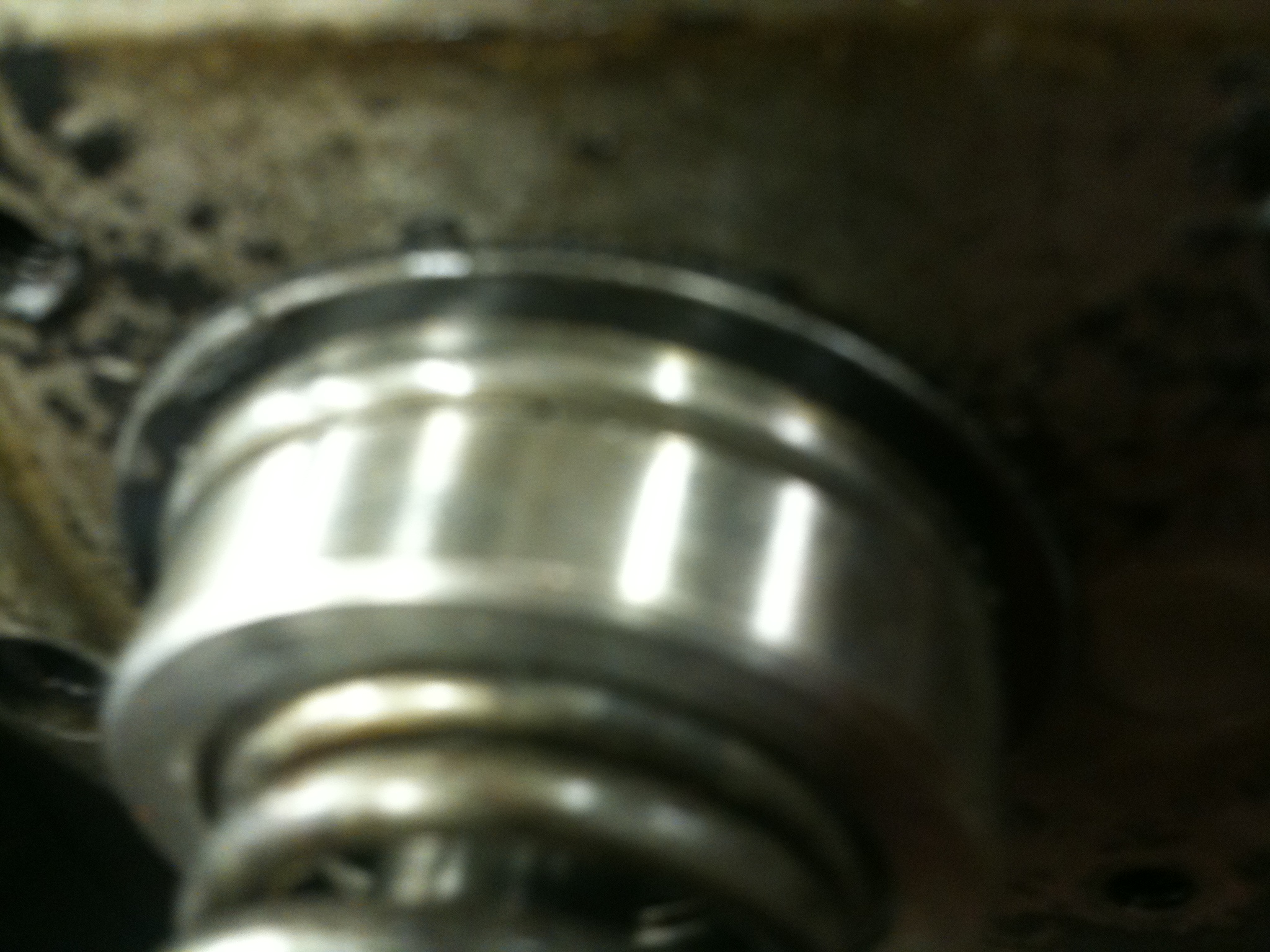

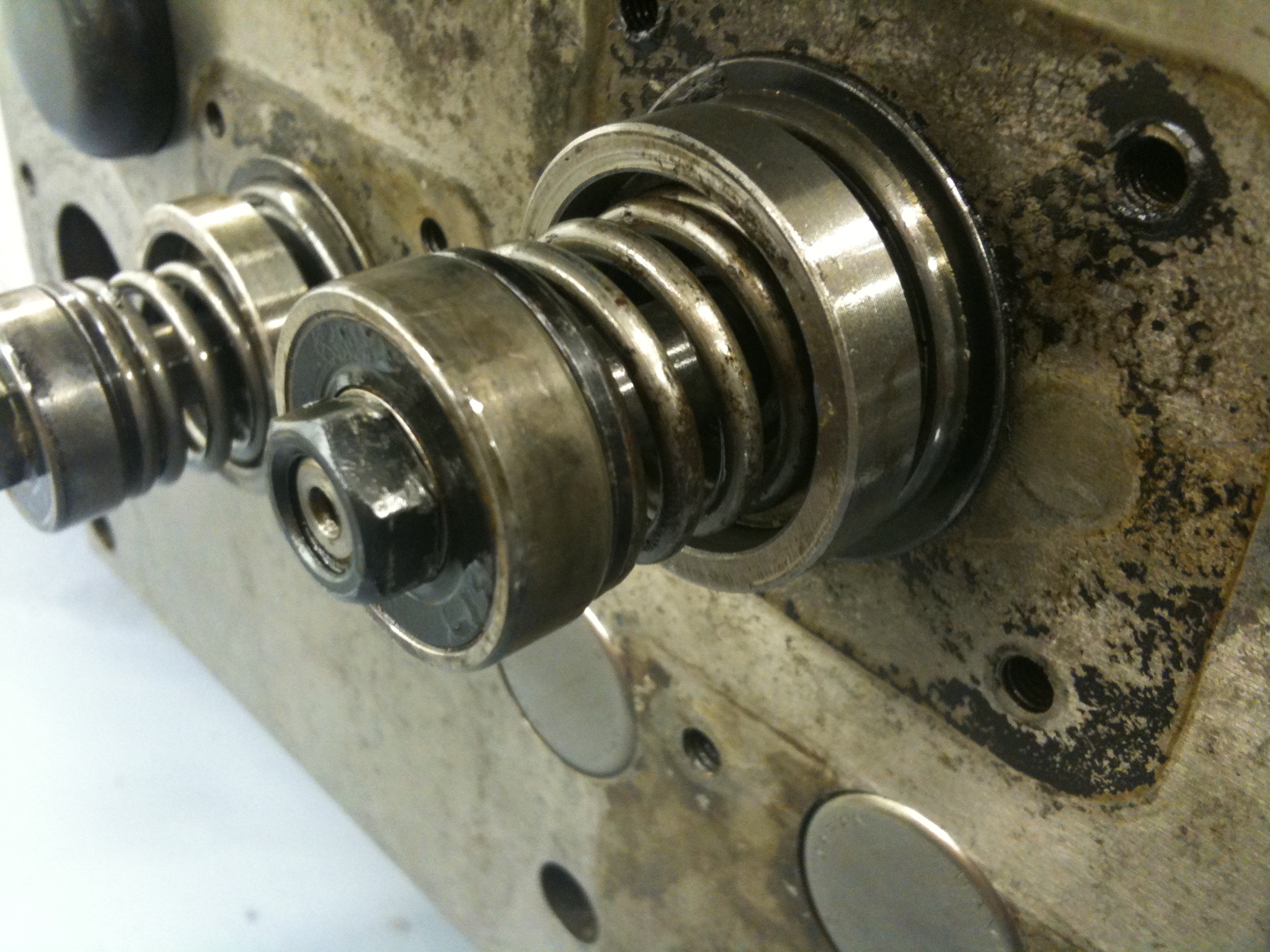

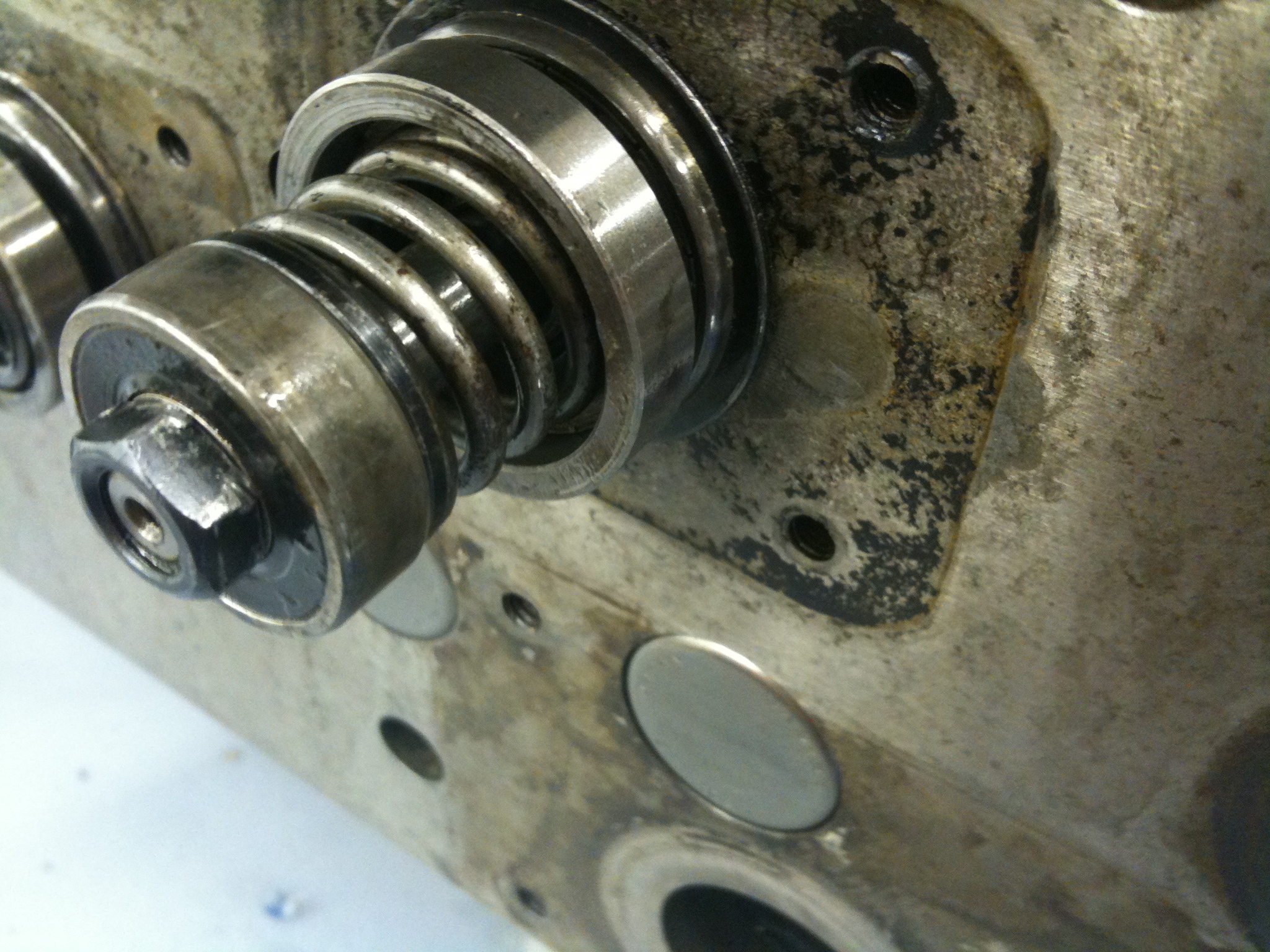

    Well, I've now stripped the clutch covers and levers, cleaned and re-assebled them. I've come to fit them to the clutches and guess what! I've assmebled the clutches incorrectly. This don't seem a problem except that the saddle gear cover plate has been assembled using gasket sealer and refuses to come off. If you look at the thumb nails you can see that the spring mount is upside down creating a 4mm gap between the bearing and the spring mount. Watch out for this if you strip the clutches. One of the thumb nails is buggered but I can't work out how to remove it. David Bailey wasn't around today.

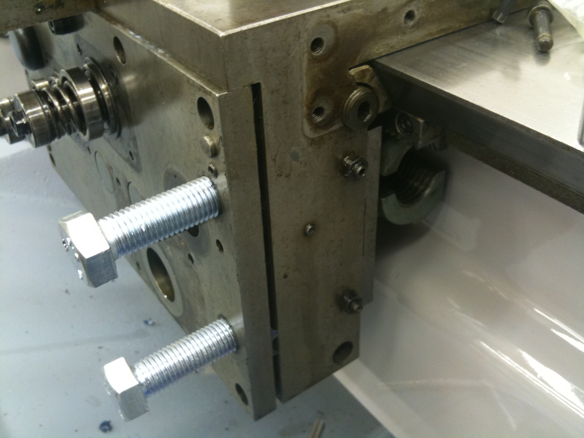

    After a lot of banging and pulling as described in the manual I gave up and looked for another method. There are two plugs to the right of the cover plate, which allows access to the half nut adjusters. Removing these allows 16mm bolts to be located and used to push the cover plate away from the saddle. This creates a gap large enough to slide in a thin knife which can be pushed around the edge releasing the cover plate. See the thumb nail. This actually worked easier than the method described in the manual and I would recommend it to anyone removing the cover on their Hardinge or Feeler.
