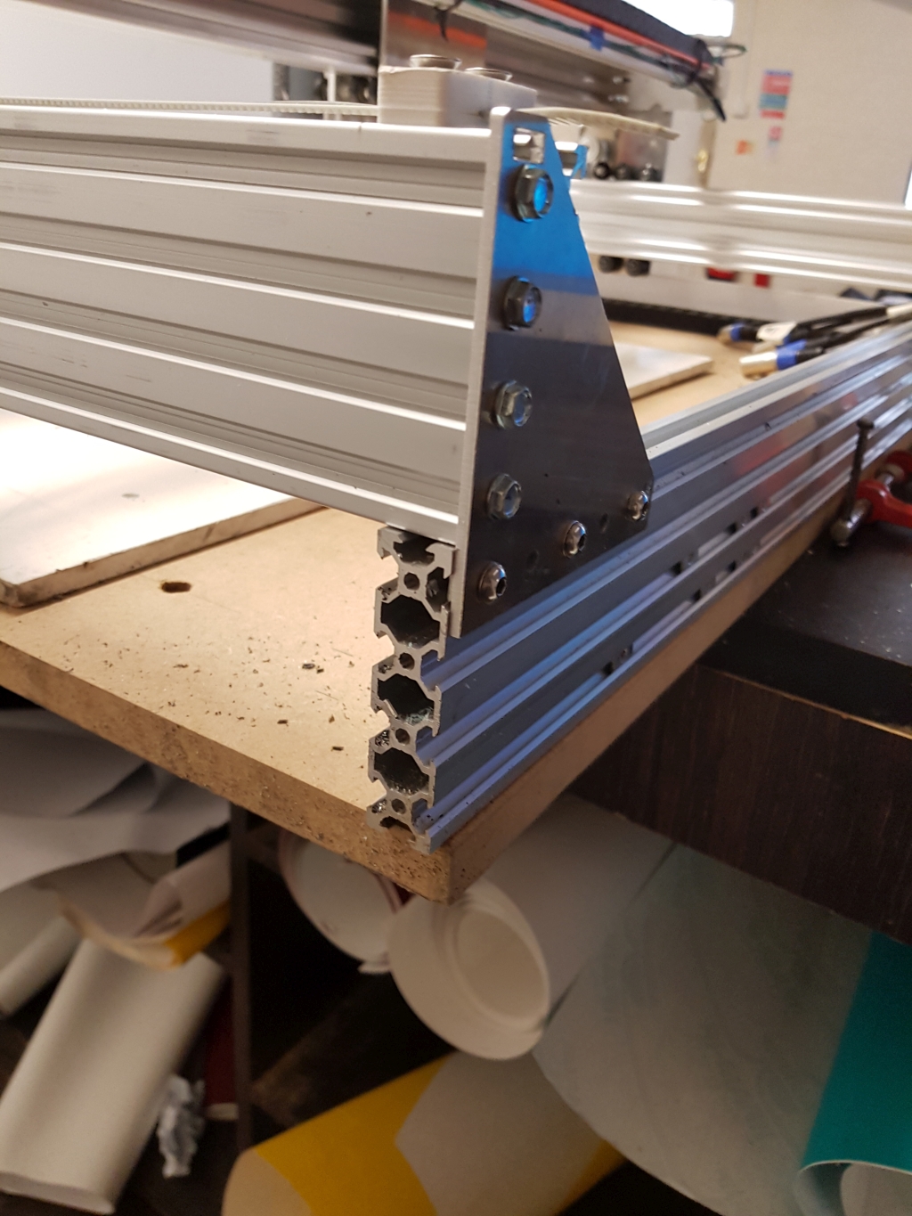

    I noticed my machine had extrusions which where double mounted to make them far taller than needs be.
    So today i have taken the extensions off, leaving me with a frame i cant attach to the MDF board.
    I presume Sliding nuts / t slots would be fine if i made approximately 5 holes on either side of the 1 meter x 1 meter board?
    So having looked at the various types of nuts, i cant seem to work out the extrusion type/series.
    The rails i have are 20mm x 80mm.
    How can you tell the major differences1?

    Sorry crystal ball is still broke. How about some pics.

    Yeah that would have been good lol.

    Any ideas? Also, right now the bottom frame is mounted on MDF. I want to swap this to at least aluminium or steel struts, how would I go about doing that?

    Think its v-slot linear rail
    See http://ooznest.co.uk/Linear-Rails
    They have all sorts of brackets & fixings, hopefully there should be some of use
