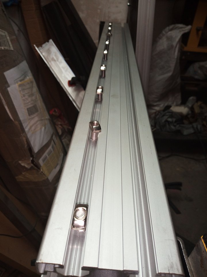

  5. #105

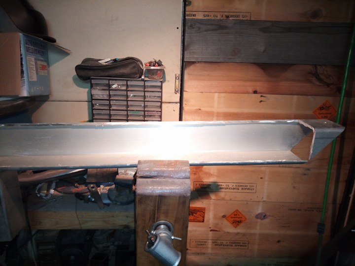

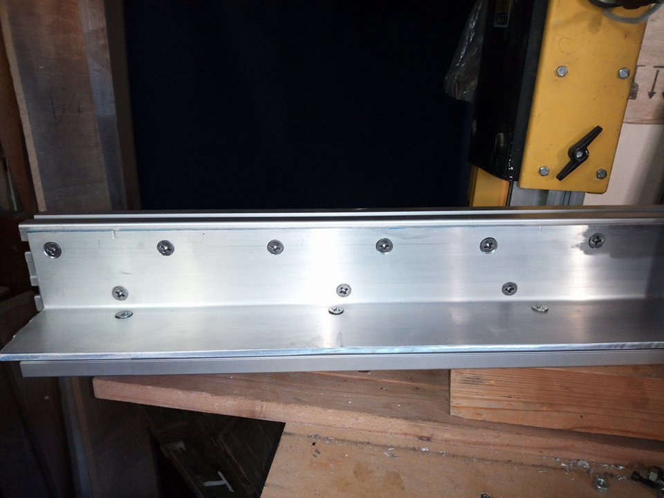

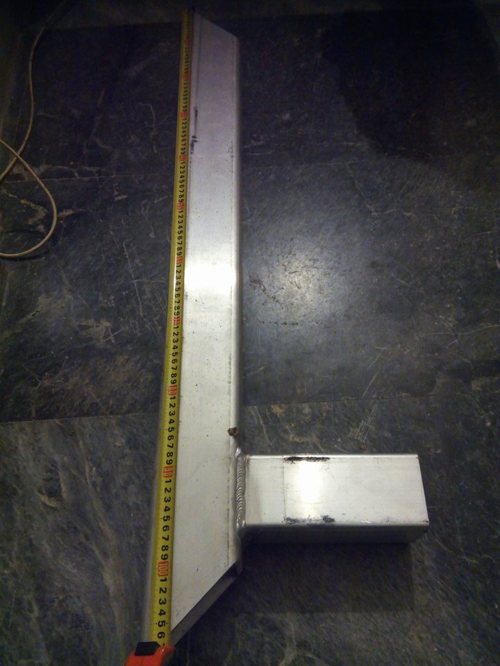

    I made some progress today.

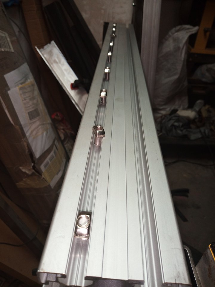

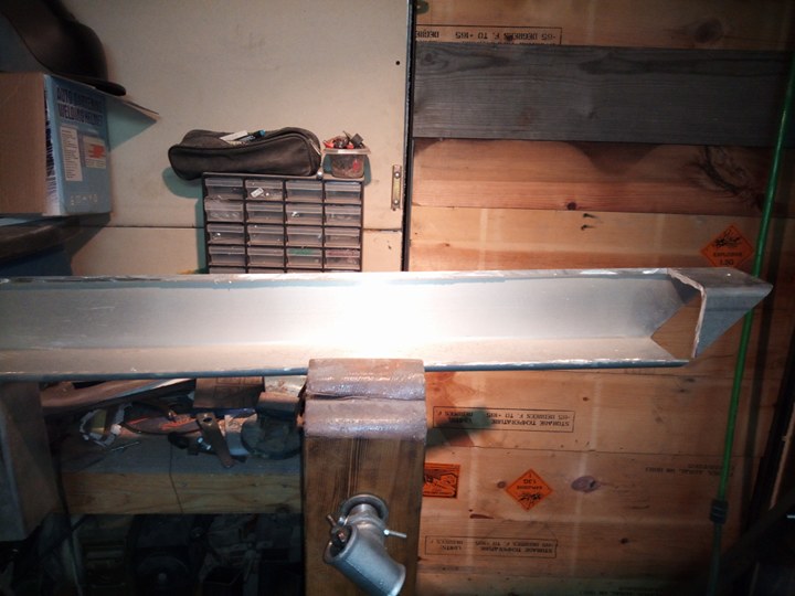

    Cut one of the aluminium beams I have and use the piece to add stiffness to the L beam.

  7. #106

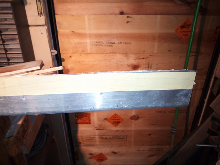

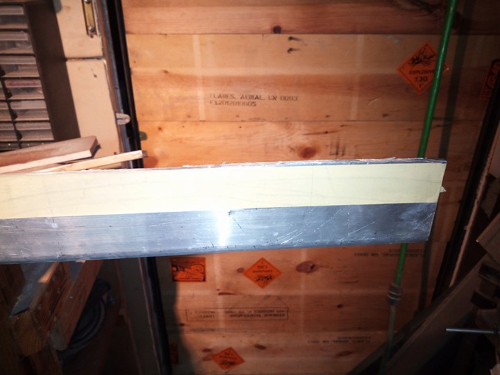

    I made a pass from the table router and cut the aluminium angle straight , something that wasn't possible with the cutting grinder.
    Aluminium angle is 5mm thick, I believe it is going to add something to the construction,I hope stiffness and not only weight!lol!!!

  11. #108

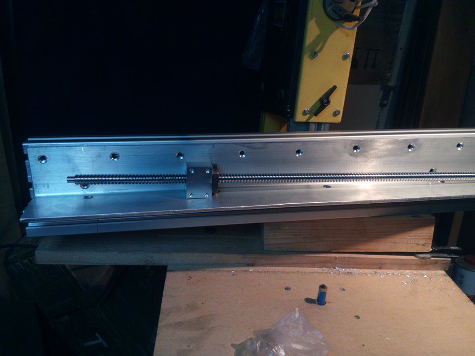

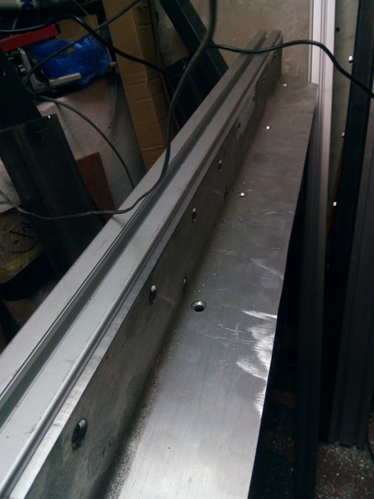

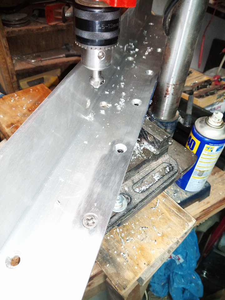

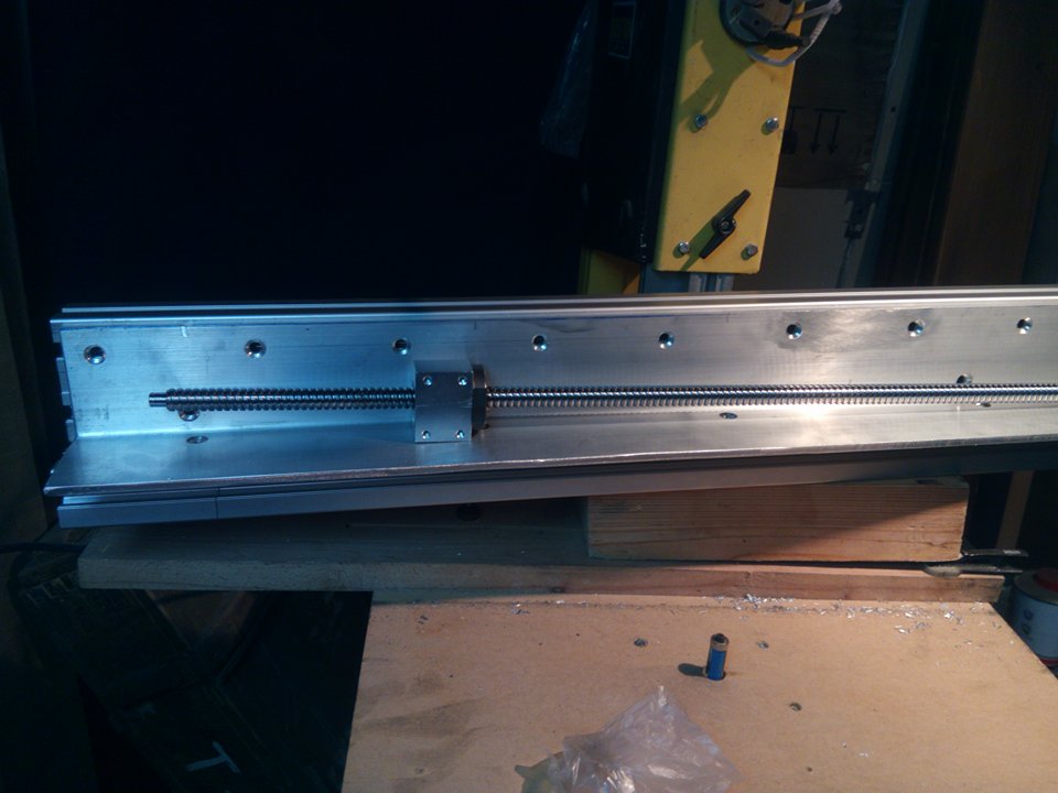

    I use the end mill chamfering with sunk to prepare the holes,then screw the aluminium angle in place, the axis weight now 8.7 kilos.
    I am planing to use Nema 23 4NM,any thoughts?
  12. #109
    Good progress Nick!
    You dont have to worry about the weight.. will be fine!
    How do you plan on fastening the bearings?
    Will you use the T slots or drill and tap the angle that you made?
  13. The Following User Says Thank You to Nr1madman For This Useful Post:
  14. #110
    Good progress Nick!
    Hi Robert.
    I am planning to drill and tap ,the aluminum angle is 5.5 mm thick and made from hard aluminium,if that option fail I am going to use the T nuts.
    I wish a Happy New Year for you and your family!
    Happy New Year to all members of this forum!!
