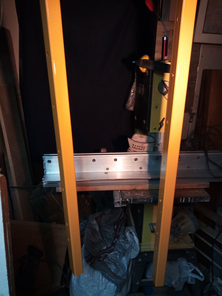

    We expect some visitors in about one hour but I manage to paint the CNC bench today black and the sides where the Y axis extrusions are going to rest... yellow.

    I am planning to drill and tap ,the aluminum angle is 5.5 mm thick and made from hard aluminium,if that option fail I am going to use the T nuts.
    Looking sweet! Yellow and black go good together :D
  5. #114
    Yellow and black is a cool commination and maches with my bandsaw and thickness planer I have .lol!
    Also those are the colors of the football team my son support, the colors i choose is a surprise for him!

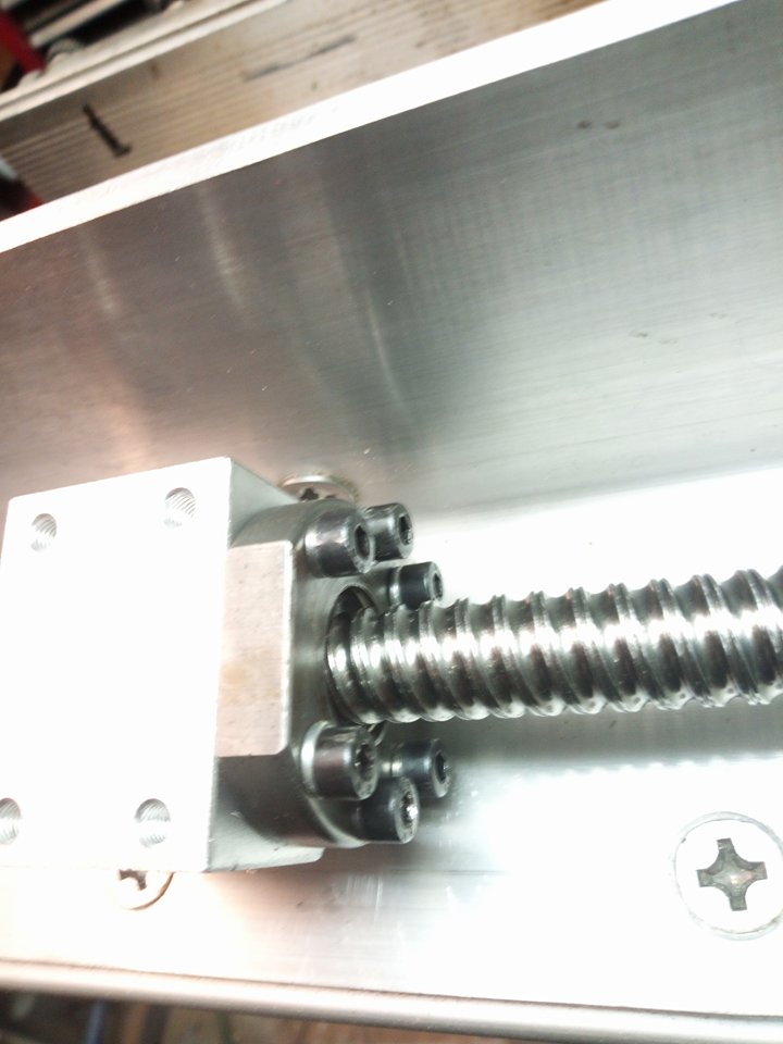

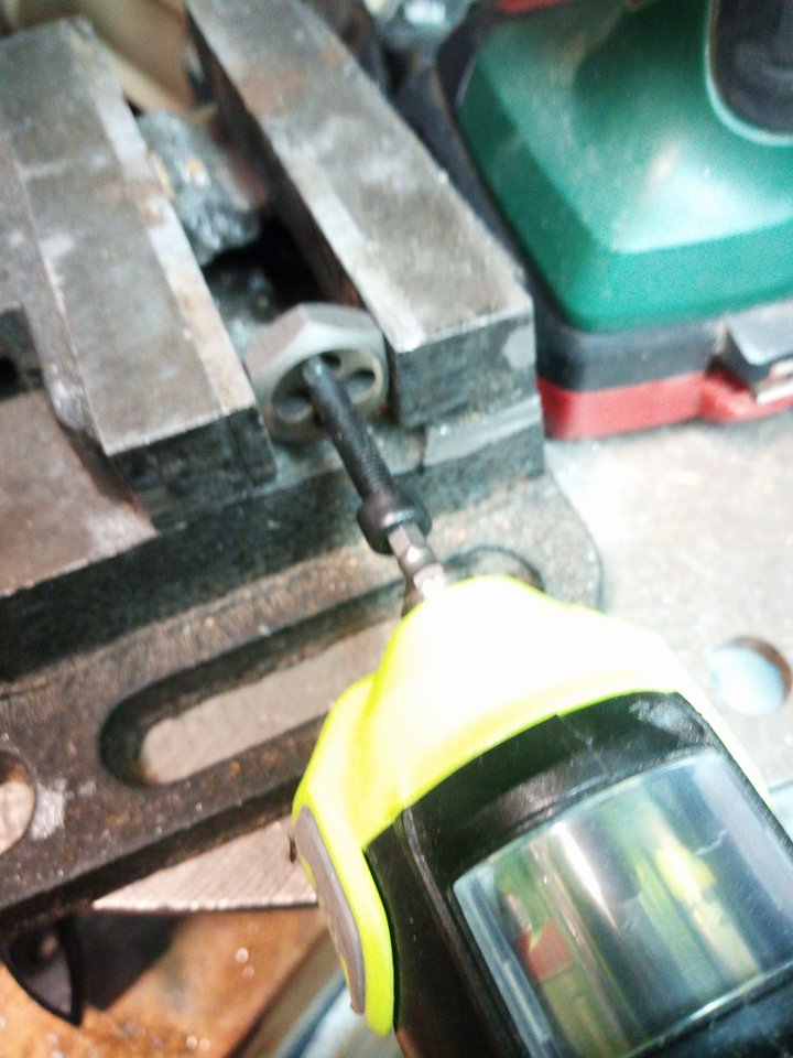

    When you measure the depth of nut housing bracket for ordering your screws, remember that the tapering stops 3 to 4 mm before the maximum depth.
    I realize that a little bit late but the fix was easy...
