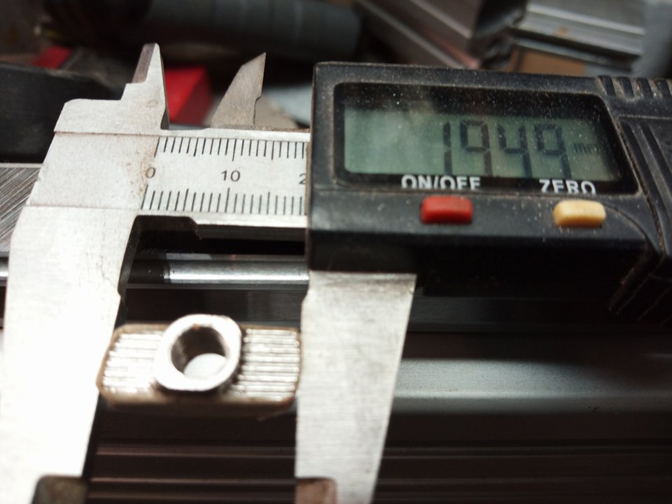

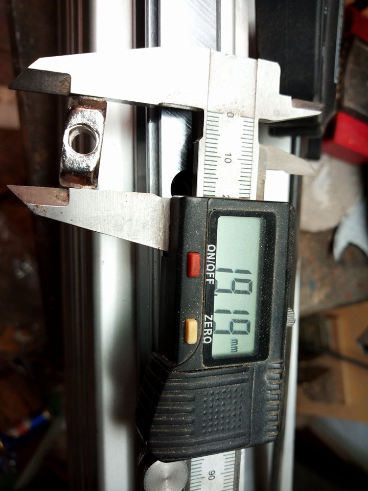

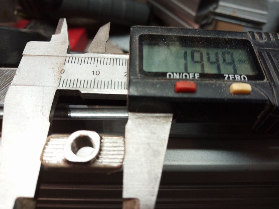

    I've been waiting for 42 days for the T slot nuts to come from China and finally come and with them the frustrating reality!
    Nuts was shorter by .20 and this make them turn and not lock in the aluminium slot!
    I cover the T nuts with self adhesive tape and solve the problem, this took me one day to think it since my nerves was not in good condition,as I was keep thinking that if I make a new order, it will take another 40 days to arrive!

    Good to hear you solved the problem!
    Its frustrating when you get parts that dont follow the specs ;)
