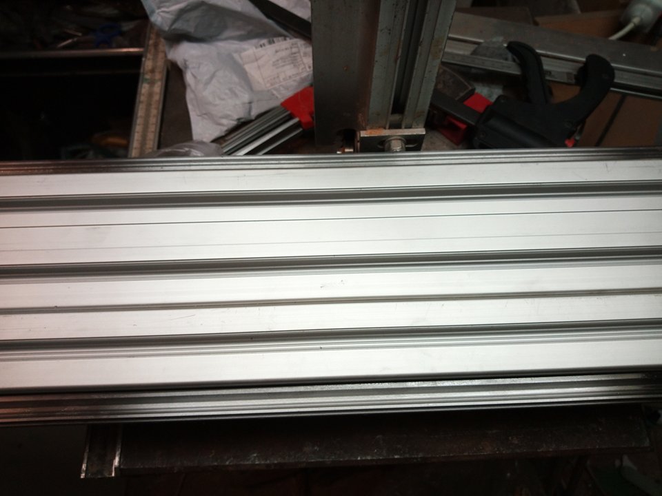

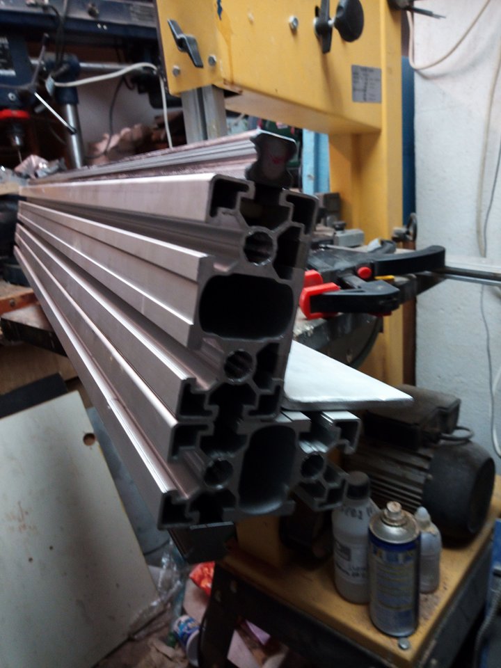

    Put the rails on the aluminium extrusions and run the caliper.

    I'm going to glue 2 T nuts together so they can't twist in the slot for my clamps to make it easier to release, move and retighten.
    Is that M6 thread with a 10mm slot?
    Smart stuff ;)
    Or you can just buy the longer ones?
    They cant be "dropped down" but thats true if you glue two aswell
    Those are M6 with 8mm slot, they was suppose to be 19.5mm but actually they are 19.28mm.

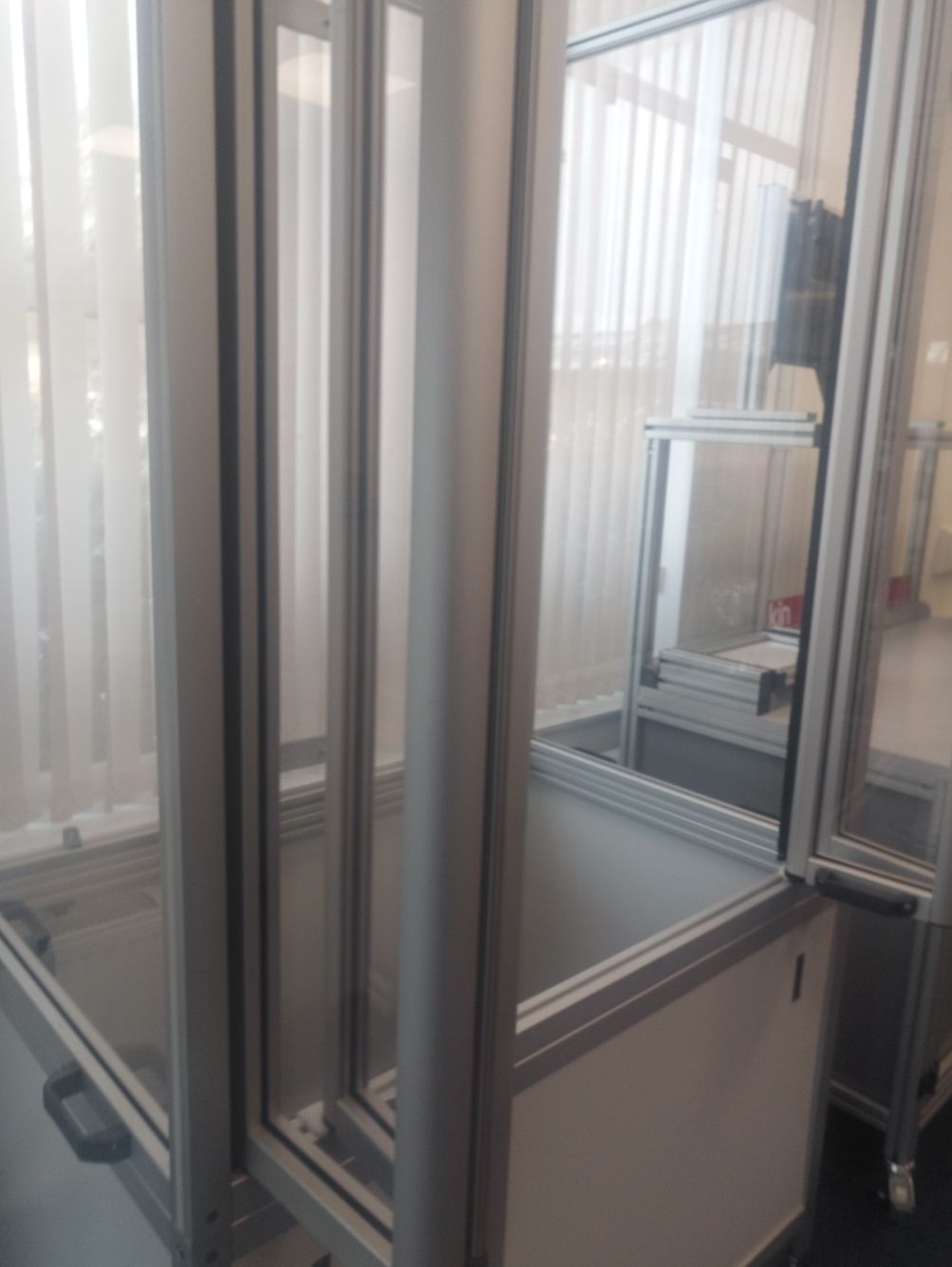

    If you have a router table make them yourself that's my plan if I ever need to mount hiwin's again with extrusion.
    But if you need more I can get them from KJN and post them to you for cost I'm 3 miles (4km) away from them and need to go for more T nuts this week for my clamps so it;s no hassle.
    They're £4 for 10 I needed 100 for my hiwin's so I bitterly know this lol.
    Took this in their entrance, this would cost stupid money lol. Extrusion is not cheap.
