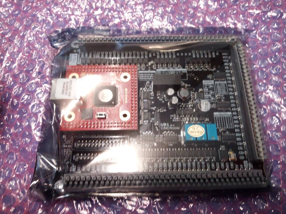

    The mail man drop a package this Tuesday !

    Hi Nick,
    You just made me regret not buying a UB1.
    Keep up the good work!
    Grtz. Bert.

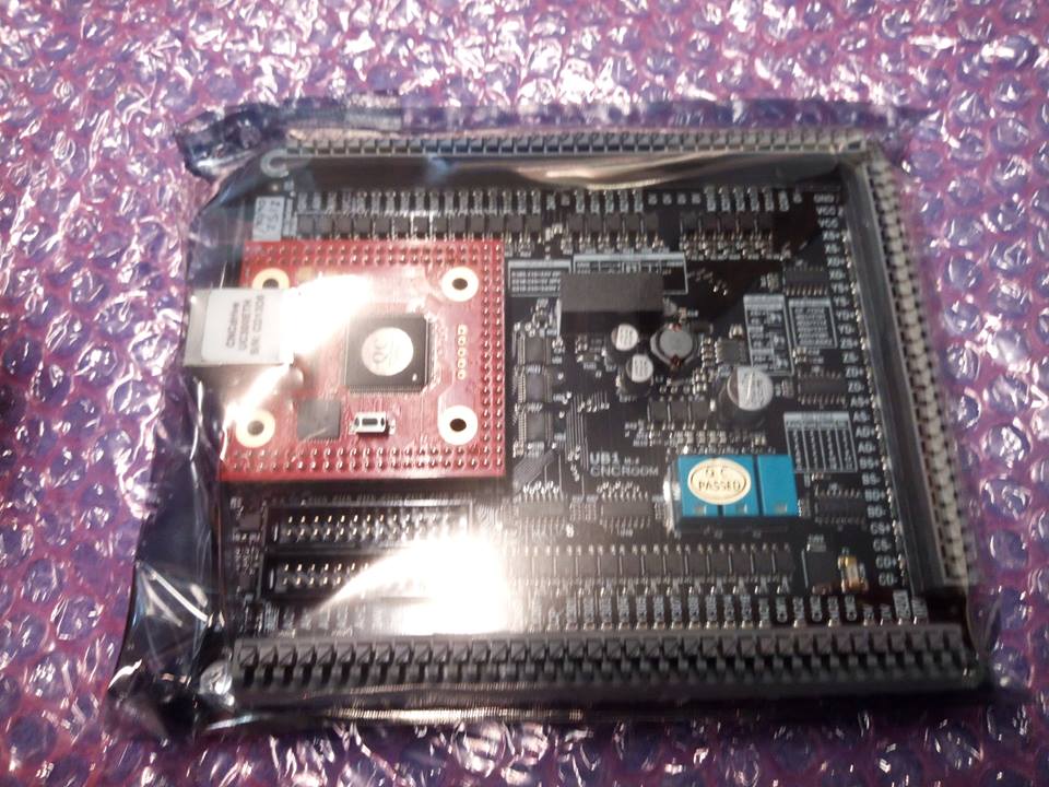

    Wooohooo :D
    Nice!
    Also good to see progress. I like the motormount, how did you cut it ? :)
    About the circuit diagram.. do you want minimal but good or somewhat more elaborate?
