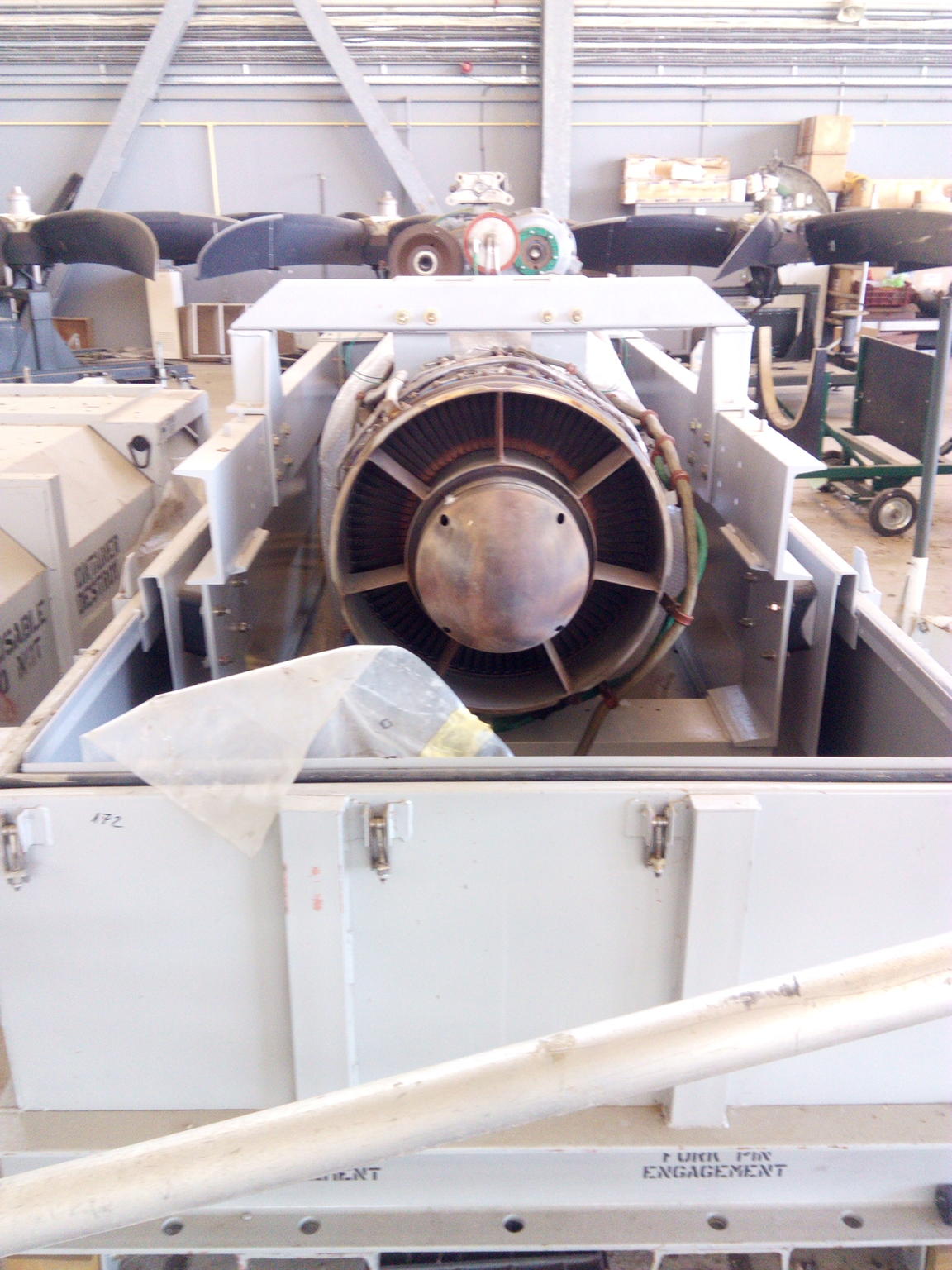

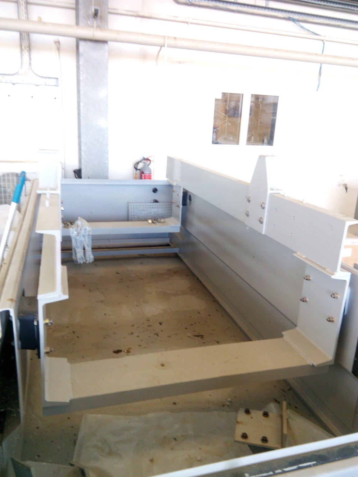

    Yesterday at work I felt very lucky, since I thought I found my machin ,almost ready ,build for me!!!
    But unfortunattely someone place an engine on and I lost my chance.

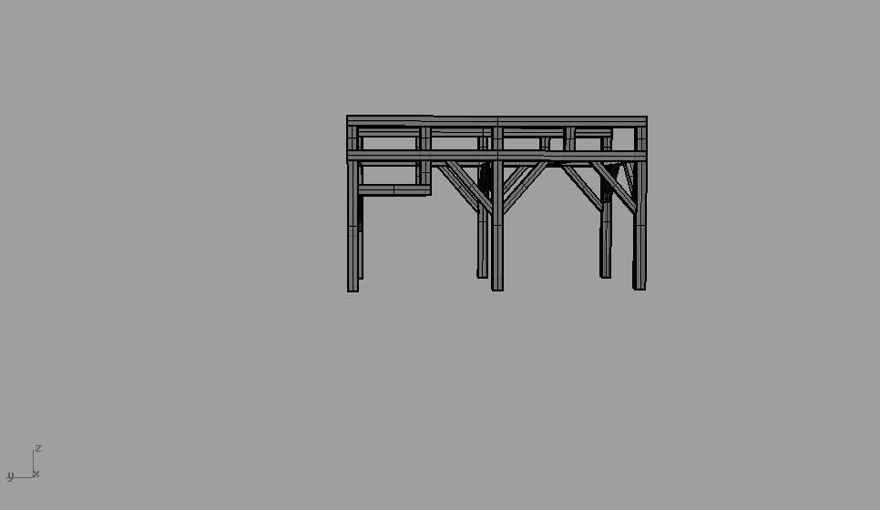

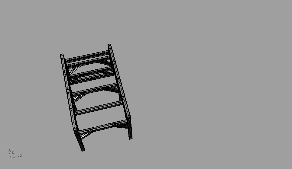

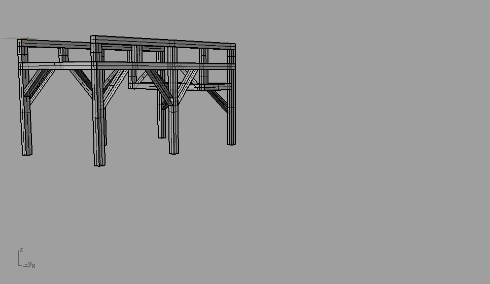

    Workbench plans.
    50x50x3mm build, any suggestions?

    Hi Nick,
    I'm still learning, but some of the best bed frame designs I've seen have a bed which attaches to the legs with screws, so you can change the height of the bed, or swap it out for a different one in the future. The other thing I thought was quite sensible would be room at the front and sides for sliding large pieces in underneath to work on their edges - looks like you've hit the nail on head already for that one though!
    Hope that helps!

    Hi Andy.
    Somehow I miss your post earlier.
    Thanks for the comments, I read other's guys threads here and I am stealing ideas, I hope this is not inappropriate. :-).
    Something I forgot to mention is that at the one end of the bench ,that is at a lower lever is for the rotating axis.

    Any thoughts about the design and the dimensions of the steel tube I use?
    I think 3mm is a bit thin for tapping into
    Hi Clive.
    Nice input,thanks!
    I will then go for 50x50x4, maybe?
    Nick.
    Sorry I forgot to mention that the total height is 280mm.
    I have read at another thread here , that to eliminate the forces when Z axis is cutting, the carriege must be at least at 250 mm from their outer sides.
    Hello !
    I think you (or me) has misunderstood..
    The bearings on x axis your long axis should be wider preferably so that the tip of the cutter is between them when viewing the machine from the side.
    The y axis bearings on gantry can be closer.
    If you use 90x90x4 steel with no welding, how will you close the ends to be able to bolt there?
    Hello !
    How close can be the bearings on the gantry so I can have good accuracy and eliminate the tolerance when torgue applied on Z axis ?
    The ends of the tubes is going to be welded with steel flanges, I prefer minimum welding for minimum stress and to be able to adjust- align everything.
