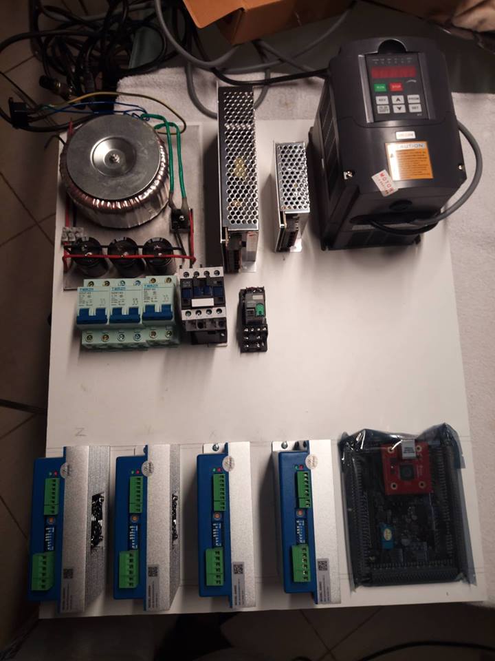

    I am thinking to place the parts that way in the control box,will it be any problem with the positioning of VFD?
    If I remember correctly people puts shielede cables to the signal wires ,wires that goes to controllers, motors etc. right?
    Attachment 25119
    The manual for each device will tell you what spacing you need for cooling, follow that.
    Attachment 25119
    I personally prefer the VFD outside of the control box. The spacing on the drives are fine I tend to use cat3 twisted for the signal wires and CY 4 core for the motors the shield grounded to the star point at one end only

    My layout is a mirror image of that because the VFD air inlet is on the left. I cut out a large hole in the side of the enclosure next to it to allow the air straight in to the VFD and the it exhausts out of a hole directly above it. That stops it drawing warm air from the enclosure.
    I allowed 2 80mm fan sized holes in the base of the enclosure below the drivers but never added the fans as they barely get warm. Natural convection seems to work fine although we are in the UK so it does not get that hot.

    Thanks routercnc.
    I have in mind to use two fans on the bottom of the enclosure box to push air in there and a filter for the dust and two on the top.
    The info about the hole near VFD is very good,I am going to use it!

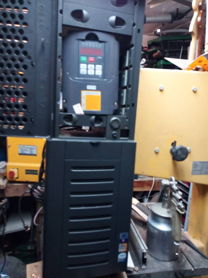

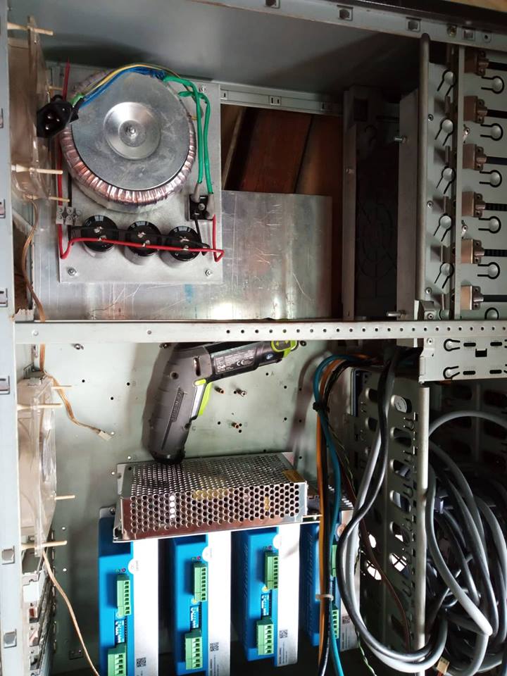

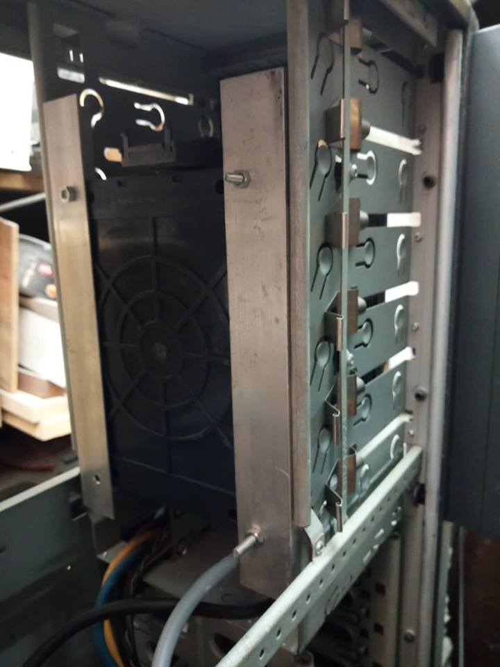

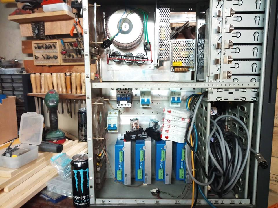

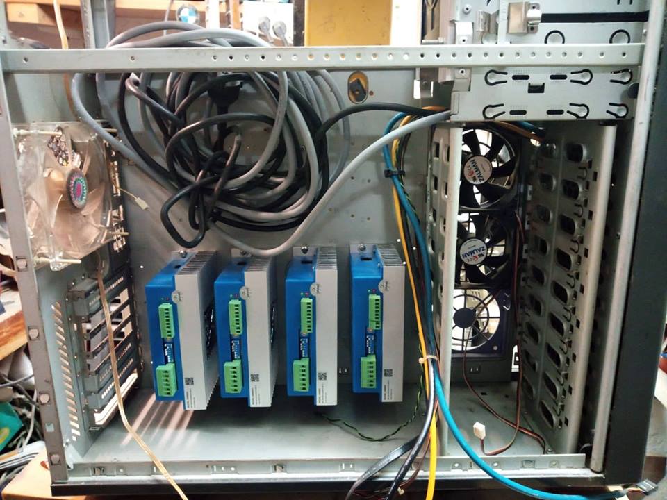

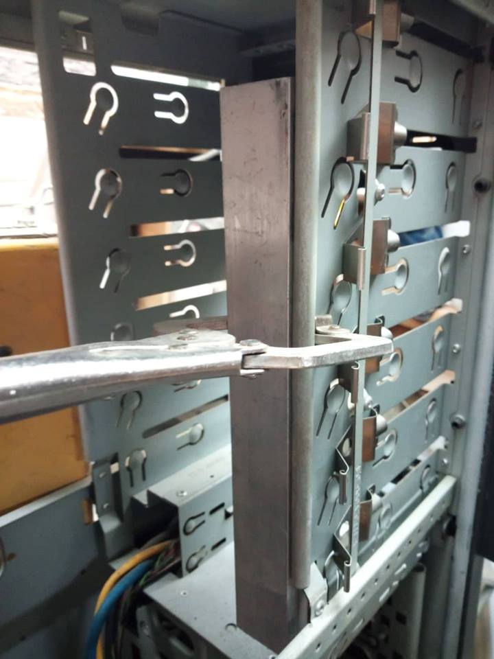

    This week a friend ask if I want one of those big PC tower for housing the electronics of the cnc, I said yes and he came with a box bigger than I could think!
    Ι did some mods on the box...

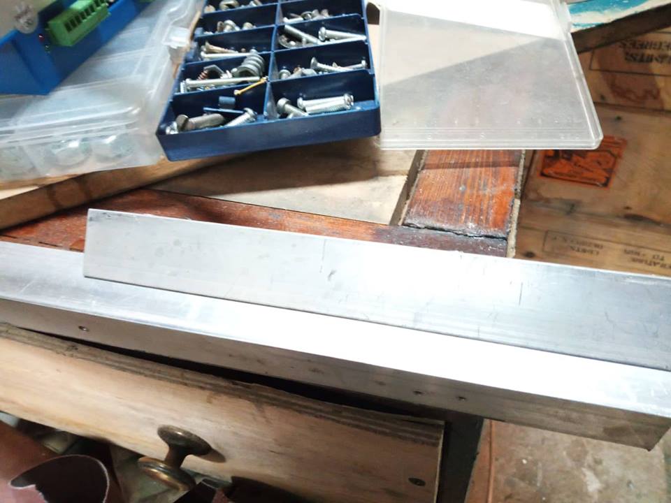

  15. #309
    Some more drills, screws, rivets and , here is the result!

    Hey Nick,
    I like it that you are making progress.
    Keep up the good work.
    Grtz Bert.
