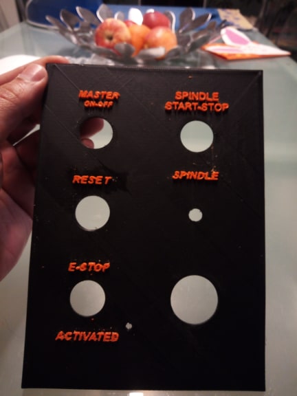

  5. #315
    Fail number one!
    And the fail number two is that I make a hike for an e-stop and one for emergency stop...

    Fail quick / cheap. I do the same, at least printing it helps to see without machining the plate and finding the issue. I found drawing stuff in CAD helps too, cos you can then visualise issues like this.

    Yes that's true , at least to everyone else except me ,since I did the drawing and didn't realize the problem until now! Haha!
    As you said it is a cheap fail, positive thinking ...that's what I like!
  9. #318
    Can you not just turn the switch round so its running horizontally, nice idea with 3d printing the panel though, don't think i've seen anyone do that here yet
    Surely the second hole for estop is for the big flashing lamp??
    Thanks Lee from time to time I have flashes of ingenuity!
    That's a good idea about turning the switch horizontal!
