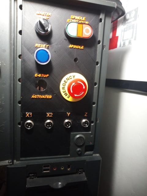

    Surely the second hole for estop is for the big flashing lamp??
    Why didn't I thought of that ! Now I need an extra big lamp to put in there!
    Thanks guys you are all so kind!
    I am thinking to place the emergency stop at the bottom right ,since there is the right hole for the switch and scrape the e- stop letters from the bottom left hole?
    Maybe I can put another switch on the bottom left hole in the future a button that I can not think of now.
    For sure I can print new letters or marking on the panel....

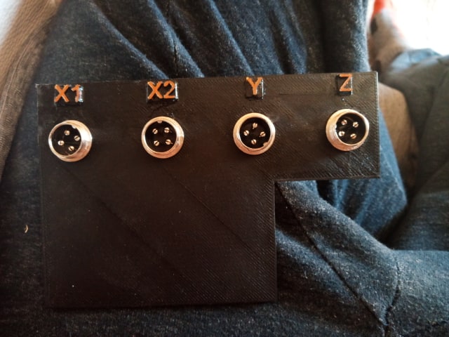

    Small progress.
    I 3D print the lower panel for the motor connectors no big deal but I like how the front panel looks now...

    Hi Nick,
    Looking good, keep it up!

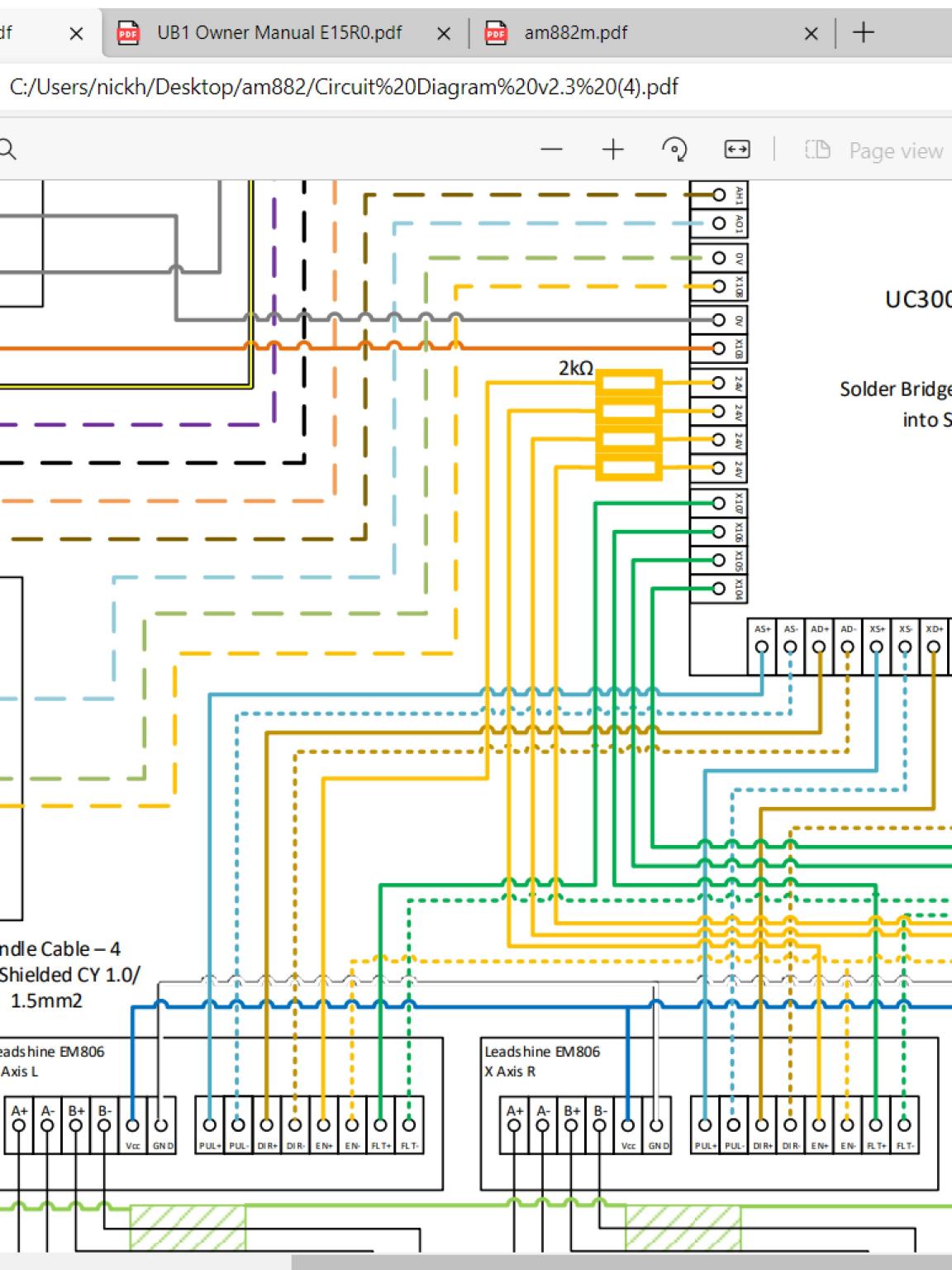

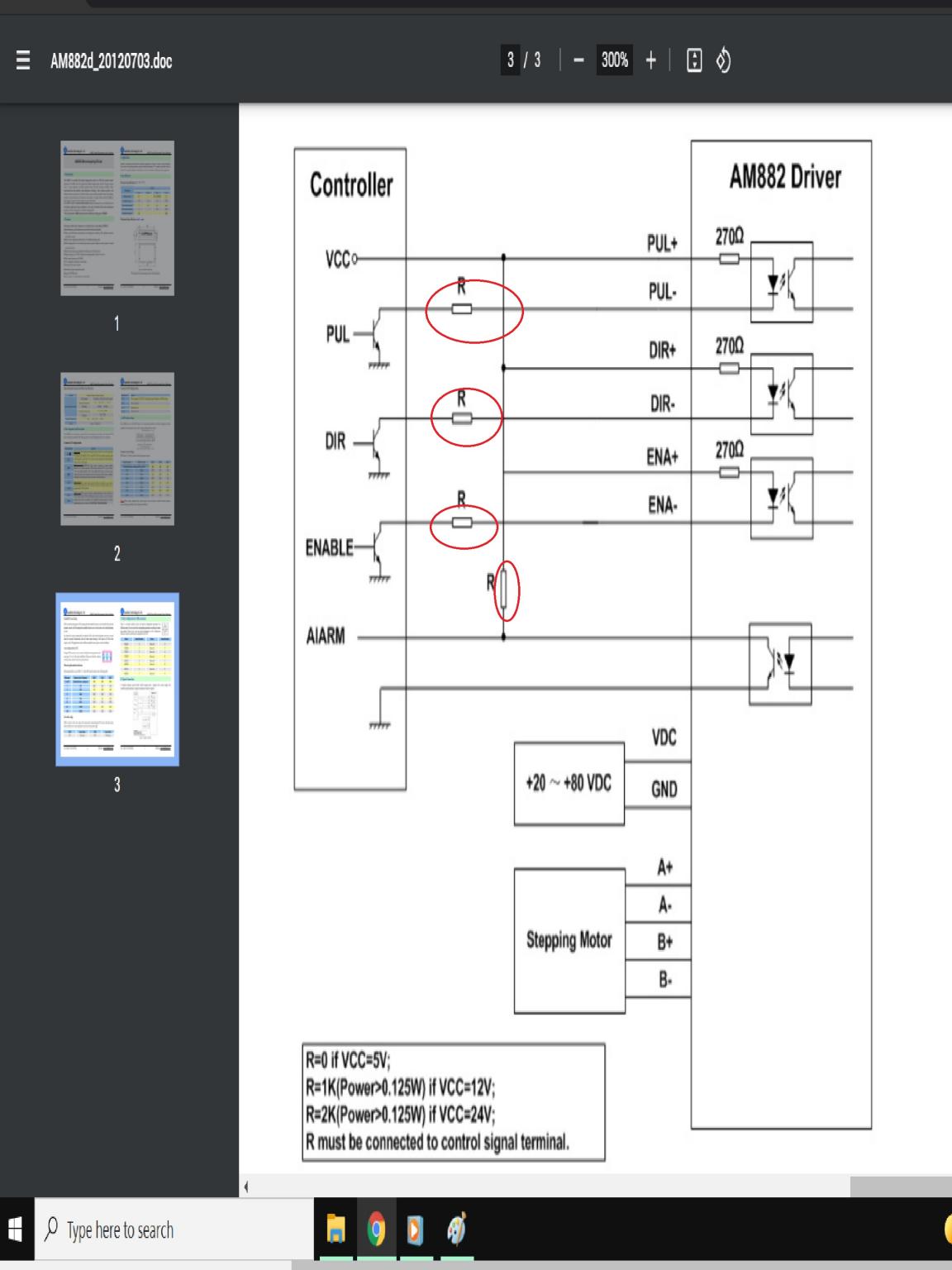

    I am using the uc300eth UB1 with AM882 Leadshine stepper motor drive, as I understand from the Leadshine manual I have to use 2k resistors for the PUL- , DIR-,ENA- and alarm since I use 24volt outputs of UC300 eth ub1 right?
    Can someone explain why the resistors are connected to - lines? Is that safe for the drivers? I have seen some diagrams connecting resistors at the + lines for protecting the drivers but this is the first time that I see the opposite.

  6. #325
    All the resistor does is limit the current to about 12 to 15mA at 24V going through the led

  8. #326
    So is it safe to use only one resistor per driver, at EN+ as the diagram above?
  9. #327
    The MOTOR OUTPUTS are 5V not 24V, only the general OUTPUTS are 24V, so you don't need the resistors for the drives.

  10. #328
    So I am going to use 2k resistors as shown on the diagram below, right?
    Sorry for keep asking, I want to eliminate the chance to make a critical mistake.

  11. #329
    No, see my post below. You don't need resistors because the motor outputs are only 5v NOT 24v
