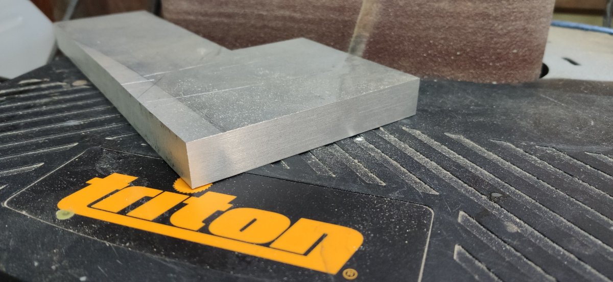

    I cut with my bandsaw the 20mm thick aluminum plate I bought from a scrap yard for 80 euros, to replace the MDF I use to mock up everything.
    Things went well.

  9. #338
    What tap and bolts do you guys recommend for the Y axis plates?
    Happy new year to you and your families!
