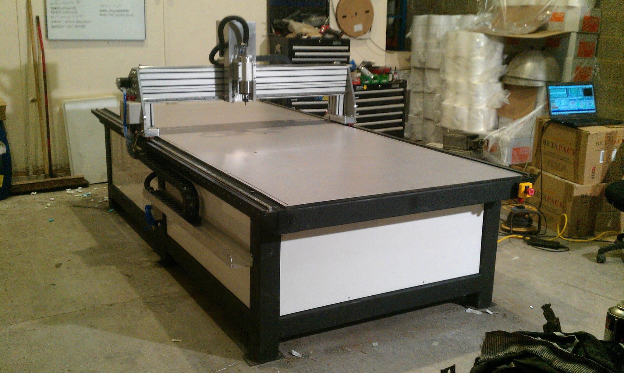

    Hi Nick,
    As per your pm:

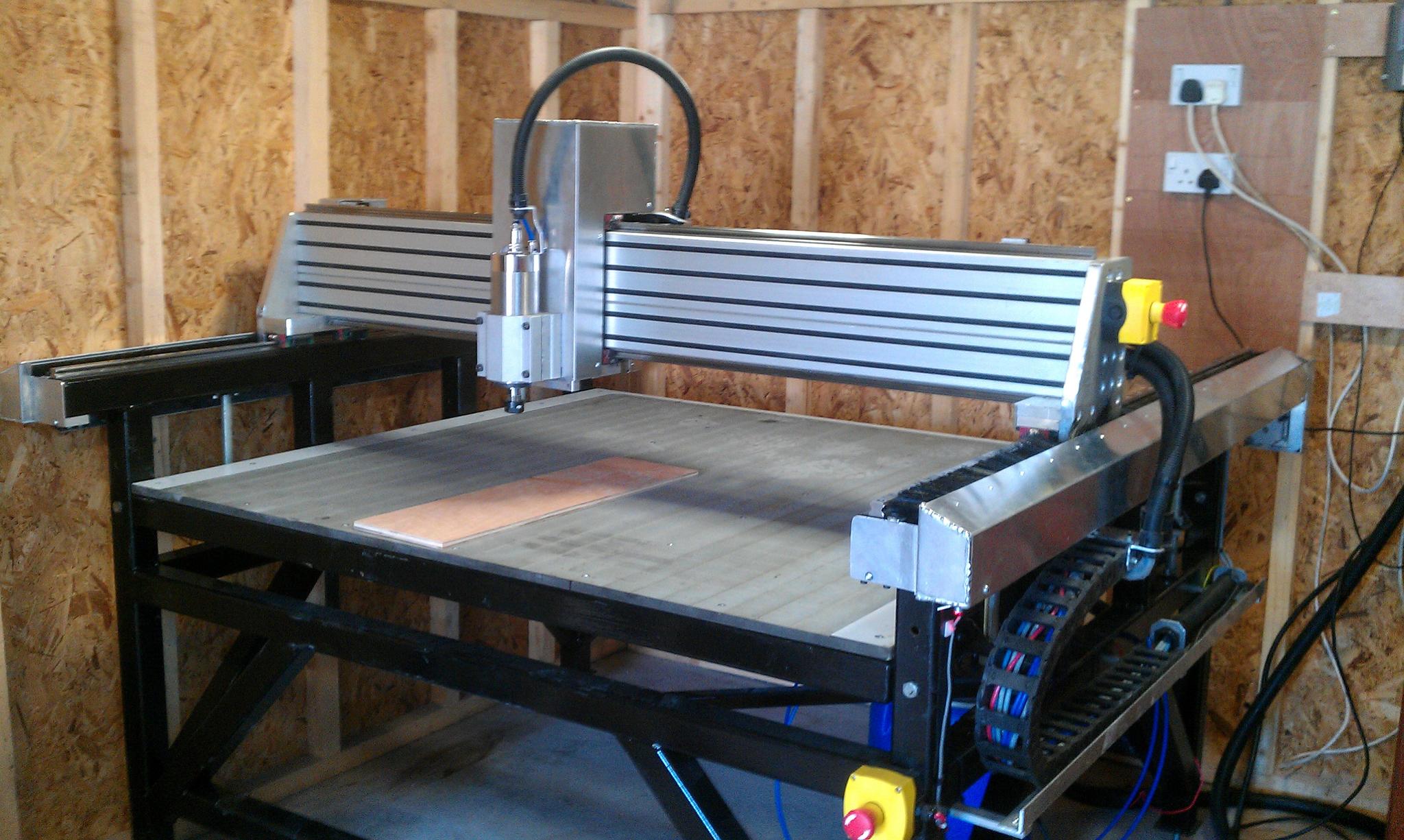

    Your requirements are to cut wood, guitar bodies, and occasional aluminium.
    The L shaped gantry in a pair of 90x45 extrusions has been used many times on this forum and will cut your requirements as above. At 900 mm gantry width it is starting to get a bit wide, but I would say still OK.
    The raised X axis can also use 90x45 extrusion so long as there are plenty of supporting uprights connecting it back to the main bed.
    Would this be good enough or should you use steel? Well, I would say you are OK to use aluminium profile on the gantry and the X axis and still cut the requirements above. If however you want to do regular aluminium cutting then I would upgrade the raised X axis sides to steel.
    Here are some aluminium gantry, steel sided machines:
    You wanted to use profile to avoid using epoxy leveling - well I've not found the profile extrusion to be particularly level and flat. You can buy specially machined profile, but regular stuff is not likely to be flat. If you don't want to epoxy level you can always shim the rails manually, but need a master straight edge to compare to.
  7. #46
    Your project is going well !
    Congrats !
    I have some positive news..
    Mostly ... In most-all alu designs/builds I have seen, little to no serious alu cutting has been done.
    BUT..
    You can later upgrade the machine stiffness, pretty easily, imho.
    If You do need to, that is.
    It will be perfectly feasible to drill/ream a few dowel pins, through clamped flats into the alu, and fix steel flats onto the sides of any beams.
    And You can even fix them mostly by gluing .. if You use industrial epoxy glues.
    And yes, they are strong enough, and no, they wont reduce rigidity.
    As-is, I would not give any advice.
    You have a pretty good path, and it is likely to work out very well for wood.
    And with suitable parameters it will likely do some alu, with hsm toolpaths and smallish cutters.
    But rigidity-needed is related to machine work-envelope size, esp. free-length ie the working length of your beam.
    900 mm is pretty big.
    A mechmate at 1200 mm beam is pretty close, and they are a near-professional tool, in steel, heavy and expensive to build.
    In a nutshell;
    looks good.
    Likely to give great results in wood.
    Well done.
    Keep going.
    If You need to, *anything* can always be upgraded.
