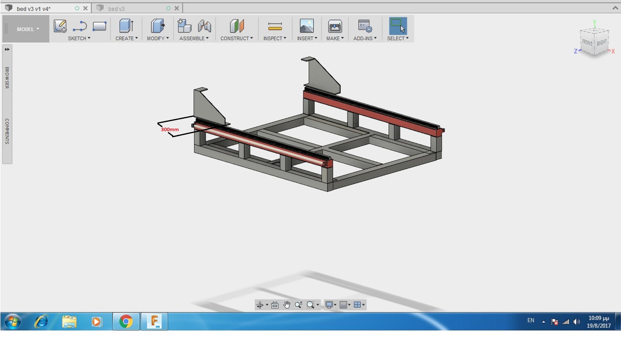

    I am thinking to make the base of X axe support plate 300mm, is it ok or too much?
    I quess that to find the length of the ballscrew for x axis etc, I have to substract the legth of baseplate from the legth of the rail,right?
Name:	bed and x axis (1).jpg
    So 1200mm for Xaxis subtract 300 =900mm for balscrew plus f plus space for the end support bearings bk and bf.
    300mm is more than enough.

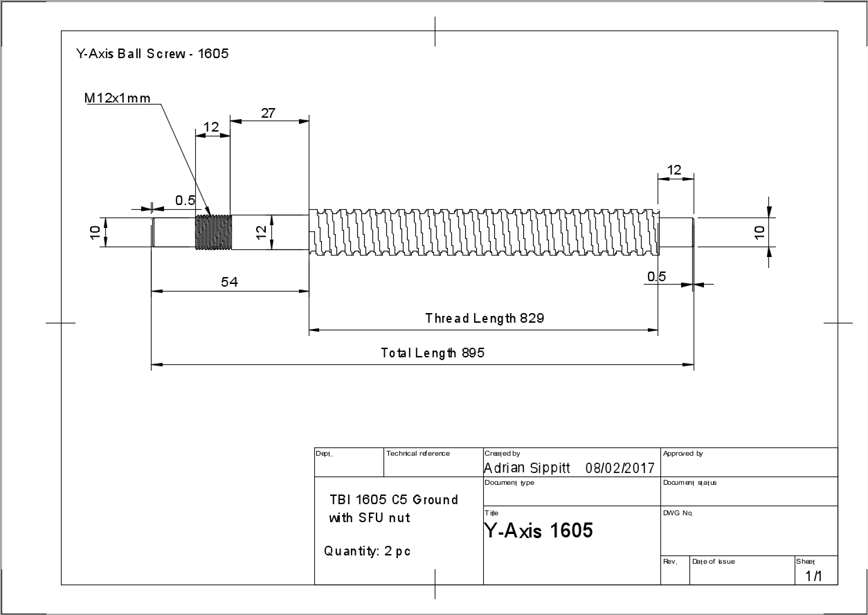

    Yes, although there is no real harm in having a slightly longer ball screw travel than the machine travel of course if it helps you in locating motors/bearing mounts. The only downside is possibly slightly more expense and a slightly lower critical speed if you get a screw longer than needed.

    So the ballscrew I am going to order, lets say for the X, long axis ,is going to be 900mm plus smth, maybe 950mm?
    What is the minimum the support plates legth can be, so I can have a rigid gantry?

    250-300mm will give you a very solid mounting... Given it's a fairly large machine I wouldn't try to save space too much.
    Size depends on what motor mounts/bearing mounts/couplings you are using. Don't just guess! Do you know what mounts and bearing arrangements you are using yet?

    This may be of use - its the technical drawing I made when ordering my screws. The dimensions are suitable for an FK12 angular contact on the motor end and an ff12 floating bearing on the other end.
