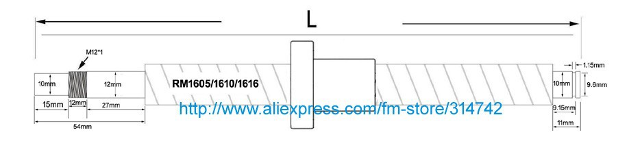

  9. #67
    Generally the screws don't need to be as long as the rails.
    I remember that,we discuss it also with Zeefleeboy but at BST Automation there is a photo that show that the length at the description is the total length.
    Did I misunderstand something, maybe I have to check with Fred from BST.
    OK when you quote for the screw you tell him the total length (including the F length) and say what F length you want, the standard is about 15mm but that is not enough so ask for the F length to be 30mm (this is the bit where the pulley will fit).
    If you PM me your list I will format it for you so that Fred will understand it. You also have to ask for grease nipples.
