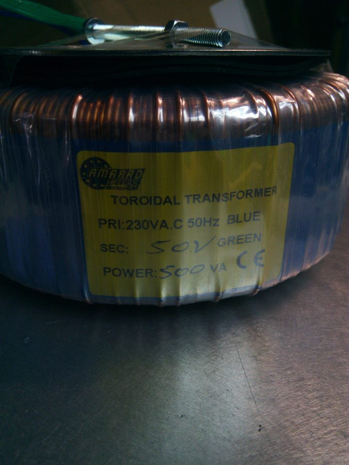

    Finish the power supply, thanks everyone for the help.

    It is good practise to not to daisy chain the 70V across each drive ie. use separate power leads from each drive to a common block and then connect the PS to the block. This ensures you are not getting a volt drop to each drive from the first one.

    That's super tidy, I see you went DC in the end. What voltage output transformer is it? 50v?
    I wired the transformer to a 13 amp light style switch and then my VFD and water pump to another switch and both of them are wired from the emergency stop.
    This way I can easily turn the transformer on/off and if the vfd is powered the water pump is on. I have both switches and the emergency stop at the front of the machine for easy access in a row.
    If I hit the emergency stop it kills power to both the steppers and the vfd, I still have to work out how to get it to trigger an estop on the pc but it's good enough for me at the moment.
    Just use a relay with a 230VAC coil.
  9. #197
    Thank you both for the idea, any wiring diagram will be helpful.
    Desertboy you are right it is a 50V output transformer.
