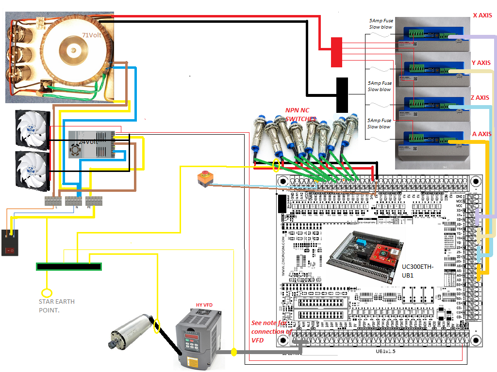

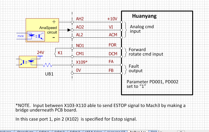

    This is what I come up untill now, no water pump or stepper motors yet added.
    HY VFD is going to be connected according the second schematic.
    Can you guys check the diagram to see if you find any issues, I add also the manual of UB1.
    Also please suggest where to put fuses and relays.
    Thanks,Nick.

    One thing I see is that you seem to have fuses in the -ve line from the 72v PS that is NOT good practise and are not necessary. Also 5A may be a bit low
  4. #284
    Not a good practise at all ,I didn'r realyse I put the fuses there.
    I change it .Thanks!

    Can anyone suggest how to connect relays and fuses at this wiring diagram?
  6. #286
    Hi Nick,
    I have a primairy CB 16amp C type for the entire cabinet.
    I have a CB 4Amp on the 230volt side of the 24vdc 2a supply. PSU secundary is shortcicuit protected.
    But maybe an extra 24volt side glass fuse would be appropriate there.
    The above CB's are for convienience only.
    I still want a 16amp B type CB on secundary side 72vdc psu.
    Mine is a high amp (10amps nominal) psu 500va transformer... and would like to protect the wiring in the panel.
    Shorting out 72vdc circuit can lead to higher amps than i can trust some of the 1mm2 cabinet wiring with.
    Since you have 5vdc onboard on ub1 no problems there.
    For the relays.. is this about the e-stop relay we talked about?
    Can you list the stuff you want to control by relays? You mentioned an ub1 has 3 onboard so...
    Maybe pneumatic valves, pumps , vfd?
    What needs switching on/off more than the 3 relays available to you?
    I would use the onboard relays just for low current stuff like the remote on / off for the vfd , the spindle cooling pump, maybe chip clearing air valves and or liquids.
    Why would you want a 16 breaker on the secondary side Just a slow blow fuse to each drive is more than enough.
    Hi Clive S,
    Like i said.. most cabinet wiring is 1mm2.. a bit on the thin side for maximum current the 500va 72vdc psu can generate.
    And nothing to stop it .... yet.
    I did run separate wires to all drives.
    So i could do 4 fuses. 1 per drive.

    The only thing the 72v ps is supplying is the drives so what has the 1mm wiring got to do with it. Also 1mm cable can carry in the region of 10A
  10. #290

    Hi Bert
    Thanks for the reply.
    The relays that the card has onboard are charachterized as ''signal relays that should never used as power relays, they are intended to convey signals such as fwd and reverse to a VFD ...However please take care , as the contact of these relays can carry a max current of 0.5 amp at 120V AC or 1 amp at 24V dc.The user must use an external relay if the load requirements of the device will exceed the current rating.''
    This is why i mention the external relay connection.
    To answer the other question you put, I want to connect the maximum I can on this card ,water pump , air nozzle etc.

    I am going for this configuration because my previus cnc was wired like that, if there is a better way of course I prefer it.
    You are speaking about traveling proximity switches, right?
    Regards.
    Nick.
