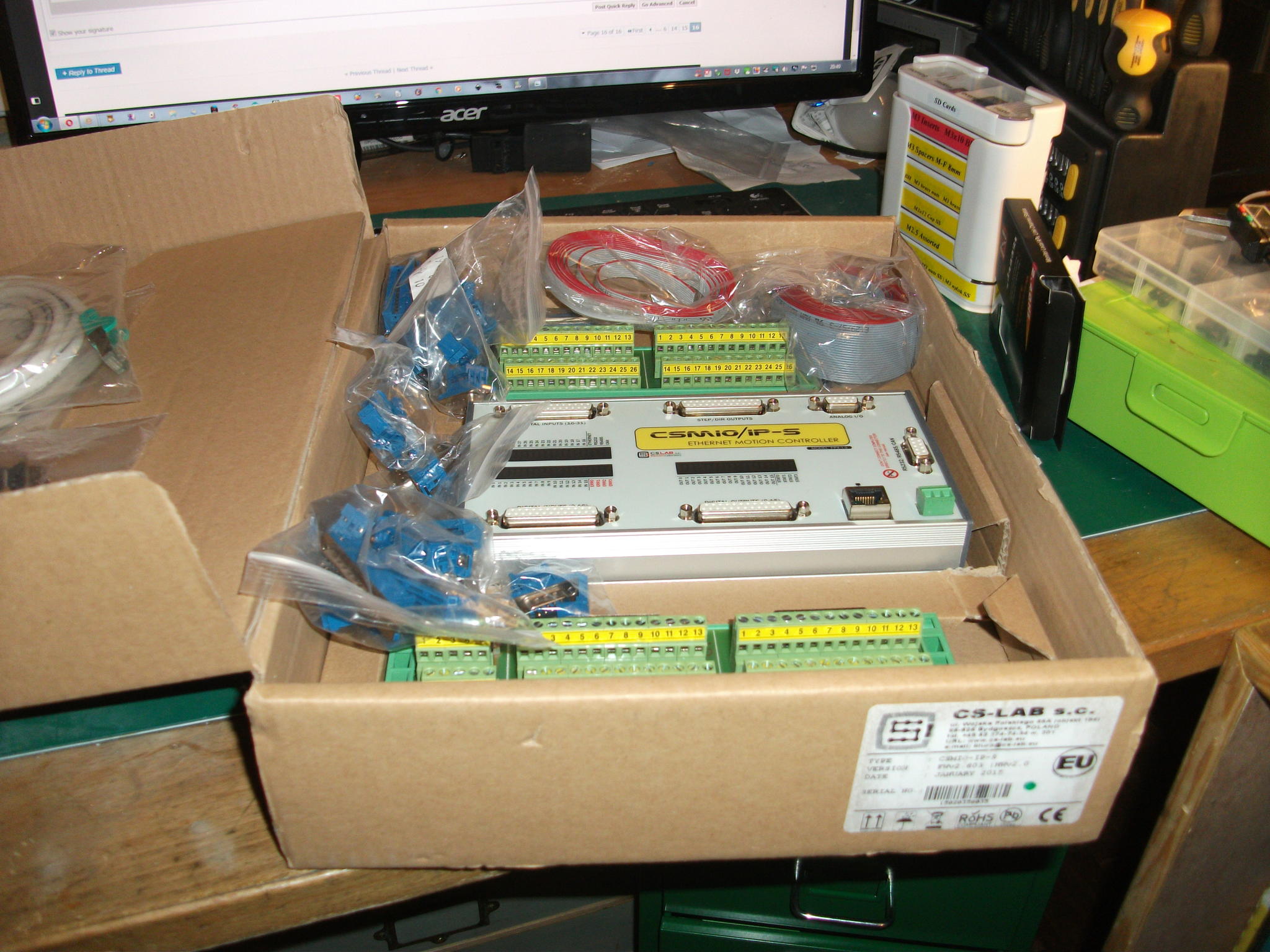

If you are spending all that much on the motors and drivers, then I would go for a proper motion controller not a Parallel port BOB.

I bought this beast because it was cheap and I intended to use it for my current machine and/or the next build, but various bits of my life got in the way, so it sits in a cupboard, next to the Super-PID speed controller for my router. One day, Maybe !!!
I just think that Printer Ports are soon to be history, like floppy disks and you would be better served by looking forward rather than staying stuck in the past.
