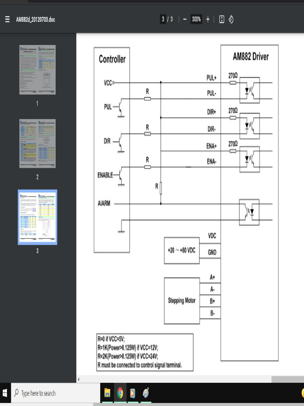

    I am using the uc300eth UB1 with AM882 Leadshine stepper motor drive, as I understand from the Leadshine manual I have to use 2k resistors for the PUL- , DIR-,ENA- and alarm since I use 24volt outputs of UC300 eth ub1 right?
    Can someone explain why the resistors are connected to - lines? Is that safe for the drivers? I have seen some diagrams connecting resistors at the + lines for protecting the drivers but this is the first time that I see the opposite.

  6. #325
    All the resistor does is limit the current to about 12 to 15mA at 24V going through the led

    So is it safe to use only one resistor per driver, at EN+ as the diagram above?

  9. #327
    The MOTOR OUTPUTS are 5V not 24V, only the general OUTPUTS are 24V, so you don't need the resistors for the drives.

  10. #328
    So I am going to use 2k resistors as shown on the diagram below, right?
    Sorry for keep asking, I want to eliminate the chance to make a critical mistake.

  11. #329
    No, see my post below. You don't need resistors because the motor outputs are only 5v NOT 24v
