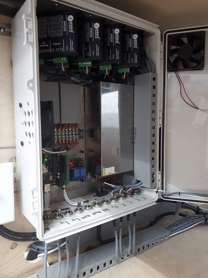

    I am about to purchase those shocet connectorst ,since they have 40 days delivery to Greece,are those any good? How many pins per socket to I need?

    What do you need them for? ;)
    Are you thinking about steppers or maybe switches?
    Plan ahead and order with one pin more than you need. I have similar connectors that doesn't have continuity in the shells so I need an extra pin to connect the wire shield. That's assuming that you will use shielded wire?
    In theory you could have a big 20-25 connector for plugging everything in with one socket and then route it in connectorboxes on the machine itself.. :D
  6. #86
    Hi Robert,thanks for the fast reply!
    I am thinking to use them on the housing box to connect the cables that comes and goes from the electronic housing box.
    Something like that:

  7. #87
    Okey.. but do you want one for each motor and separate for switches or do you want only one big cable?
    If bundling several signals in the same cable you loose the screen protection between them..
    The normal that I see people using is one for limits and a one each for each motor
    And of course if you want e-stop on the machine or probe or something like that.
    Steppers are usually 4 signals + shield so 5 pins.
    A switch depends on type of switch! But could be +, gnd, signal, shield so total 4 pins.
    But it could also be + and gnd without shield for a simple mechanical switch with simpler wire for a total of 2 pins. But greater risk of interference.
    So it all depends on your equipment :)
