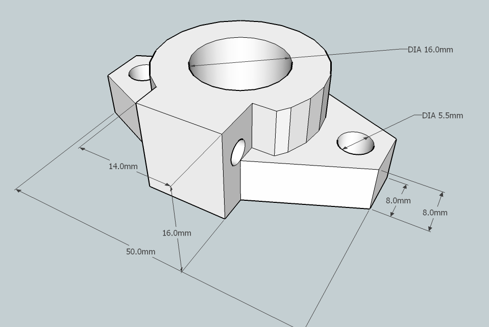

    I have come up with a challenge :exclaim:
    to model one of the shaft supports on the Marchant Dice site. (hope he dony mind!) His'll be cheaper than our efforts lol
    OK Attached are the dimensions and a photo of the Shaft Support.
    Challenge is to model this in Sketchup and produce G Code for Mach3 to machine it. Lets do a 16mm version
    There is no prize, just some
    To make this fair, post a 2D export of the model from Sketchup, and the G Code. How you get from the model to G Code is the real challenge. No Cheating :nope:

    Yes ,,, well ,,,, :whistling:
    I can get the model, but I can't get it imported into any of the CAM tools I have available!:sad:
    So ... aahmmm
    Challenge off :clap:
