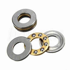

    I think i`ll add 1 of those bearings in spindle nose and then add skate ones after.
    I think that this will eliminate axial force on ("next in row") radial skate bearings.
    P.S. I must construct proper housing for this combo.

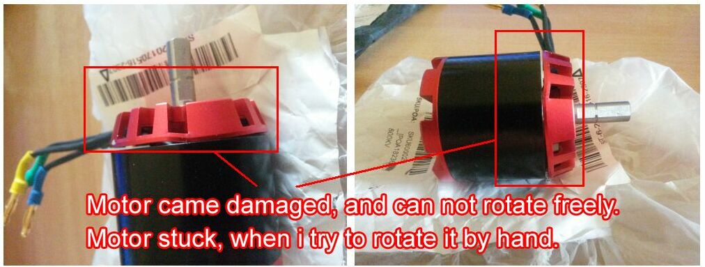

    New motor came, but again bad news. Motor came damaged due poor packaging.
    Can this be repaired? How to balance it?

    I read most topics and help where I can but I have never played with this sort of thing in this situation so I am at a loss.
    Can you return the motor as it looks shot (no pun intended)? I have no idea if the bearings are suitable, I have used that type but at low speeds. Good luck with the build.

    Without doing a google on a bearing site I cant tell you if they're suitable. However whatever bearings you use will need a preload on them to stop them from skidding. The best bearings to use (apart from a double row AC bearing) are magneto (single AC bearings) bearings and preload them with something like bellville washers.
    I`ve got a 2/3 refund without returning it, so it`s my 2nd defective junk motor in collection.
    So i`ll try one more time...( i think that you have the same joke about "3rd luck" )
    I checked few companies for this type of bearings. All of them are low speed indeed, so no go.
    Finally, thanks for your wishes.
