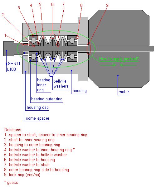

    ... whatever bearings you use will need a preload on them to stop them from skidding. ....preload them with something like bellville washers.
    As you already know, i read all yours conversation with blackburn mark an others about preloading when you was building your spindle. But everything is a little confusing to me, as English is not my language. So i draw a sketch in mspaint( 1000 words) to clear things. Simply answer to numbers with tight/loose relations between parts. For example, i think 2 and 3 are tight connections.
    Then, please explain "preload". Is that, to tightening a housing cap with housing to press outer bearing ring, or something else?

    I think it would be a great help for me and others to see all relations in one place, so thanks in advance.

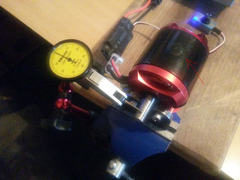

    Things are start to get moving...
    I hook up the motor, everything works.
    Motor sound way unbalanced, make huge vibrations in mid range ( @12V ) rpms.
    But the dial tester says just a 0.01 runout???

    turn motor by ~70 degree left sims to give bigest value....( see sticker on rotor -1st pic)

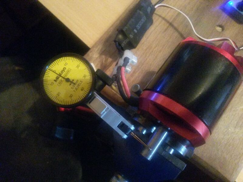

    By the way this is the first time to use this dial test indicator ( just arrived ), so i think that
    maybe the tool is not precise, or i`m doing something wrong???

  3. #23
    It's probably not the shaft that's unbalanced but the magnets in the bell, not unusual to have big globs of glue between some magnets and not others. The DTI looks a good one so I'd say you've minimal runout on the shaft.
    Neil...
    Build log...here
  4. #24
    Actually the DTI works perfect. I borrow a second (pro one) from a friend and done some comparative test, so mine DTI works great. A very handy tool :-).

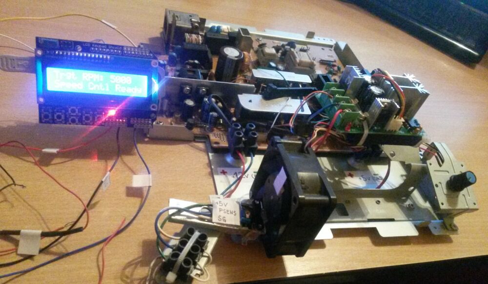

    Because of that, i decided to use my spare time to build a electronics for my future spindle. So far i figured out how to
    make an Arduino speed control. This is a only one video i find so far, that closely matches mine idea.
    https://www.youtube.com/watch?v=kYFNUQgE26E
    Arduino reads rpms from spindle with an optical sensor, and sends pwm output, so actual rpms try to match targeted one ( take a look at the video).
    This " pid " control is not designed to work with ours rc outrunner and ESC.
    But there is an Arduino servo library and a bunch of tutorials on how to conrtol ESC with Arduino.
    So it`ll be most elegant if i manage to mredge this in one project.
    When we cut some mat., spindle will try to maintain the rpm, so torque is improved. :-)
    Gain will be big (and dirt cheap) with this speed control.
    Early phase of experiment (with salvaged hadware) + Arduino...

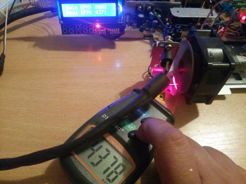

    My "S-Pid" controller work continues.
    Made new sensor today (paper detection sensor salvaged from some old printer, copier...desoldered from its original pcb and added some resistors...) I done some fine tunings and start measuring. I compared my controller readings with
    results measured with my standalone tachometer device. Accuracy is far better then i expected. Check the picture!
    P.S. So... finding and building a good sensor is done. Accuracy of reading RPM is checked and accomplished, also. Now i will hook an real rc brushless motor instead of this pc fan.
