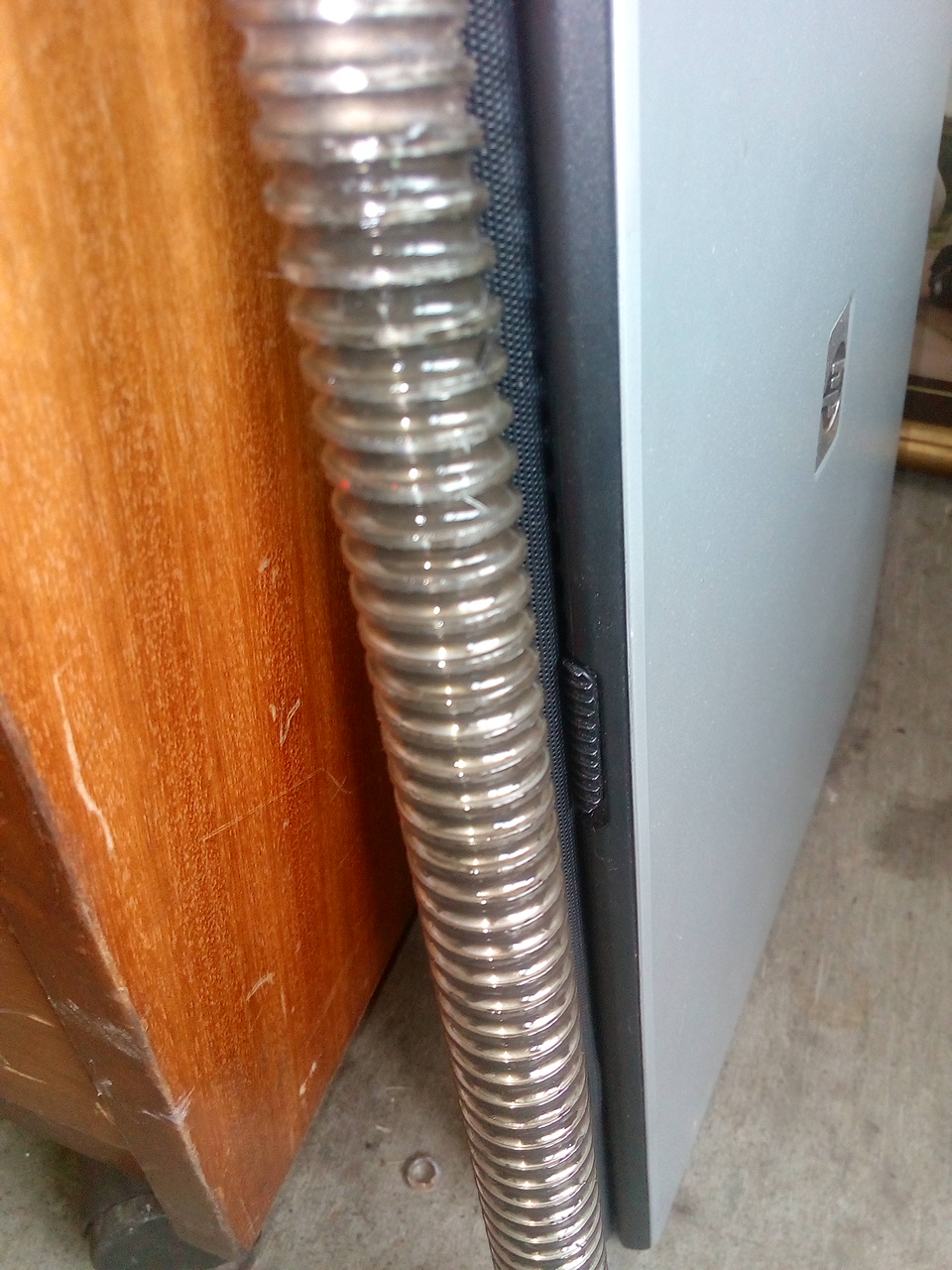

    Can you tell from the picture if this is rolled or ground?

    Do you have a better close up of the threads?

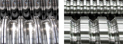

    Rolled screws tend to have a groove in between the threads, whereas ground screws don't.
    In the pic, left is rolled, right is ground.

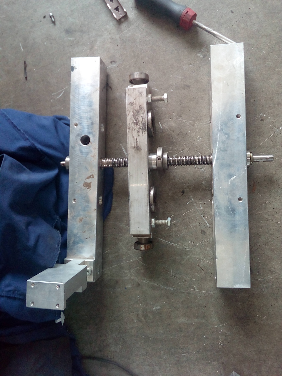

    I'll grab a better pic and post it shortly, but thanks that makes it easy to ID.
    I'm pretty sure it's ground looking at those photo's.
