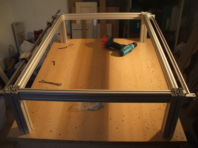

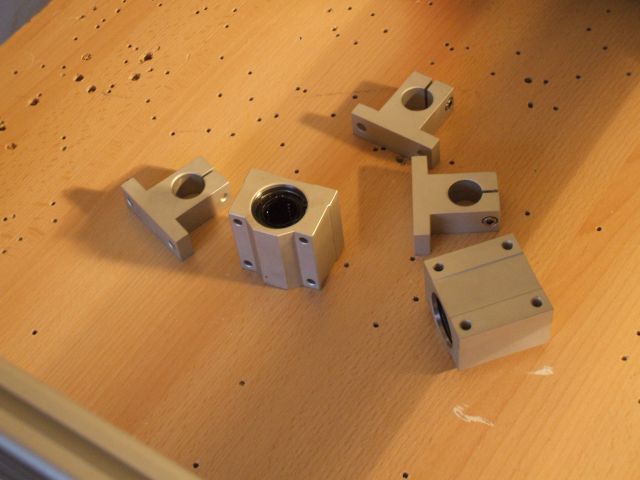

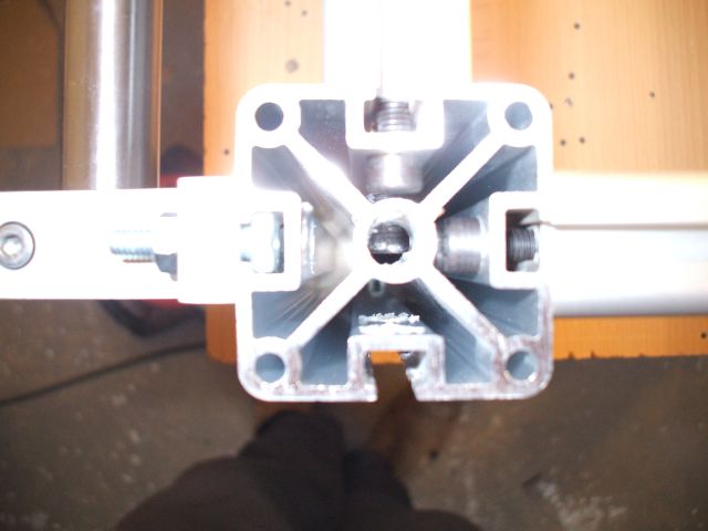

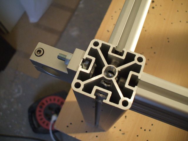

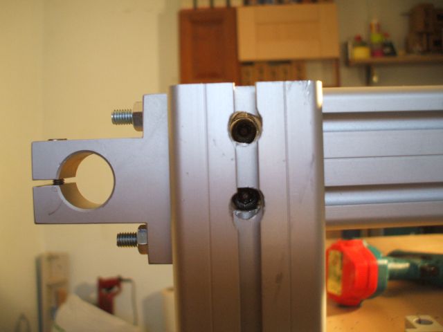

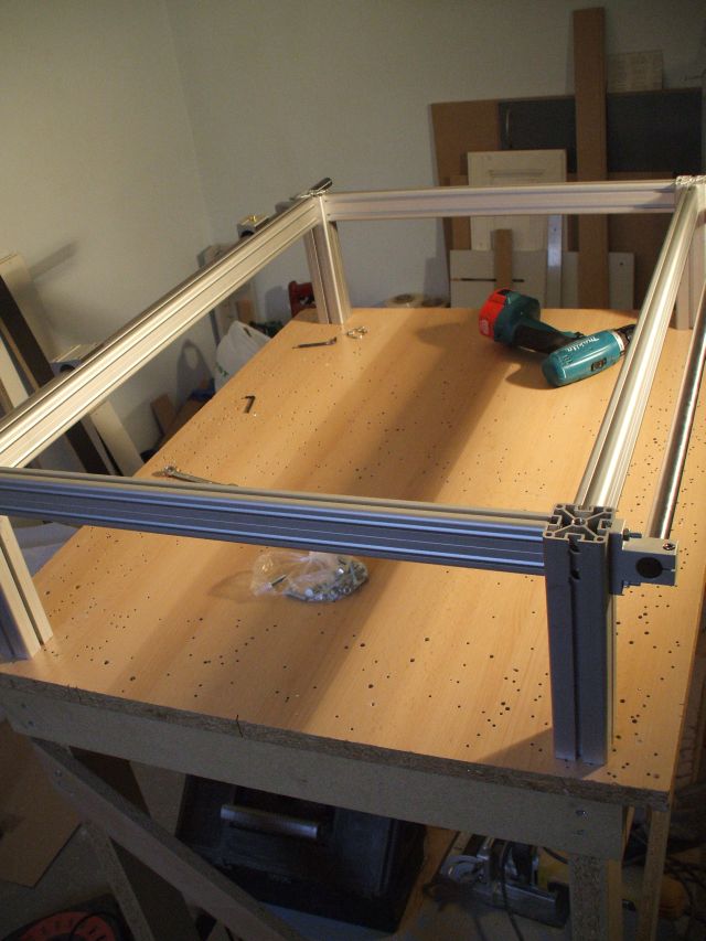

    Hi,my name is Predrag.I have a litle workshop for kitchen and furniture.In a last few mounts i am started building a cnc router.Dimension of worktop is 1000mm x 800mm.Working dimension will be aboute 800mm x 600 mm.On all 3 axes have ball screw 16/5mm with linear motion shaft and bearings.For x axe 20mm motion and shaft,for y and z axes 16mm shaft and bearings.This machine will moustly cut and curve MDF and cut chipboard.My problem is electronics,strenght of stepper motors.From yours opinion, which motors for my machine?Ok for me is 2000mm/min feedrate.Sory for my english and many greatings for cnc comunity from,newer prosy,Serbia!

    3 nm?,thats what i think.Thank you for welcoming,just for my curiosity,is structure of my machine will be enough for my needs?

    Sory for waiting updates pictures my machine,but here i am.After completing machine,i found a verry big problem.My rails with no support are barely for x and y axis.In the middle axis the whole bridge falls a few milimeters which is too much.In the meantime, i bought stepers 3 pieces,they have 2 nm,hope will be enough and router makita 3612 c for my spindle.When i bought support for rails, i will make again machine and pictures will be on this forum.Until then, a lot off gretengs from,never boring,Serbia!
    Cant wait to see the new machine, any pics of your current machine/design ?
    16mm Y axis ? you should be going for 20mm Round Rail no ?
    Heavy gantry/bridge maybe ?
