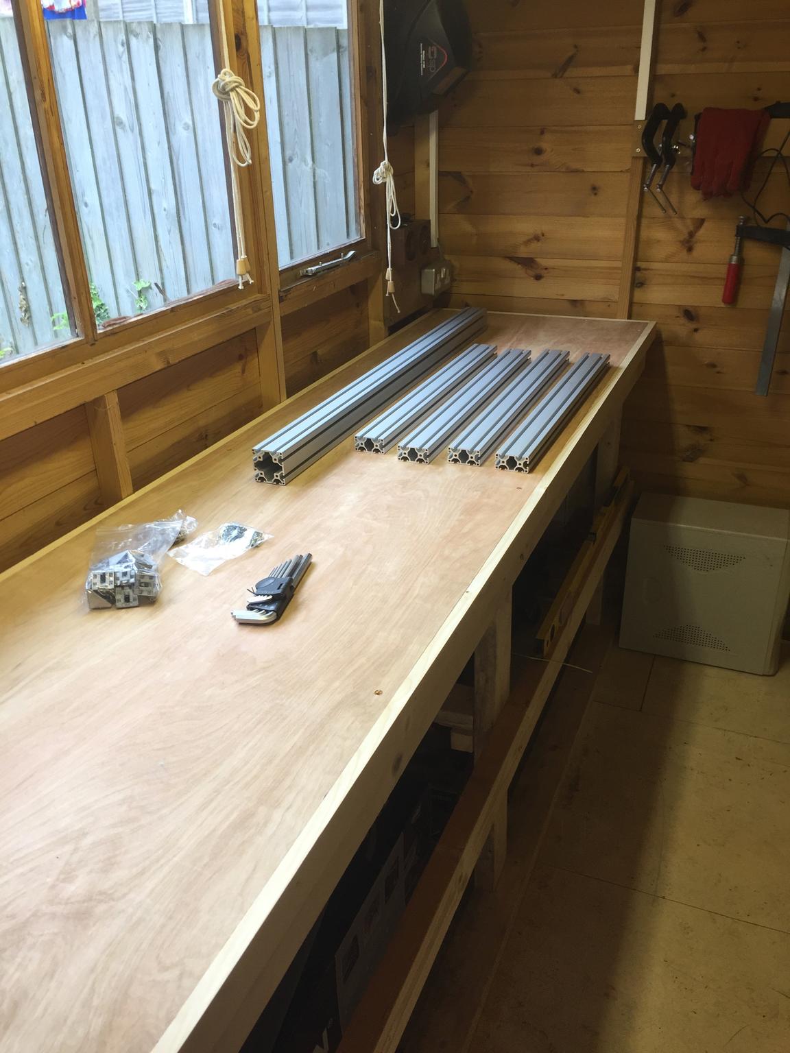

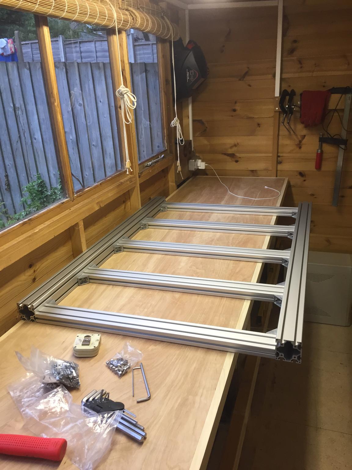

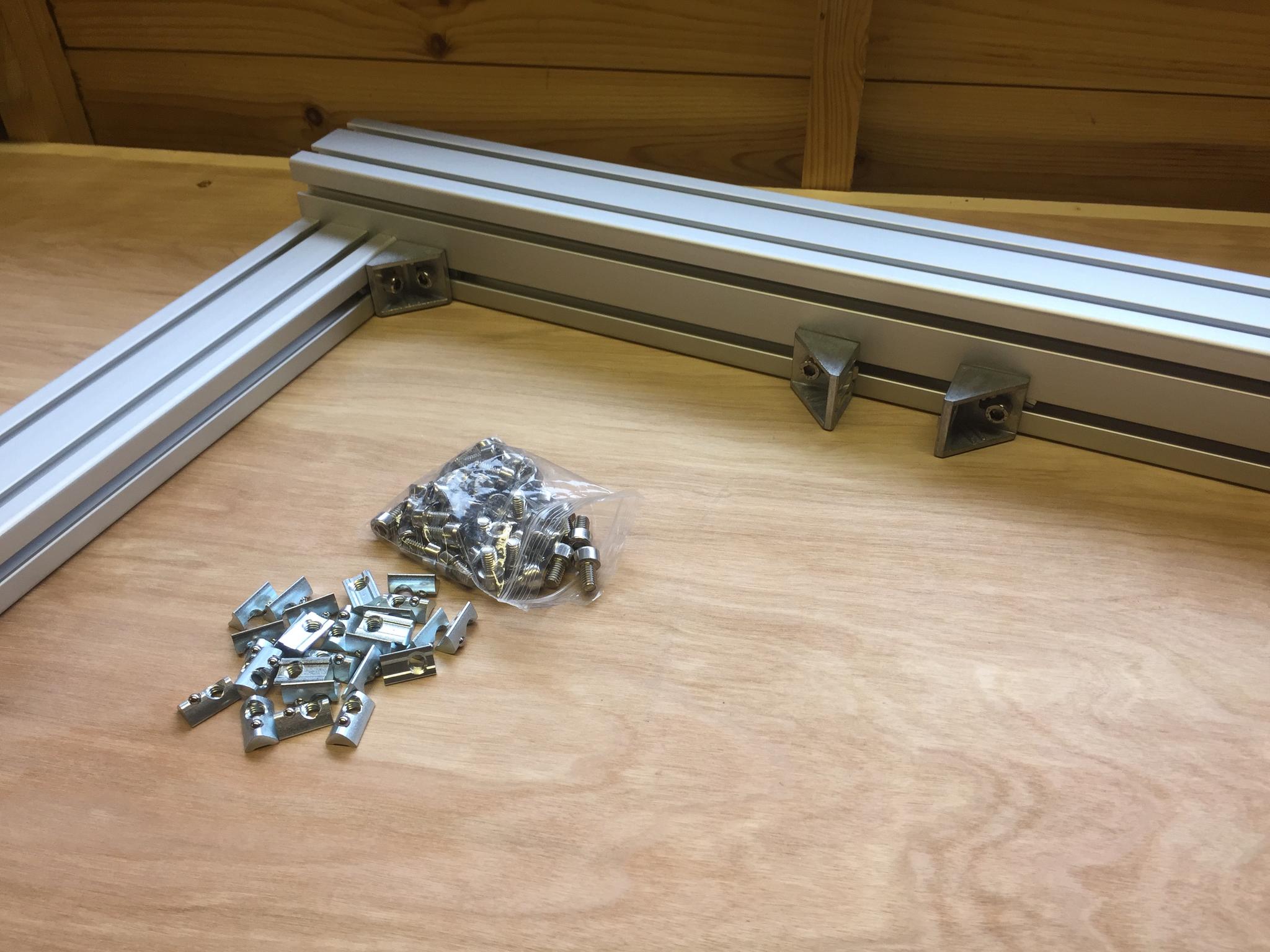

    A bit of space to spread out in the shed. Ally profile supplied and cut to specified size from KJN in Leicestershire. Two 60 x 60 profiles to support the supported rails and Five 30 x 60 profiles as cross beams to create the base.
    Profile nuts and angle brackets again supplied by KJN. Captive hex nuts from eBay. If you're going to build your own router, get loads of varying sizes. I kept buying what I thought I needed to save a few pounds here and there. In the end I decided if I needed 1 I might as well buy 100 as you will use them.

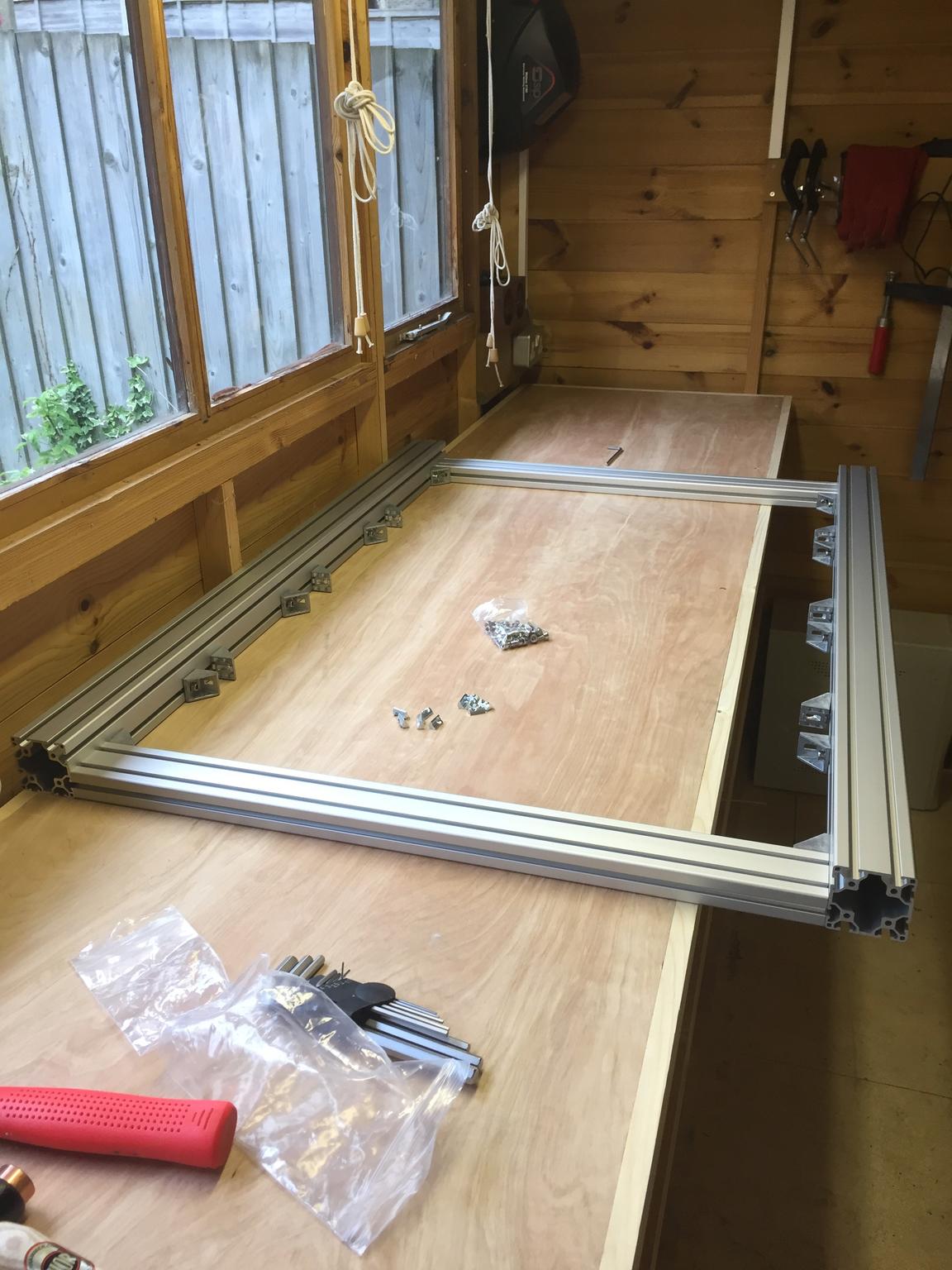

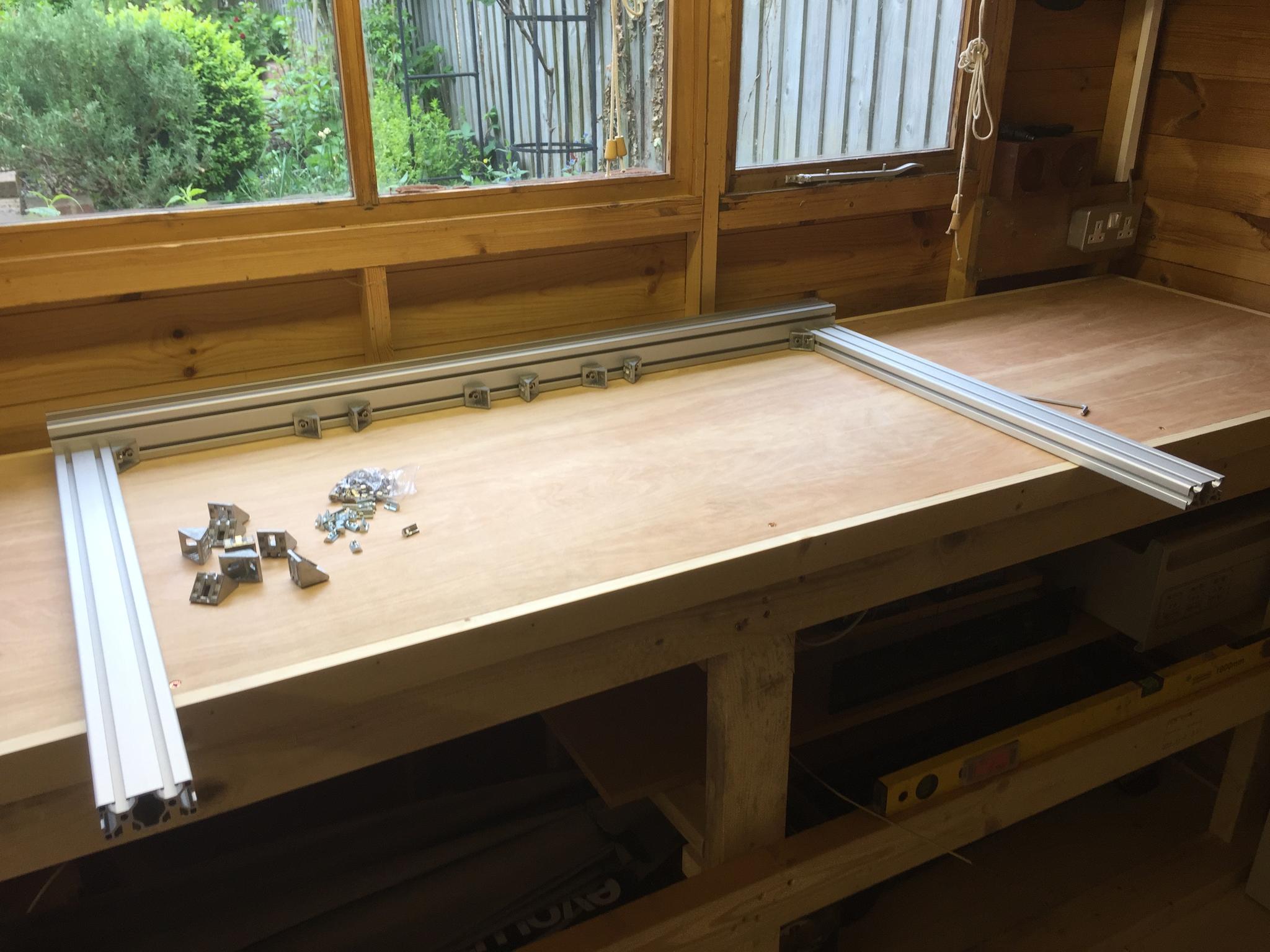

    First couple of cross beams attached. This is all very easy, just like playing with posh (expensive) meccano.
    Second piece of 60 x 60 profile attached. Not yet tightened up.

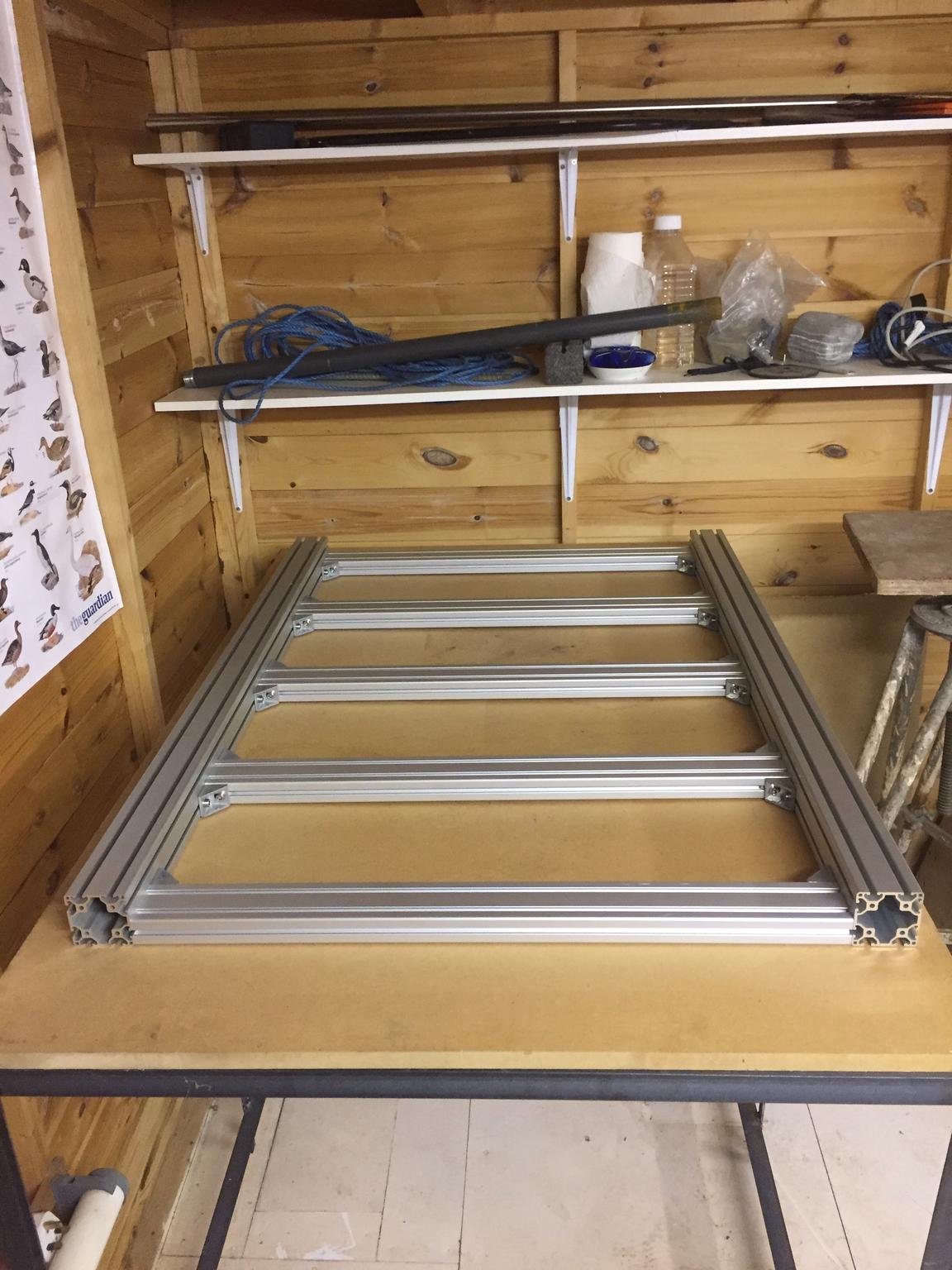

    All cross members are now attached, still not tightened up.

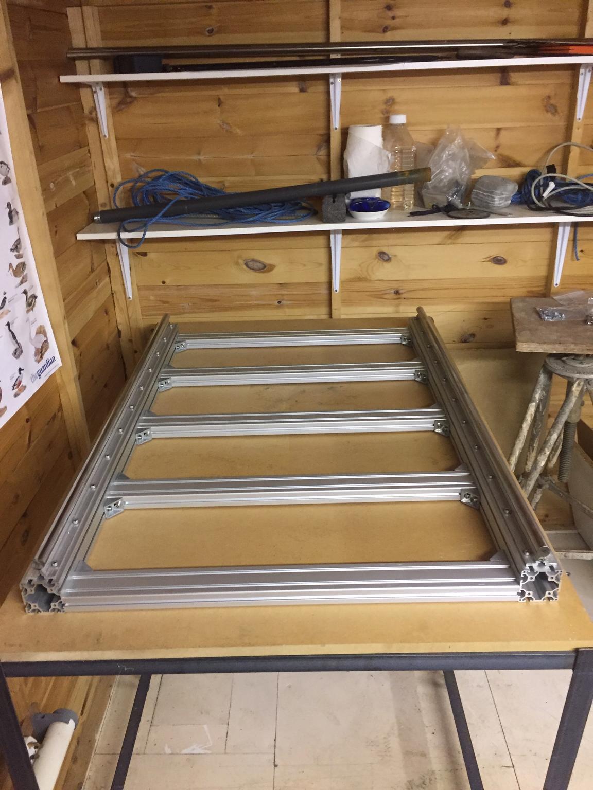

    Placed the whole thing on the flattest thing I own. A brand new piece of 18mm MDF on a steel bench that I've welded together. I have photo's of this construction if anyone's particularly interested. It's not that interesting though. Just a few mitred bits of steel angle welded together in the form of a cube which my spirit level tells me is flat. Everything is now firmed up and all seems pretty rigid.

    The 20mm supported linear rails that I bought from Chai about 4 years ago attached using profile nuts and 12mm captive hex bolts. These rails are 1150mm in length with ball screws that I bought as a package from Chai. My first major bit of advice is design your machine to the nth degree before buying anything. I didn't and bought a package of rails, bearings, ball screws etc thinking it would spur me on. It did to some extent but I think it would have been easier to get the supplier to make things to my requirements, rather than me building my machine to the constraints placed on me by the lengths of the ballscrews. Just because it's a package doesn't mean that they are necessarily the best dimensions to work together. For example as we'll see later on my Z axis I have a ball screw of 350mm with rails of 300mm. After spacing the bearings sensibly to maximise the strength, I had travel on the Z Axis of just over 100mm, which is fine for what I need but there's effectively 200mm of ball screw there that will never be used.

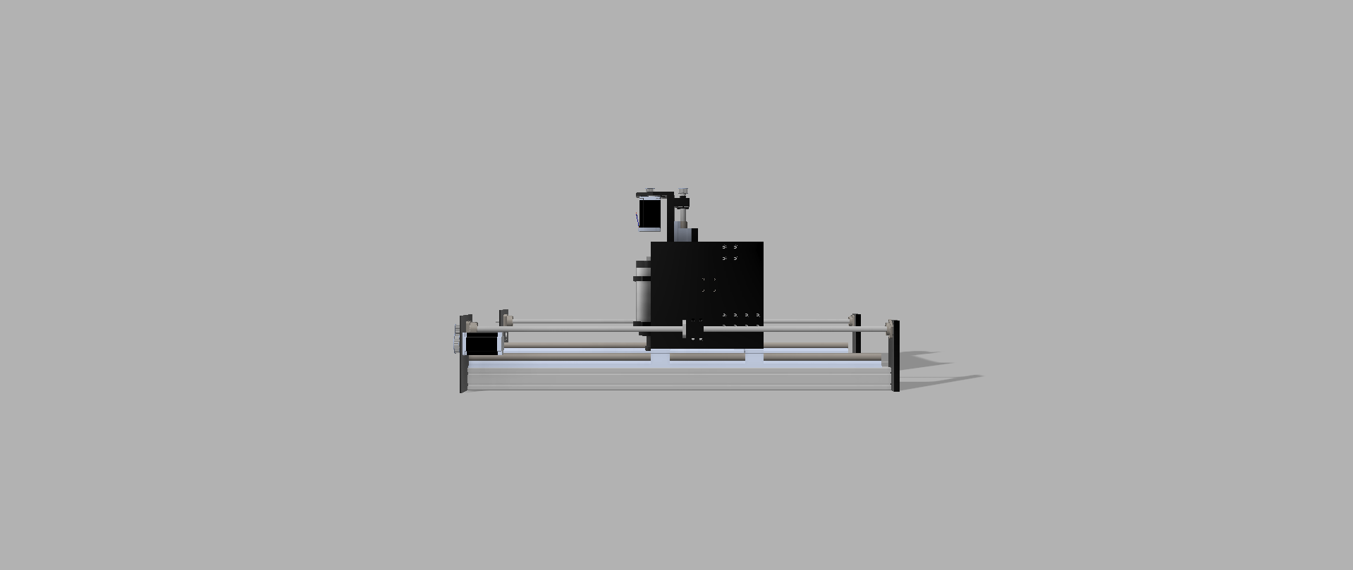

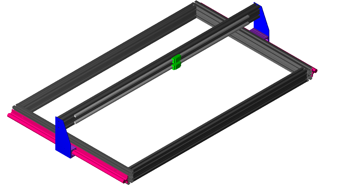

    Nice work hoppo. Any pictures or sketches of the whole design?
    KJN are excellent, I live right next to them and they have been invaluable to me ;)
    Good look with the build

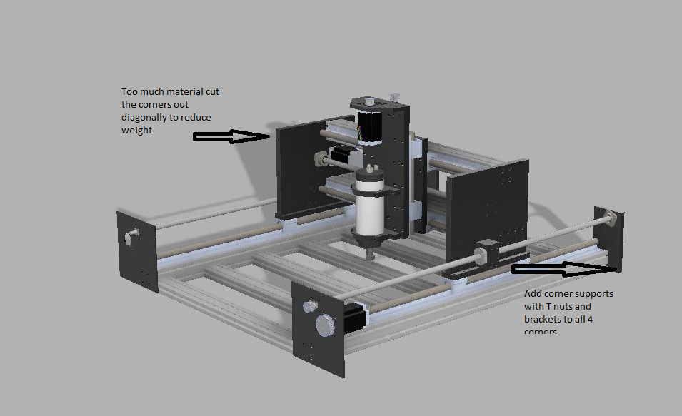

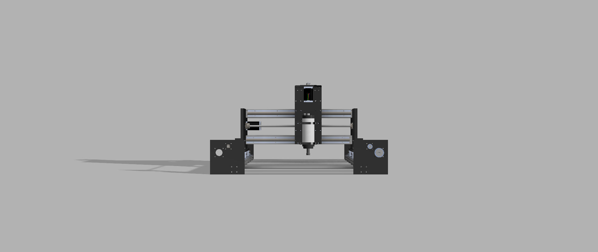

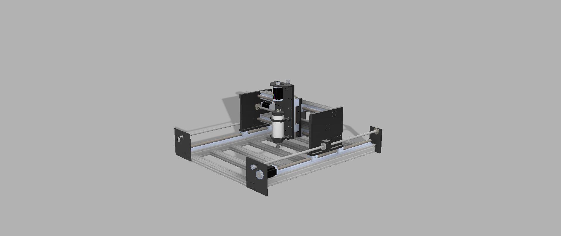

    Here are some rendered drawings of my design. Some bits are missing like the motor and pulleys on the second X axis ball screw but they are identical to the other side only mirrored so you should get the idea.
Name:	Router Mk 1.jpg
    Overall view.
Name:	Router Mk 1 Front.png
    Front view.
Name:	Router Mk 1 Side.png
    Side view.
    The hardest part of anything so far was learning the CAD software to ensure my design would work. I've been using Autodesk Fusion 360. Which is very good but I haven't really got anything to reference that against. There may well be better software out there, but Fusion 360 is free and seems to have done the job even if it runs a bit slow on my computer. Apologies for the state of the pictures in this post, they don't really show the construction too well.

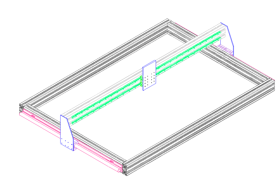

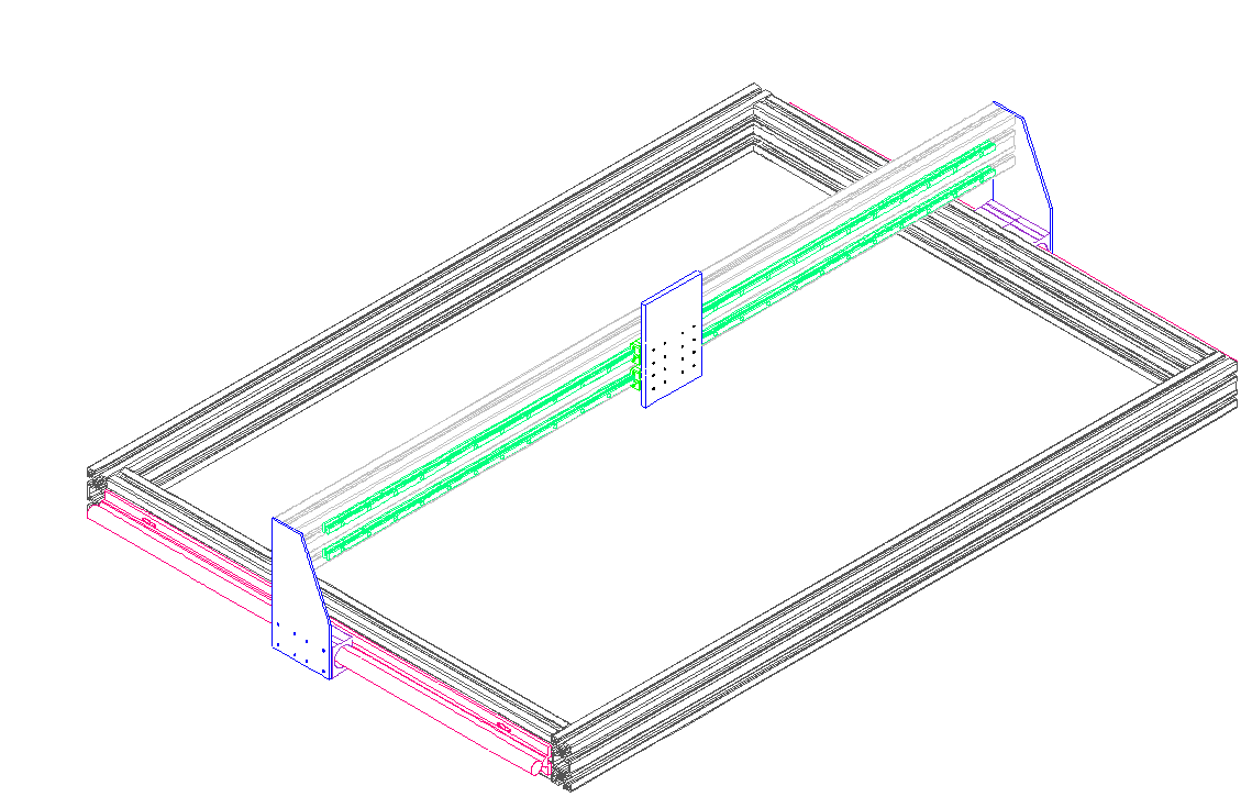

    Good luck with your build, I'm no expert but looking at your cad models 2 things springs to mind.
Name:	router build 1.png
    I am going to do things differently to you and not have the 4 corner plates, instead I'm going to bolt the supported rail to the sides of the extrusion and the ballscrew to the top and have vertical plate mounts.Click image for larger version.

    A little late now but KJN offer a drilling service as well so you can do away with the corners and bolt through the extrusion I'm going to have mine drilled AND use the corners.
    Of course the disadvantage of mine is it's direct drive via couplings.
    Hi Desertboy,
    Thanks for the comments. I did think about placing the supported rails on the side of the extrusion. The one reason that I didn't was because of the tolerances of the cutting of the aluminium profile for the Y axis. KJN quote, I think a tolerance of 0 to +2 mm. Which I thought if this was the worst case and was 2 mm over I would need to use shims. Whereas bolting to the top of the extrusion gives me a certain amount of wiggle room with the bolts in the slots to remove this tolerance if required. I'm not sure if that is best practice, it just seemed to make sense at the time I ordered the profile.
    I did also consider direct driving the ballscrews. In hindsight the best thing I could have done is got 1610 instead of 1605 ballscrews and then I would have had speed as well as torque by direct driving them, but at the time of designing I think I was more interested in the speed and hadn't really considered the potential backlash issues. I could I suppose easily convert to direct drive later if backlash becomes an issue.

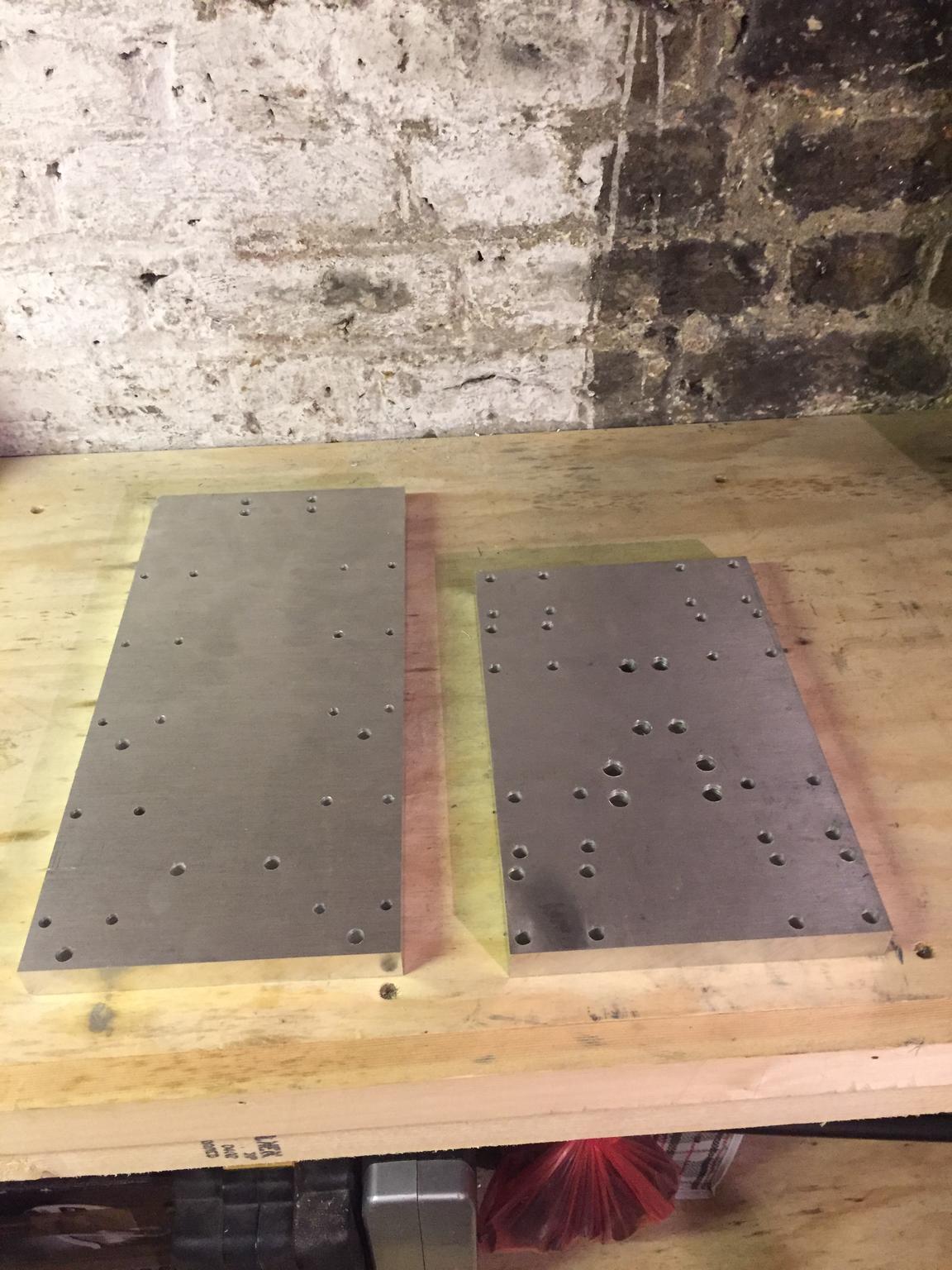

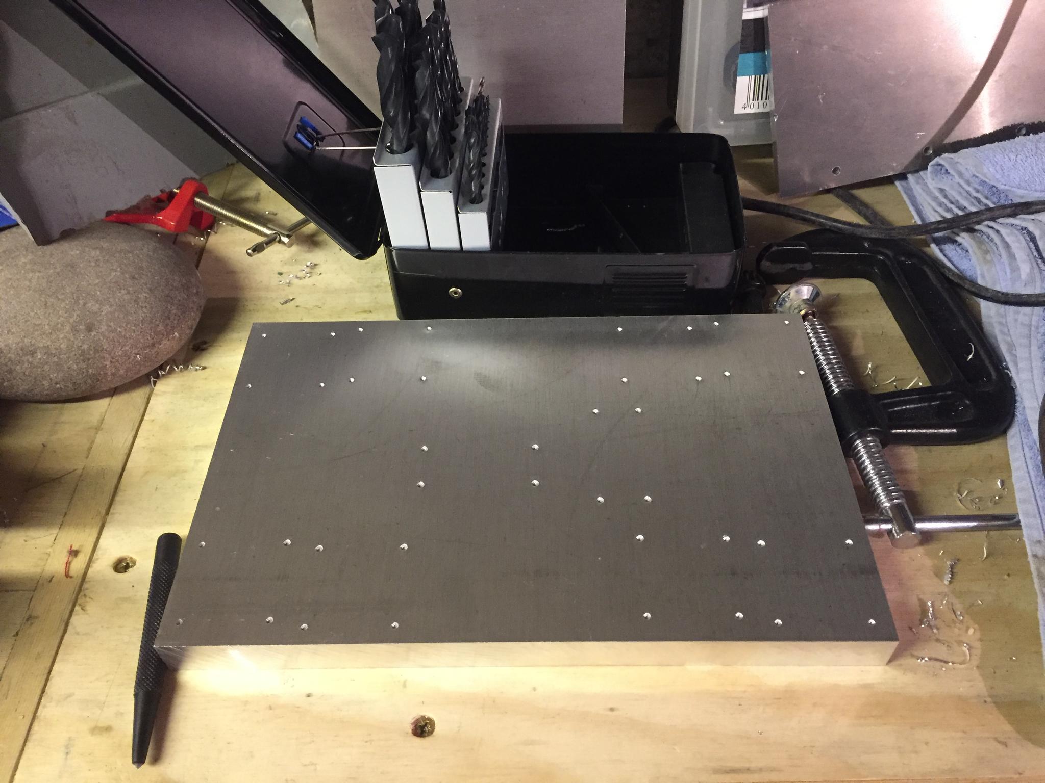

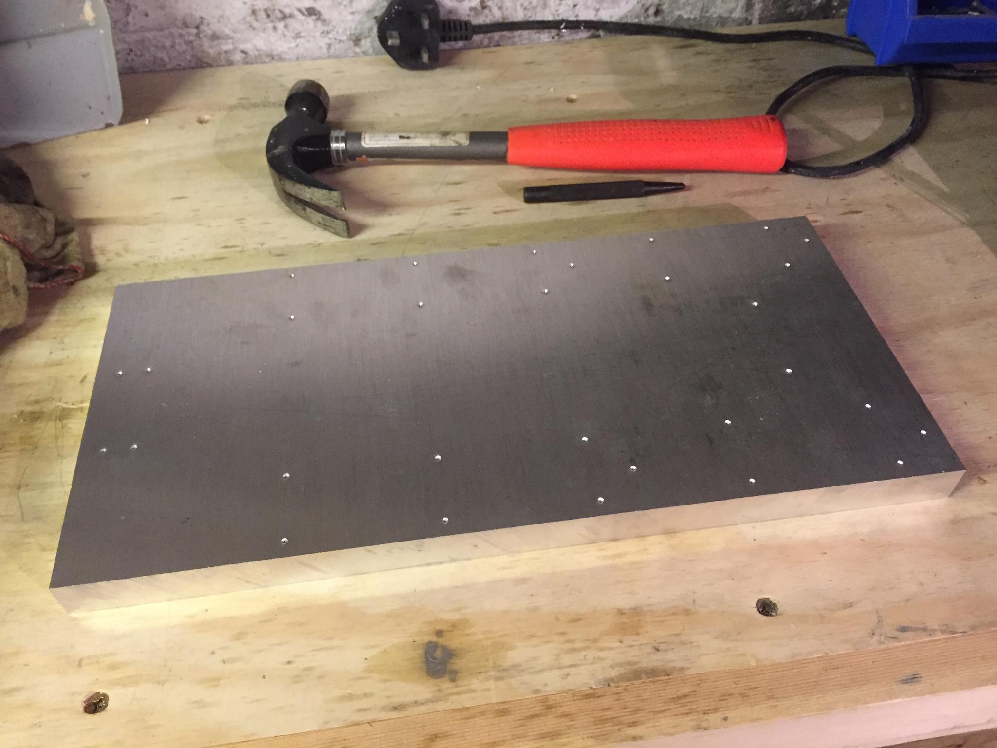

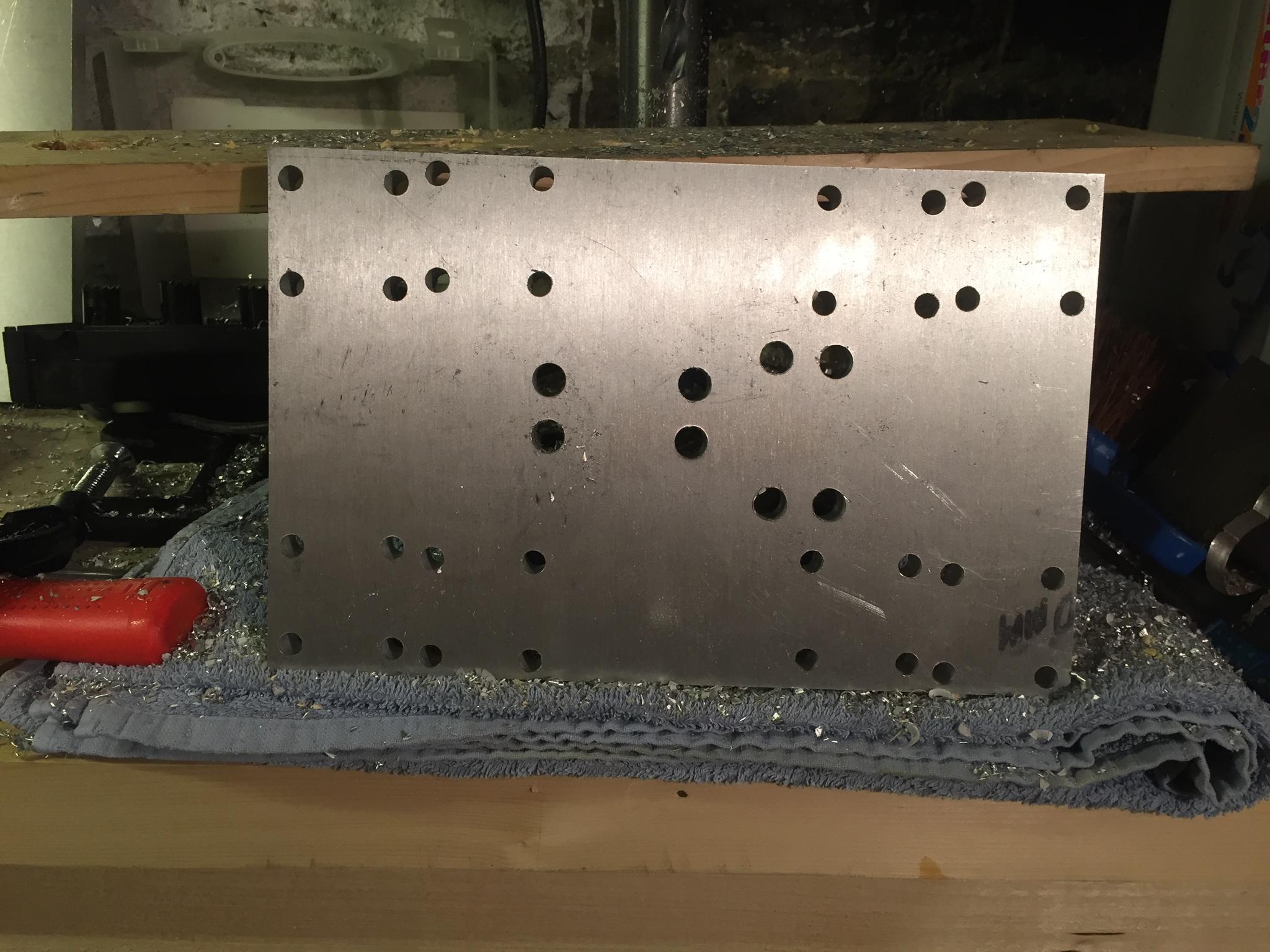

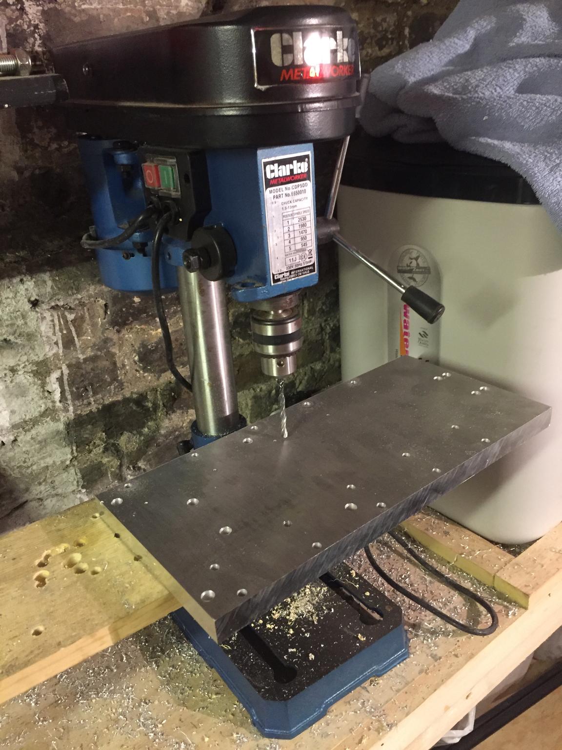

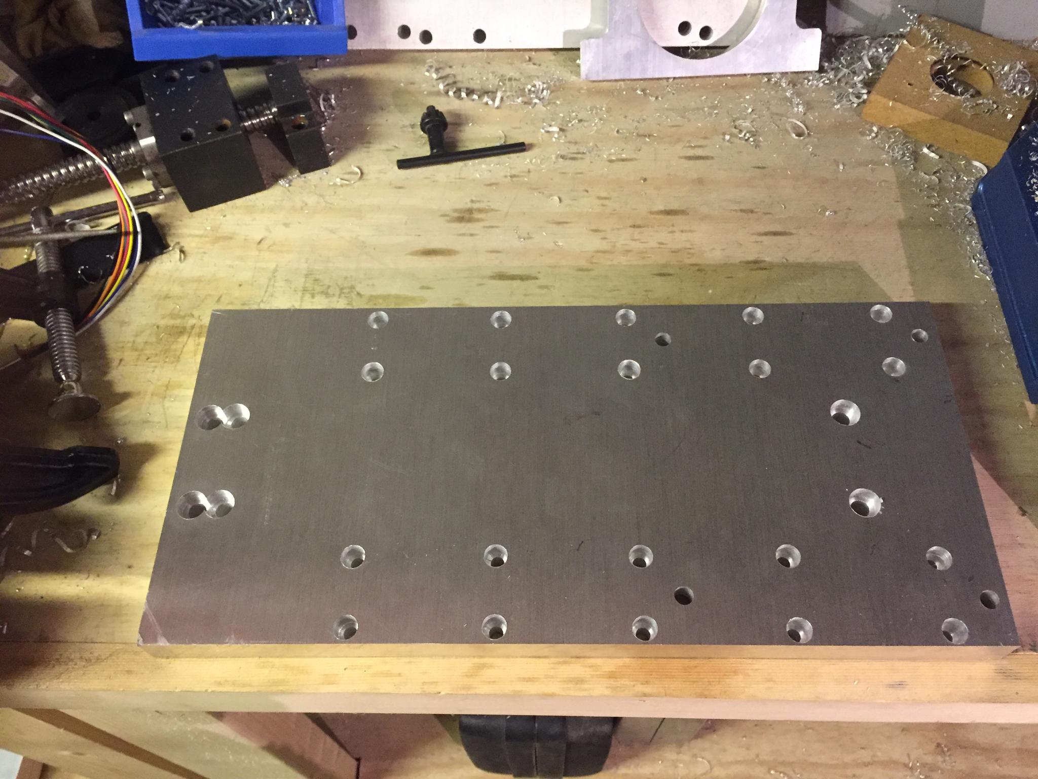

    Started construction of the Z axis front and rear plates. Armed with a hammer a center punch, a set of hss drill bits and a few counterbore bits off ebay and my trusty Clarke Bench drill this is the outcome.
    Holes all marked out on the Z axis rear panel. This is the part that will attach to two ball screws and 8 bearings.
    Drilling starts with earnest. Amazingly way easier than I thought it would be. I did use some cutting oil just in case and got a very good finish on the holes. Again as a newbie and not being too sure about my layout being particularly accurate I oversized the holes by 0.5mm to give me a little bit of wiggle room in case of alignment issues due to my possible dodgy setting out.
    Finished drilling the holes on this plate. The larger holes are to take 10mm bolts to fit to the ballscrew block. Drilled at 11mm diameter.
    The process begins again for the front plate that will hold the ball screw bearing blocks, spindle mounts and the supported rails.
    More drilling.

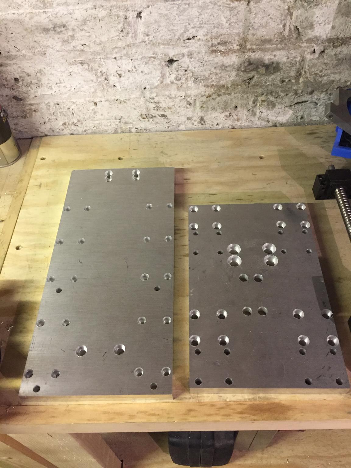

    The two plates with all the holes drilled. All look to be in the right place. I'm fairly happy with how fairly straightforward this was. It was working with aluminum that was most unsure about as I have no real experience working with it. It's just like drilling wood but smoother!
    Countersinking of the holes to take the captive bolts that will hold the whole thing together.
    The two finished plates, with all the holes in the right place and more importantly all the conterbores on the correct sides. There was a moment of panic when I thought I'd countersunk the larger holes on the wrong side but was relieved when checking the drawings that all was in fact correct. I did get some quite serious chatter whilst countersinking the larger holes. These are 18mm from memory and I had the bench drill on the slowest speed which is about 500rpm. I reckon it would have been better if it could have been slowed down a bit more. Anyway with plenty of cutting oil and only a little ringing in my ears afterwards I think I got away with it.
    I hope I didn't 'bore' you all to death with a post that mainly 'revolves' around drilling holes. My wife thinks I'm mental having spent a day in the cellar doing nothing but drilling. Personally I loved it and am feeling quite chuffed.
    I hope you found this post useful.
    Cheers.
