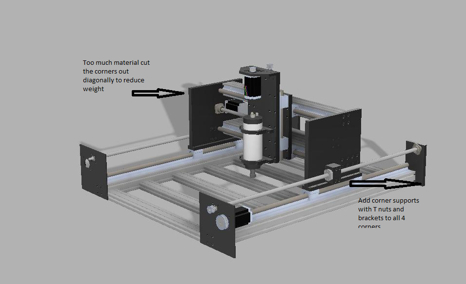

    Nice work hoppo. Any pictures or sketches of the whole design?

    Here are some rendered drawings of my design. Some bits are missing like the motor and pulleys on the second X axis ball screw but they are identical to the other side only mirrored so you should get the idea.

    The hardest part of anything so far was learning the CAD software to ensure my design would work. I've been using Autodesk Fusion 360. Which is very good but I haven't really got anything to reference that against. There may well be better software out there, but Fusion 360 is free and seems to have done the job even if it runs a bit slow on my computer. Apologies for the state of the pictures in this post, they don't really show the construction too well.

    Good luck with your build, I'm no expert but looking at your cad models 2 things springs to mind.
Name:	router build 1.png

    I am going to do things differently to you and not have the 4 corner plates, instead I'm going to bolt the supported rail to the sides of the extrusion and the ballscrew to the top and have vertical plate mounts.Click image for larger version.

    Of course the disadvantage of mine is it's direct drive via couplings.
    A little late now but KJN offer a drilling service as well so you can do away with the corners and bolt through the extrusion I'm going to have mine drilled AND use the corners.
