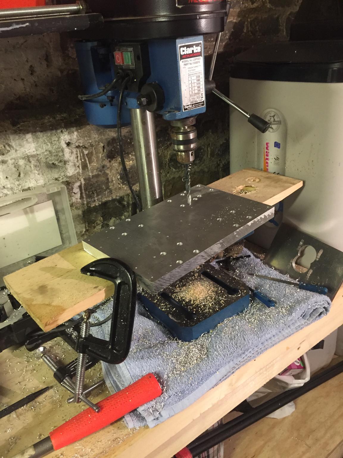

    Started construction of the Z axis front and rear plates. Armed with a hammer a center punch, a set of hss drill bits and a few counterbore bits off ebay and my trusty Clarke Bench drill this is the outcome.

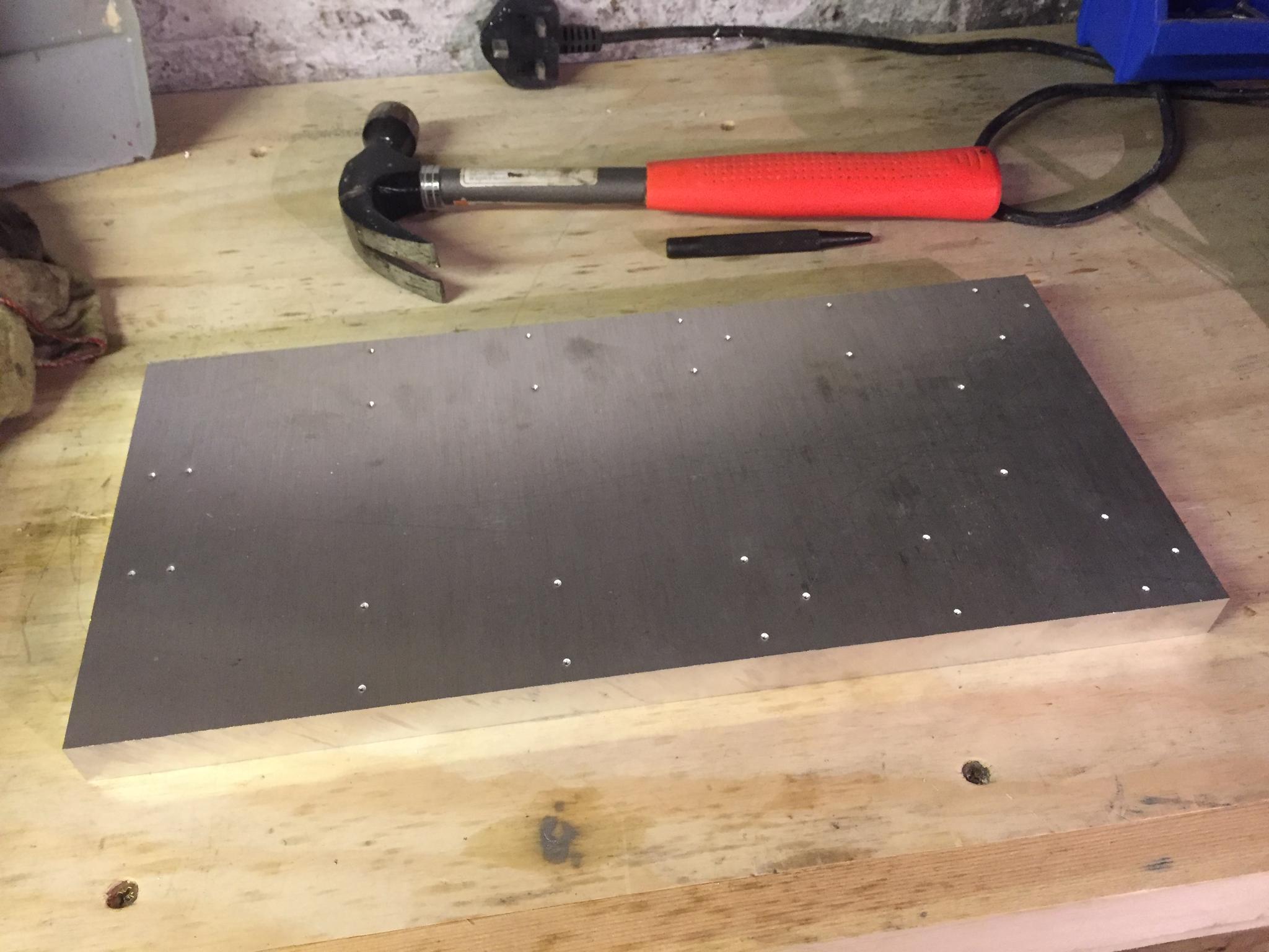

    Holes all marked out on the Z axis rear panel. This is the part that will attach to two ball screws and 8 bearings.

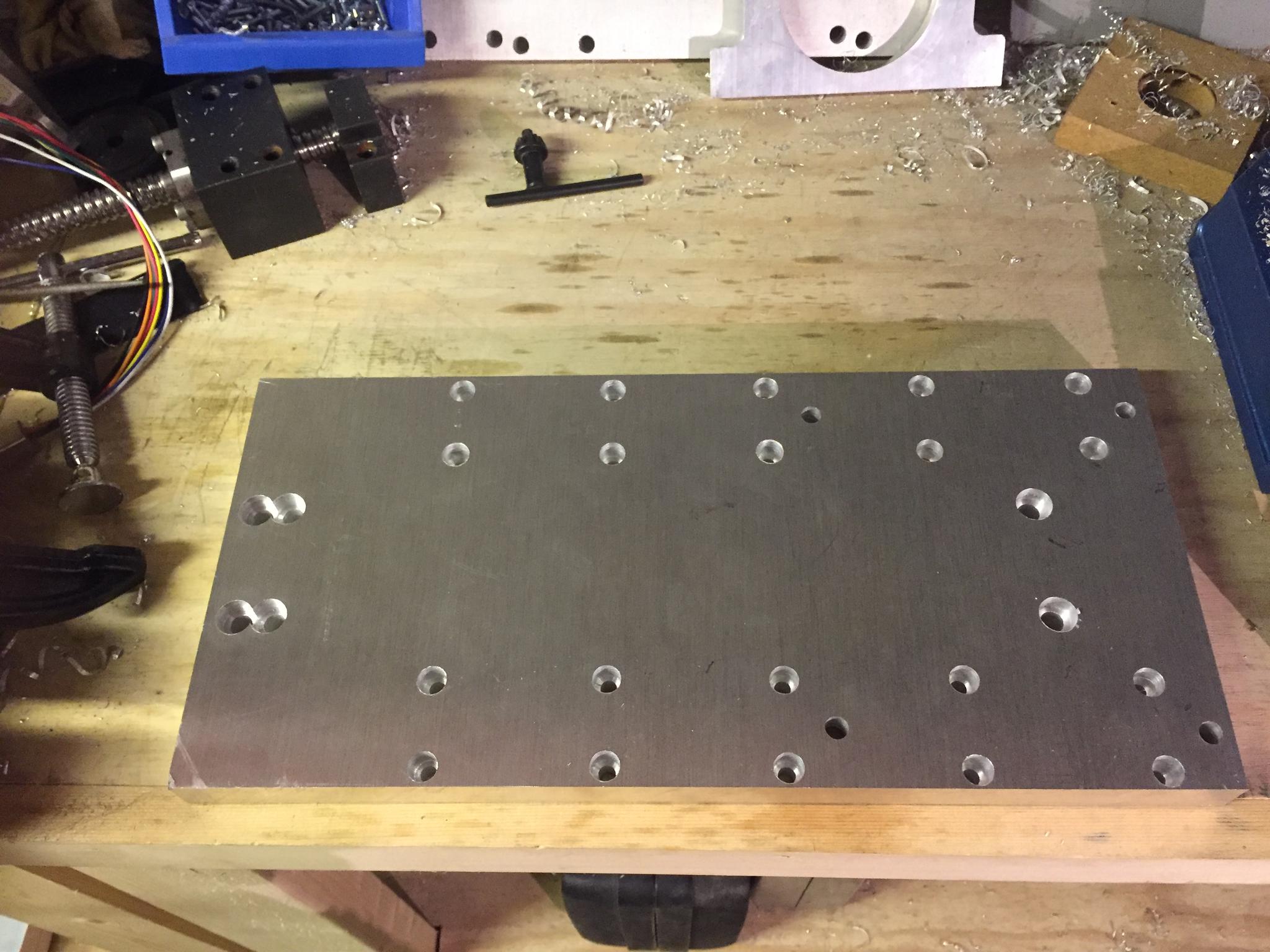

    Drilling starts with earnest. Amazingly way easier than I thought it would be. I did use some cutting oil just in case and got a very good finish on the holes. Again as a newbie and not being too sure about my layout being particularly accurate I oversized the holes by 0.5mm to give me a little bit of wiggle room in case of alignment issues due to my possible dodgy setting out.
    Finished drilling the holes on this plate. The larger holes are to take 10mm bolts to fit to the ballscrew block. Drilled at 11mm diameter.

    The two plates with all the holes drilled. All look to be in the right place. I'm fairly happy with how fairly straightforward this was. It was working with aluminum that was most unsure about as I have no real experience working with it. It's just like drilling wood but smoother!
