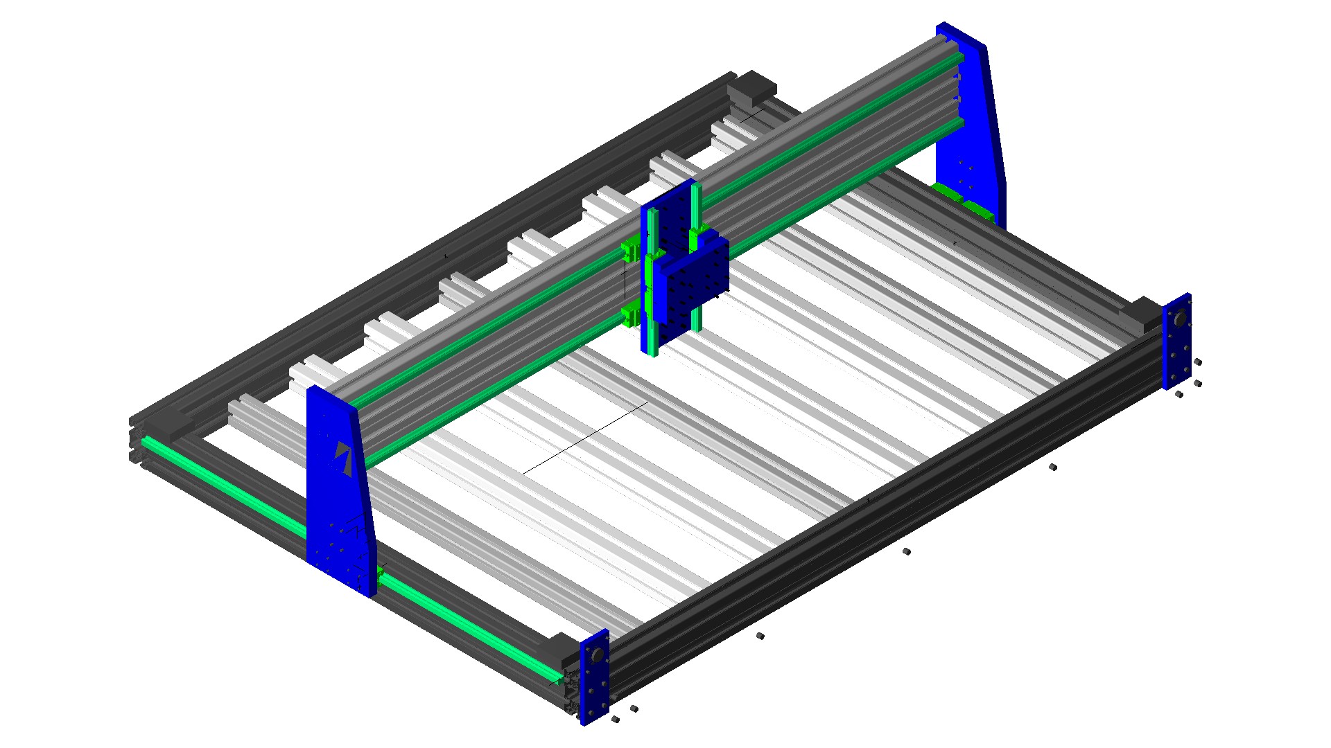

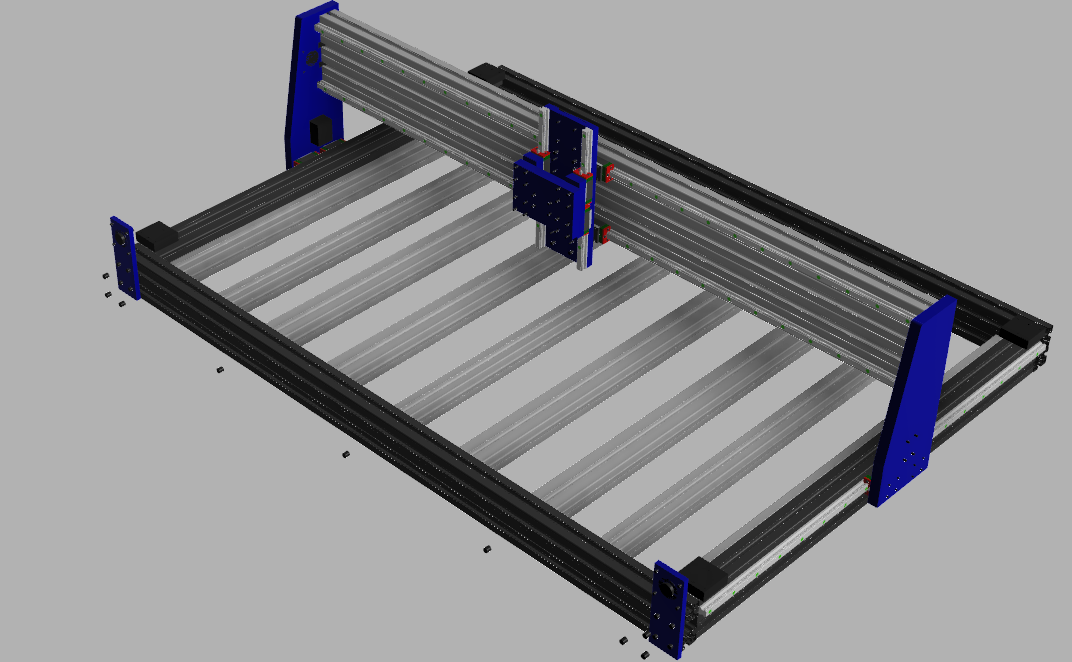

    Fusion's rendering is better as well
    Turbocad
Name:	frame zaxis19.jpg
    Fusion 360

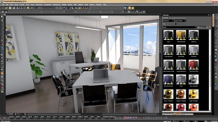

    These are standard setting you can get excellent renders out of turbocad but it's a lot more hassle.
    this a properly setup turbocad render
