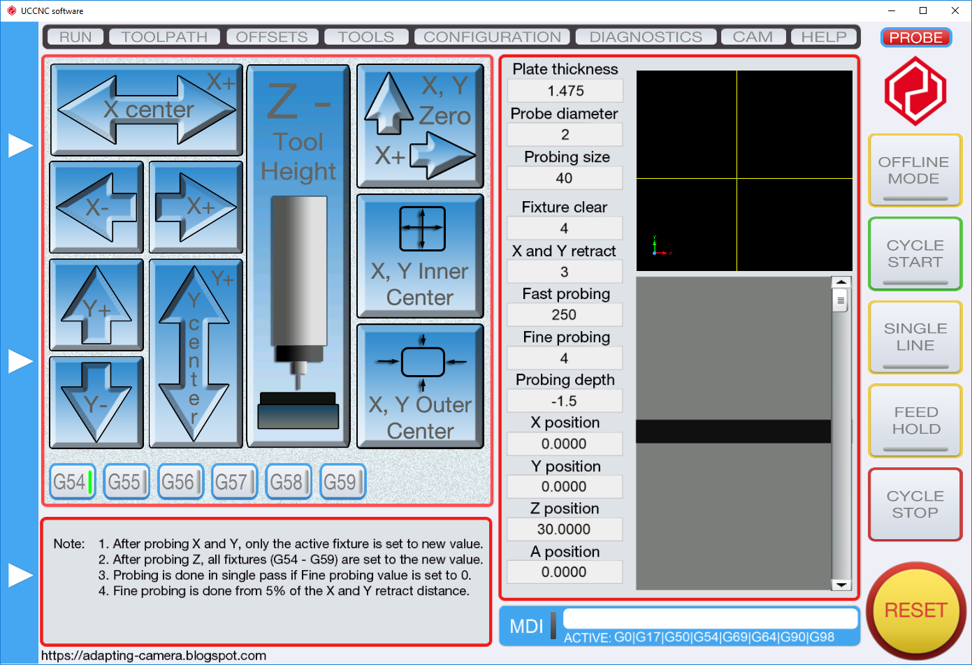

    The axis parallel with your belly is the X. Positive X movement is from left to right.
    The axis moving away from you is the Y. Positive Y is movement is from you, negative is towards you.
    This seems to work with every CAD, CAM software as well as Mach3 and UCCNC screens I used.
Name:	Probe screen.jpg
