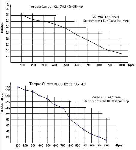

    My specs below...
    If I reduce the microstepping amount, say from 3200 steps/rev to 1600 or 800 steps/rev, that will increase resolution, but will it provide any greater torque using the AM882?
    100 RPM 190 N cm 1000mm/min
    300 RPM 174 N cm 91% 3000mm/min
    500 RPM 150 N cm 80% 5000mm/min
    700 RPM 120 N cm 63% 7000mm/min
    750 RPM 105 N cm 55% 7500mm/min
    800 RPM 85 N cm 45% 8000mm/min
    RAPIDS / ACCEL SETTINGS
    X 8000, Accel 1200, single motor ~30 kgs....... 10mm pitch
    Y 7500, Accel 1000, dual motor ~ 60-70kgs..... 10mm pitch
    Z 3500, Accel 1200, single motor ~ 15-20 kgs.. 5mm pitch
    Bottom Chart is my motor
Name:	Torque curve KL23H2100-35-4B.png

    Changing the micro-stepping setting won't have any practical effect on torque at the motor when moving.

    Yeah they have stall detection, but it only operates when / if my motors are above 3000 mm/min. And due to my cut rate being 5000, then I can summize, that the error must be occuring at lower speed prior to stall detect kicking in, IE on decel / acceleration.
