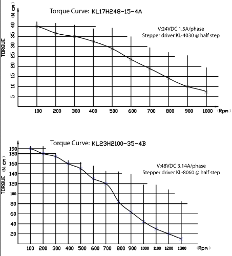

    If I reduce the microstepping amount, say from 3200 steps/rev to 1600 or 800 steps/rev, that will increase resolution, but will it provide any greater torque using the AM882?
    100 RPM 190 N cm 1000mm/min
    300 RPM 174 N cm 91% 3000mm/min
    500 RPM 150 N cm 80% 5000mm/min
    700 RPM 120 N cm 63% 7000mm/min
    750 RPM 105 N cm 55% 7500mm/min
    800 RPM 85 N cm 45% 8000mm/min
    RAPIDS / ACCEL SETTINGS
    X 8000, Accel 1200, single motor ~30 kgs....... 10mm pitch
    Y 7500, Accel 1000, dual motor ~ 60-70kgs..... 10mm pitch
    Z 3500, Accel 1200, single motor ~ 15-20 kgs.. 5mm pitch
    Bottom Chart is my motor
Name:	Torque curve KL23H2100-35-4B.png

    I'm not an expert in this area, and I only have limited experience based on my own machine, so please take that into account in whatever I say here! However, I have spent some time kicking around figures for my machine, so these numbers aren't just plucked out of the air.
    First - microstepping. You currently have 10/3200 mm = 3um resolution. I'm using 5mm pitch with 1600 usteps, giving the same resolution. This is way better resolution than is needed (for woodworking, at least) and probably better than the backlash in your ballscrews, unless you are using rather better quality screws than most of us! I use x8 microstepping as a balance between torque and smoothness; it seems to be generally accepted that this is a good target figure as higher microstep ratios (such as you are using) cause torque to fall off; lower ratios give a rougher drive. I once played with a machine with no microstepping configured and it sounded like marbles in a cement mixer. I reconfigured to x8 and it was much, much better. I suspect that if you go to 1600 ustep/rev you might get better torque and so less chance of stalling.
    My gantry weighs, at a guess (never weighed it, but I know what it felt like lifting it on and off while building the machine, and then it has the Z axis assembly and spindle motor added) around 60kg. That is driven by two 3Nm NEMA 23 steppers so roughly speaking each motor is driving about the same mass as your motor. You appear to be using nominal 1.9Nm motors, so they are a bit down in torque compared with mine. At the same time, you are running at about twice the speed (my rapid max is 4500mm/min as I get stalling problems above this) so have more drag from guide rails (although I realise that your problems do not happen at higher speeds so this is probably not too relevant) but also using around twice the acceleration figure. My machine runs with acceleration set to 600 (whatever units that is in). According to the little graph in the Mach3 config page, that gives 0-full speed in about 0.15s. You are trying to accelerate at twice this rate, with higher pitch ballscrews which means twice the torque required, with lower torque motors. Someone might well argue that my machine is conservatively configured and they might be right, but I do a fair bit of fine 3D machining and I worry as much as anything about things like pulley-ballscrew fixings handling this amount of torque with a lot of axis reversals and coming loose.
    Your other axis (we have different conventions re X and Y!) has similar loads, but lower speed and acceleration. Is there a reason for this? Based on testing, gut feel, or inspired guesswork? (I used the last of these with a bit of testing to confirm, BTW...)

    Yeah they have stall detection, but it only operates when / if my motors are above 3000 mm/min. And due to my cut rate being 5000, then I can summize, that the error must be occuring at lower speed prior to stall detect kicking in, IE on decel / acceleration.
    I came up with my numbers by trial and error, finding the max unloaded speed with low acceleration, then the max acceleration to low speed with lots of reversals. , and setting a % of this, like 50 as the max machine settings.
    Did some more testing to check the acceleration settings - Checks performed at 8000 mm/min
    Y axis failed at 1100 mm/s/s Now set at 550
    X axis failed at 1600 mm/s/s Now set at 800. ( this is the axis that jammed, but was also doing most of the work at the time )
