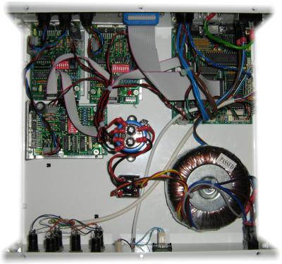

    Hi Dave
    just looked at Conqueror Design website
    if this is what you have
    going by the width of the ribbon cable that is daisy chained between the driver boards
    I expect all the step and direction signals go to each driver board
    the pictures resolution is not good enough to see but I expect
    each board has links to select the correct signals for that axis
    John

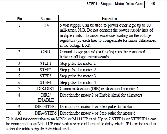

    Yeah that's what I have. According to the information in this link under step1(R4);
    http://www.eaziform.co.uk/files/CNCComps.pdf
    There is only one wire which contains all the direction signals but they are selected at the board. So if I substitute the driver then I somehow need the individual part of the direction signal for that driver
    Any ideas?
    David
    Hi Dave
    if I have read this correctly
Name:	step1 stepper driver   step & dir inputs.jpg
    it looks like for up to 4 drivers
    you can have separate step & direction signals to each driver
    for more axis they must multiplex the direction signals on pin 7
    and store it the appropriate driver board until you need to change that axis direction
    I would need to see the detailed data sheet for a stepper 1 driver board or
    study a board to trace the direction signal path
    I would expect the rest of the circuit to follow the data sheet for the stepper driver IC's used
    John

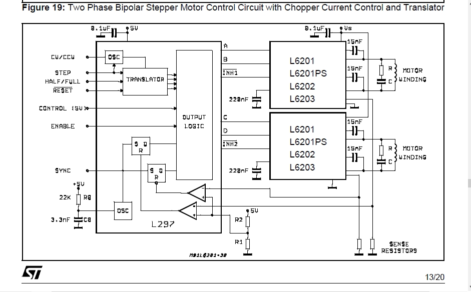

    Hi Dave
    going by what looks like two seperate H bridges on your stepper drivers
    I guess instead of the usual L297 + L298 chip set
    your stepper drivers use a L297 & two L6203 H bridges
Name:	L297  L6203.jpg
    John
