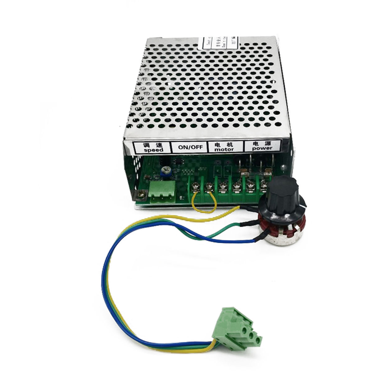

    Cheers mate, on this motor it says there is a speed governor? do I simply disregard this and wire the motor in as the old motor was?
    The speed governor is this unit:
    You could disregard it and just wire the motor as the present one, but if the power supply, or the controller box you have in your machine is not capable of handling this motor then you will need this box. My guess is that the controller box in your kit not going to be enough, so I think you better off using this box.
    BTW, you will not need the spindle holder, so you could try to contact the seller and see if he can send the motor without the spindle holder or you could try to find another motor without the holder. I just posted the link as an example to show what you may use without modification.
