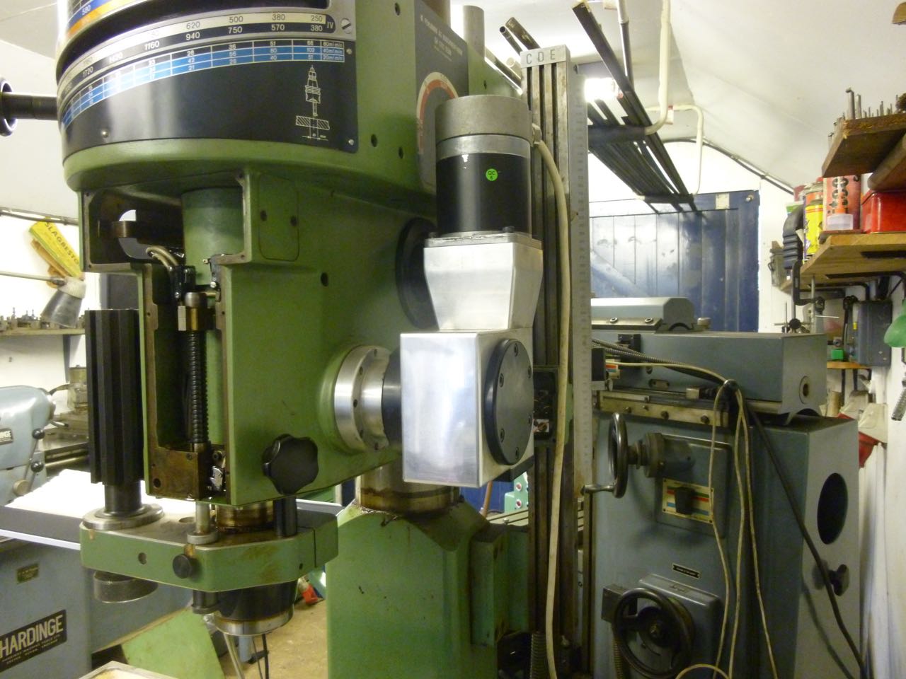

  7. #27
    How about a pic of the machine or a link model etc.
    I'll take a couple of snaps today - after a tidy-up!
  8. #28
    A few pics - I'll add a video later (probably start a new thread):
