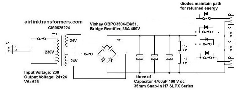

    you can have fuses in the DC suppy wiring to stepper drivers provided you have diodes wired across the fuse holder to maintain the path for the returned energy

    John,
    What's the formula to workout what size Diodes should be used ?
    I find this one intresting because surly the diodes need to be rated such that they dont negate the use of a fuse in the first instance but can also still handle what may get thrown at them?
    Any clarification is appreciated.
  7. #36
    John,
    Lee the diodes will not conduct in normal use but if the fuse does blow and the motors is decelerating it would conduct to dump the BEMF into the caps and it would only happen for a few m/secs a diode handling 1-2A would probably be ok
  8. #37
    Hi Lee
    Clive is correct , when a fuse blows the diode will only conduct
    while the motor is generating a higher voltage than the power supplies output
    just because its what I have in my spares box I would use
    a 1N5408 - 1000V PIV 3A diode
    ( I think I used them to rectify the 250V mains )
    with a 70 to 80V DC power supply a 1N5401 - PIV 100V 3A diode would be OK
    John

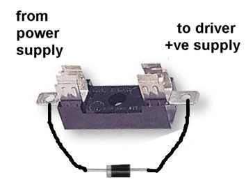

    How would you implement this in practice? Solder the diode across the ferrules on the cartridge (I think it would fit back into the holder)?
  10. #39
    Hi Joe
    I would solder the diode across the fuseholders terminals
