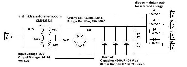

    Have you read the post? The diode is to go across the DC fuse output of the power supply to the drivers to give a circuit for the bemf to be able to be dumped into the caps. in case the fuse blows

  6. #46
    Hi Agathon
    the circuit from post 34
Name:	power supply output fuses.jpg
    when every thing is working
    the fuse short circuits the diode its connected to
    so the power supplies DC output is connected to the driver
    when a fuse fails power from the DC power supply is blocked
    and now the diode provides a path any for excessive voltage
    generated by the motor to be returned to the power supplies reservoir capacitor(s) and used by any other axis driver
    if the FET's have become short circuit then a large fault current will blow the drivers supply fuse and the motor will be short circuited so no generated current can be returned via the diode

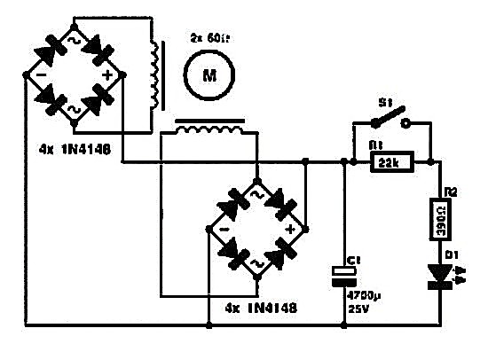

    the diodes form a bridge rectifier that converts the AC voltage generated in a mechanicaly driven motor into DC that adds to the external DC supply that powers the stepper driver
    John
    PS
    as an aside
    one of many DIY hand cranked torches using a stepper motor as a generator
    https://www.eeweb.com/blog/extreme_c...otor-generator
