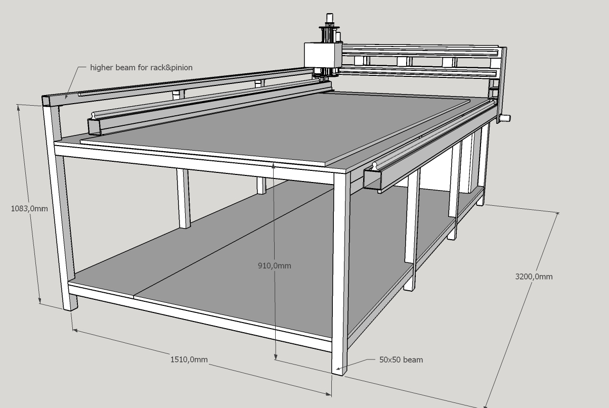

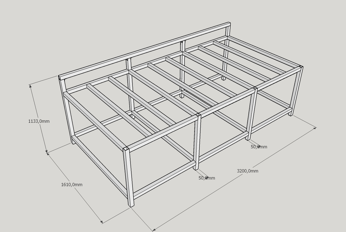

    my cnc is only for routing parts drilling etc the max thicknes is 50 mm MDF for shelves and cabinets 18 mm thick.
    i know everything needs to be strong but if i weld the frame and bolt it to the ground is it not strong enough?
    i was thinking making the frame like this

    I would add some triangulation trusses to the box frames - stop it twisting etc.
    If you were really good at carpentry there is no reason the base could not be made from timber, it would mean very tight joints and good design but the forces to resist for machining wood are not massive so i see no reason it could not be done. Cheaper in wood? I doubt it? Easier to build - not for me as i dislike wood and like metal but for a carpenter???
    Anyways, that frame needs triangulation or it will wobble each time the spindle changes direction rapidly.
  8. #57
    Well a construction wooden beam is 68mmx38mm and kost about 1€ per meter
    steel 50x50x3 kost about 3 to 4 euro a meter
    so it will be a lot cheaper but jes then i would make it with haf lap joist and srew en glue everything together
    everything thats steel will be bolted trough the wood .
    and triangulation trusses in both way's?
  9. #58
    Quote Originally Posted by pet30 View Post
    Definitely - the frame has to resist the thrust created by the spindle changing direction in all directions so a good sturdy base is essential. Downwards it needs to resist the weight of the material plus the force of the drill or tool etc, no sagging or spring so again, a good firm base is needed.

    Without triangulation if you use min 80x80x3. Otherwise as others said.
    Forget about "wood" and a "machine" in one sentence, "machine" and "steel" go better.
