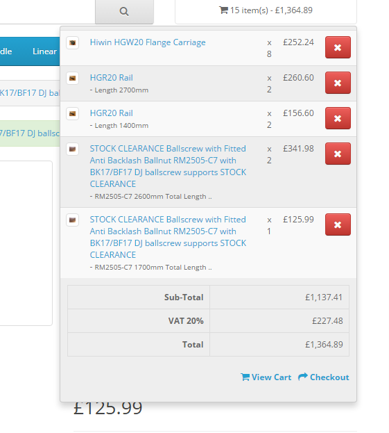

    I'm planning an 8*4 machine next for wood only and I was going to use SBR25 and I'm sure it would be very nice but the price of HIWIN 25mm from cnc4you (About 50% more) means I'll just go with 25mm Hiwin on X&Y and 20mm for the Z.
    I costed it at ~£1500 delivered from cnc4you for
    2*2.7m HIWIN
    2*1.6m HIWIN
    2 * 2005 2.6m ballscrews with fittings
    1* 2005 1.6m ballscrew with fittings
    but I think I would want to fit a minimum 2510 (Or 2520) ballscrew for the gantry and R&P for the long axis (So I can do a dual gantry, independent drive).
    R&P gets a bad rap but I've seen some very accurate setups out there certainly on par with the C7 ballscrews I would buy and with ballscrew mapping I'm sure well within any tolerances I would ever need with such a machine.

  8. #27
    Quote Originally Posted by pet30 View Post
    Very interesting
    https://www.youtube.com/watch?v=fwbkWM0mWfs
    what are your opinions for this type of linair rails? could i use them
    my budget was about 2000€ but i think i will need a lot more.
    Looks a lot better than makerslide but still not proper rail! If you want actual production you need to expand you budget
    I think if you double the budget you could build a very decent machine
