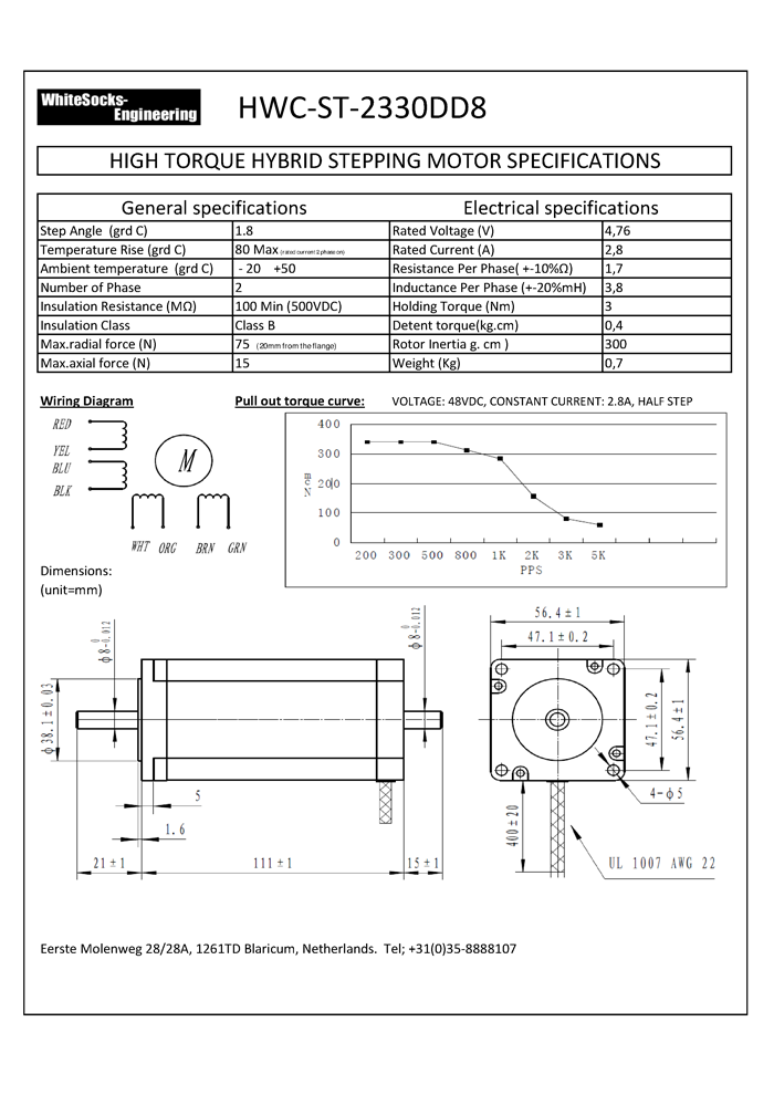

    could this one work ? Click image for larger version.

  8. #67
    Quote Originally Posted by pet30 View Post
    it could but is not the ideal. I pointed you the previous message to the ideal. Building the CNc you can make like 500 mistakes. When you are not sure which, what why, just follow the recommendations :-) or look more carefully into the data. And when you dont know what it means, follow the ...
