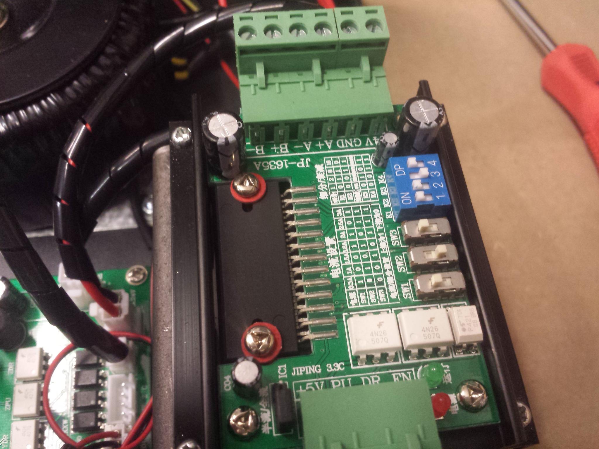

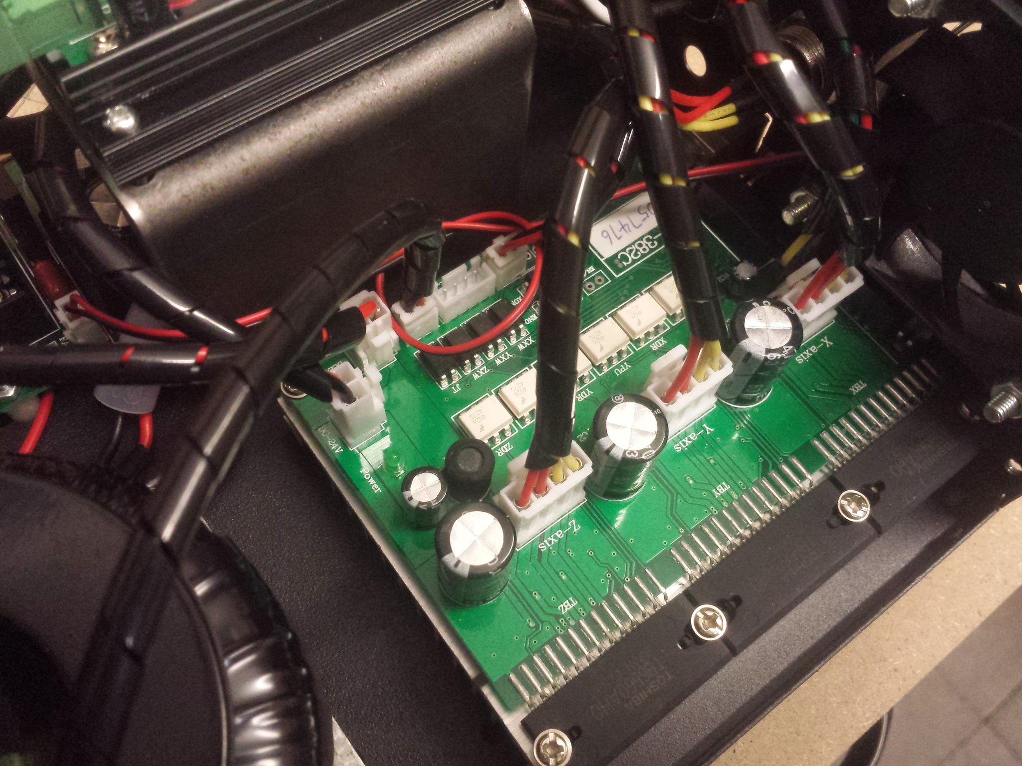

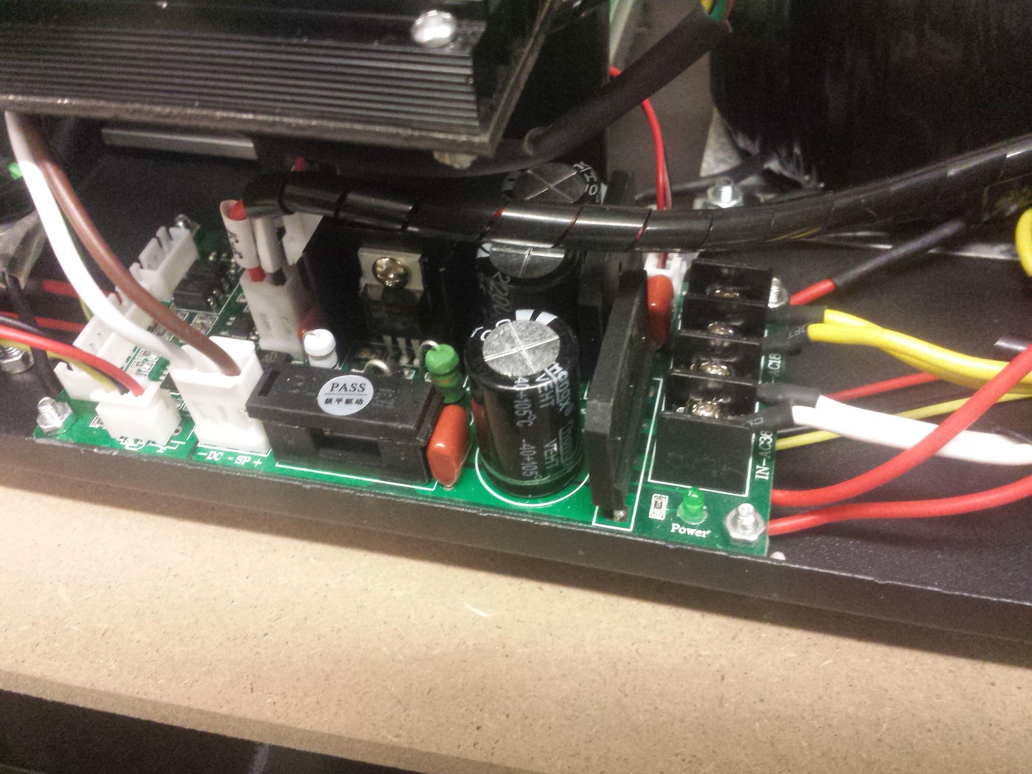

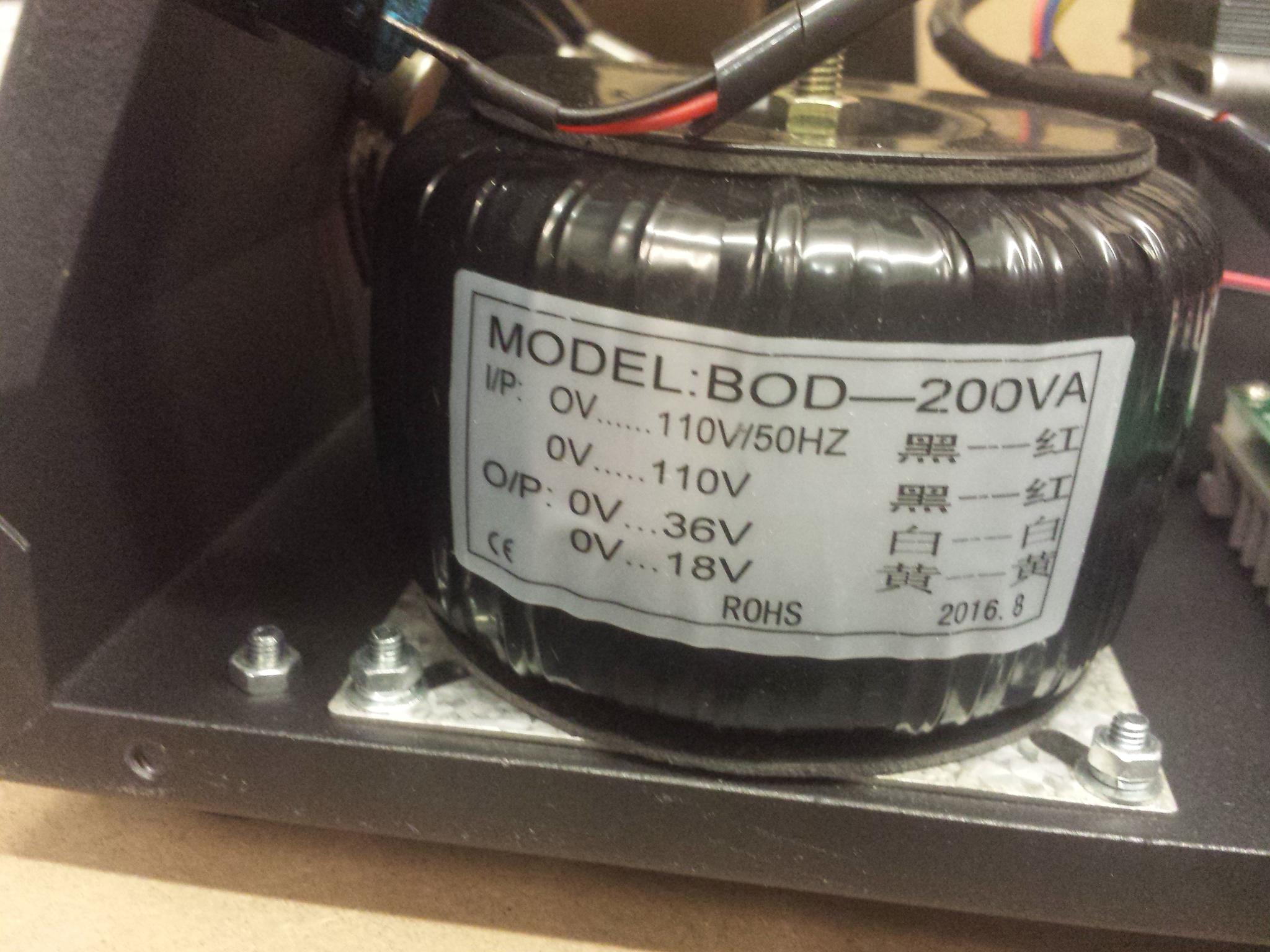

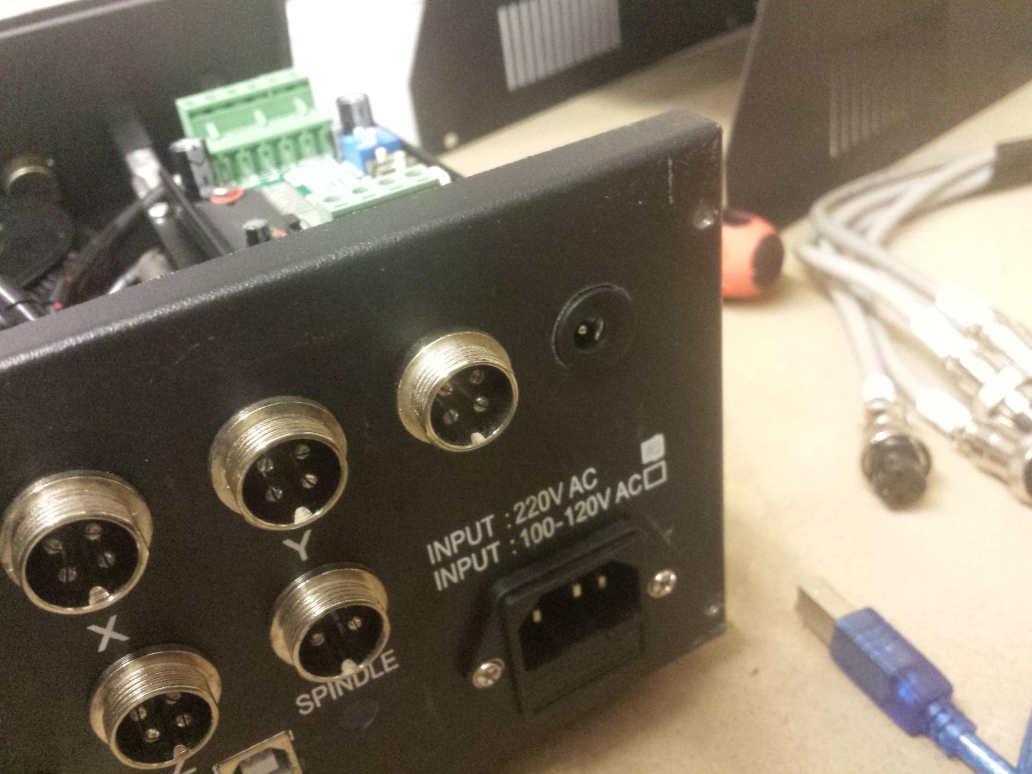

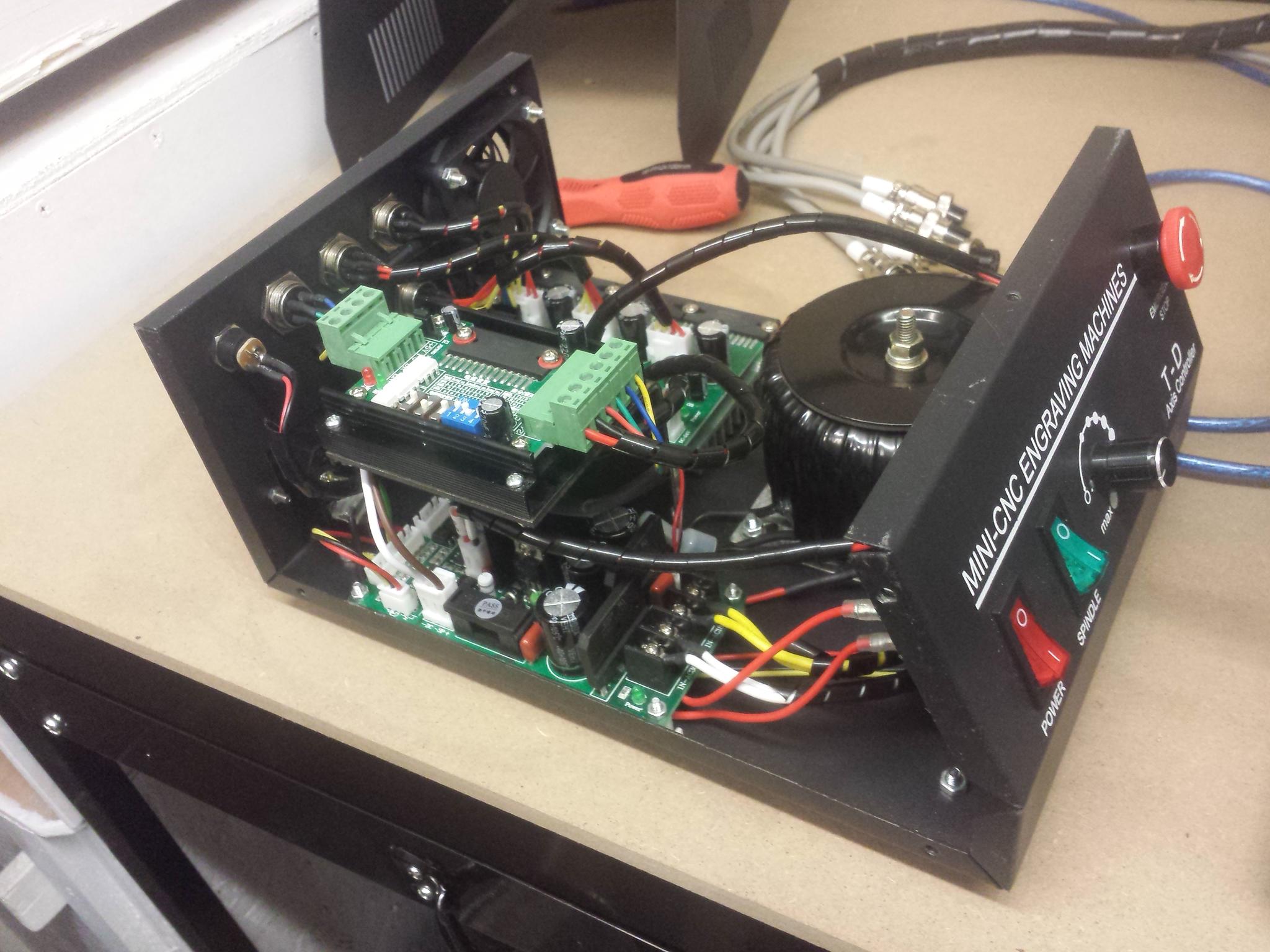

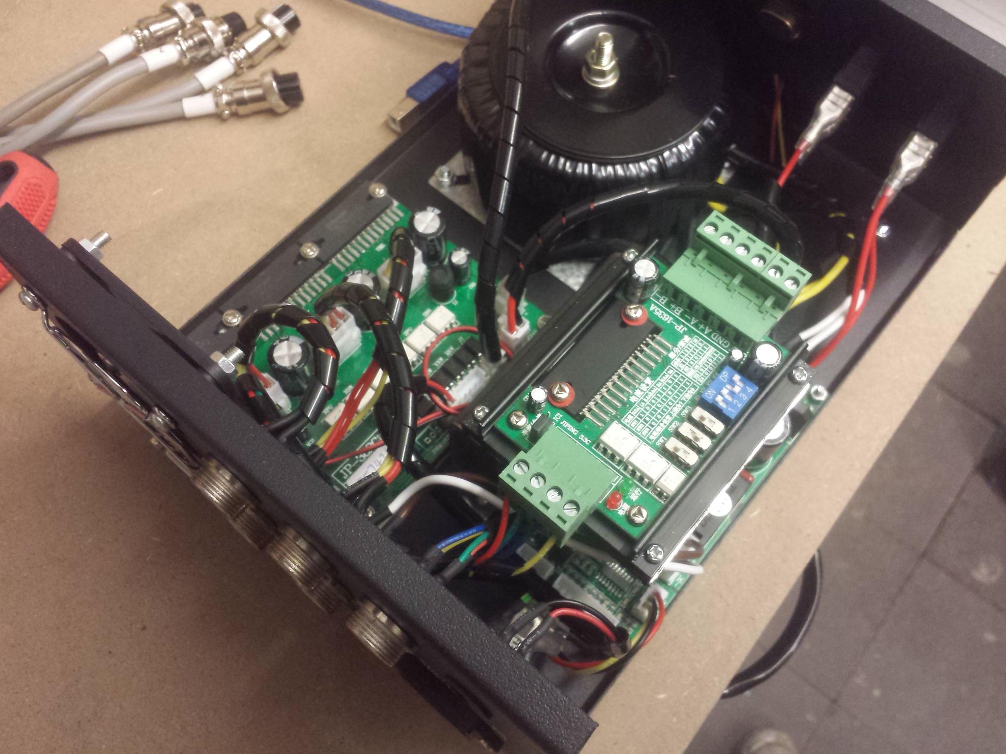

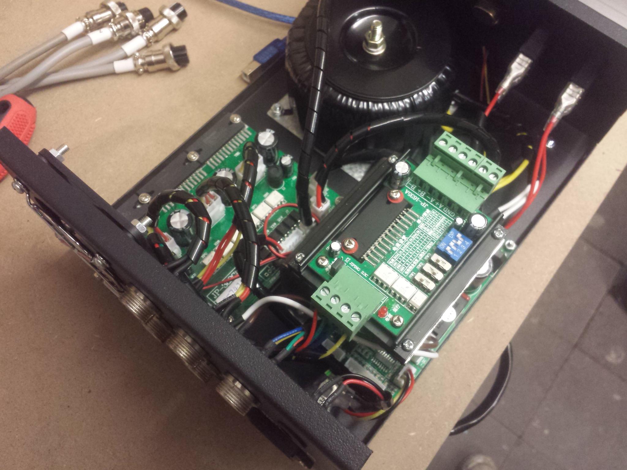

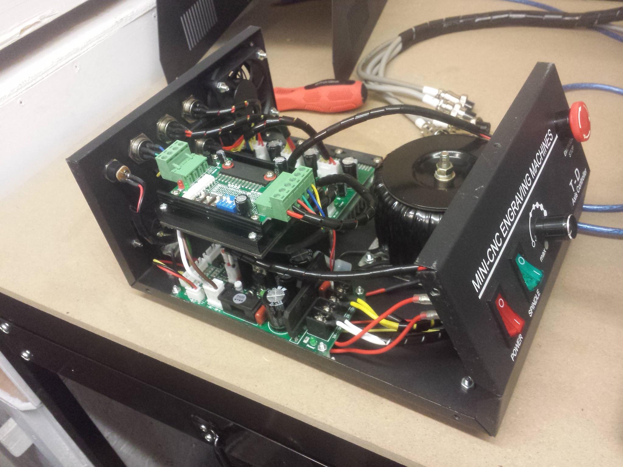

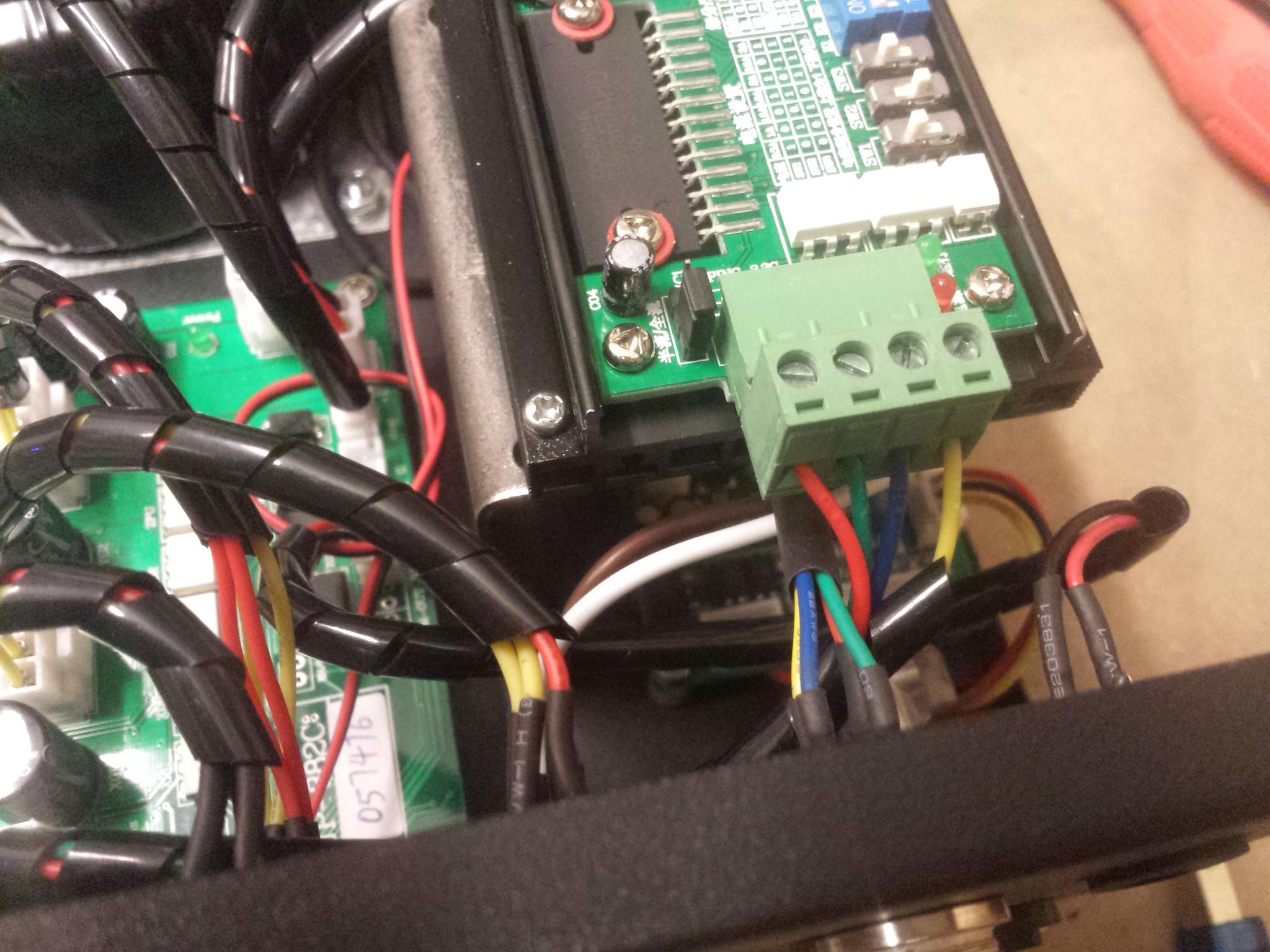

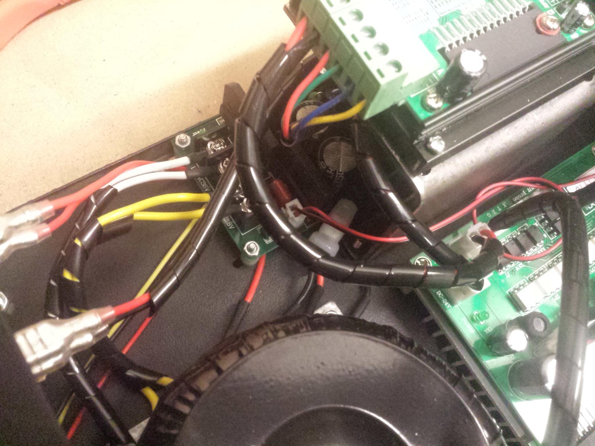

  1. I have purchased some small limit switches and was wondering how to go about installing/wiring them into my setup. Here are some pics of the insides of my control box

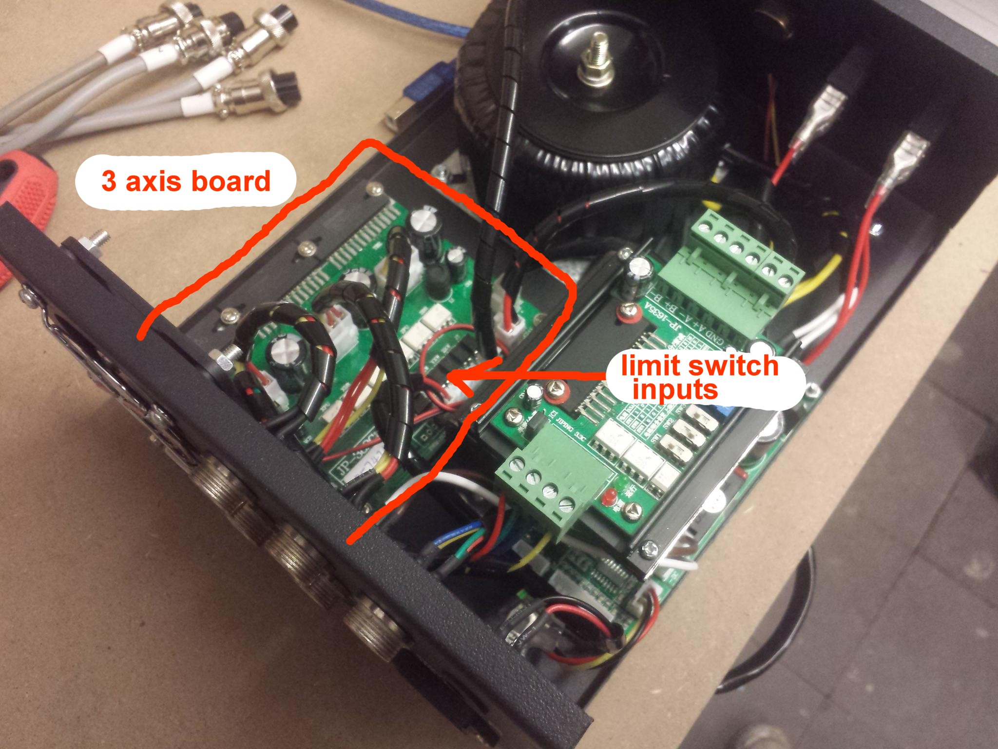

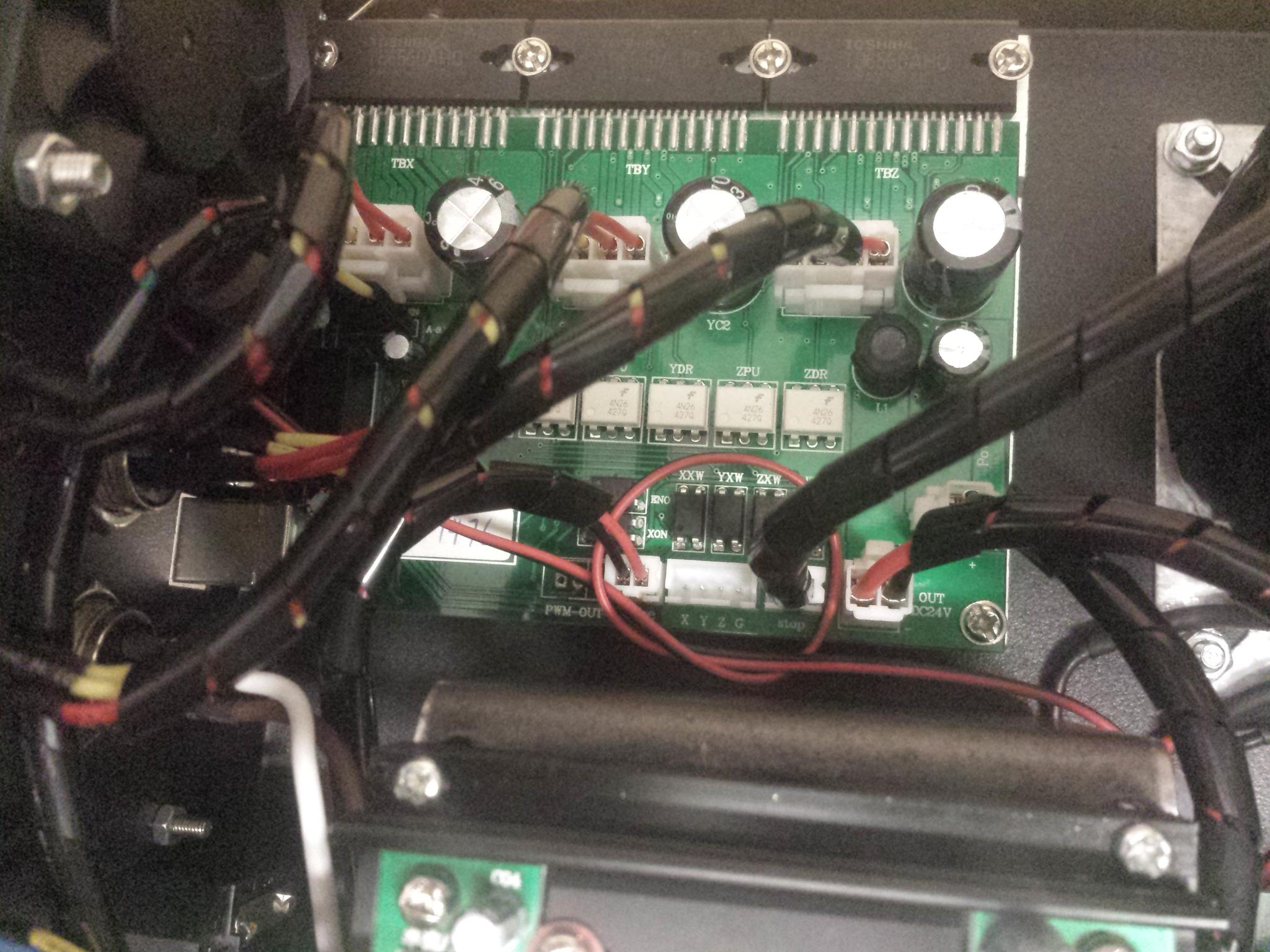

    it looks like it may be possible
    but I would need to see more detailed photos of the 3 axis board
Name:	3 axis board & possible limit switch inputs.jpg
    John

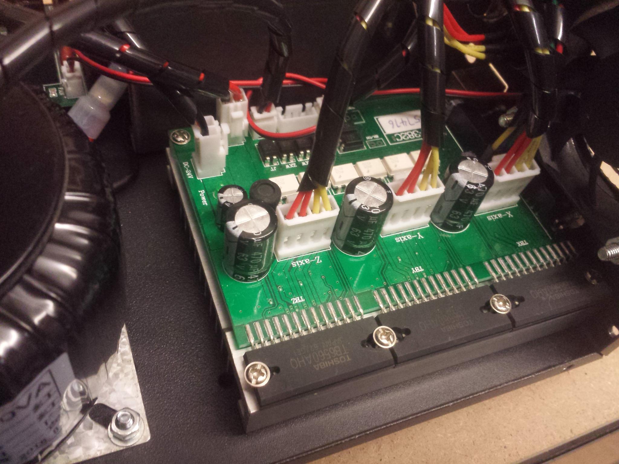

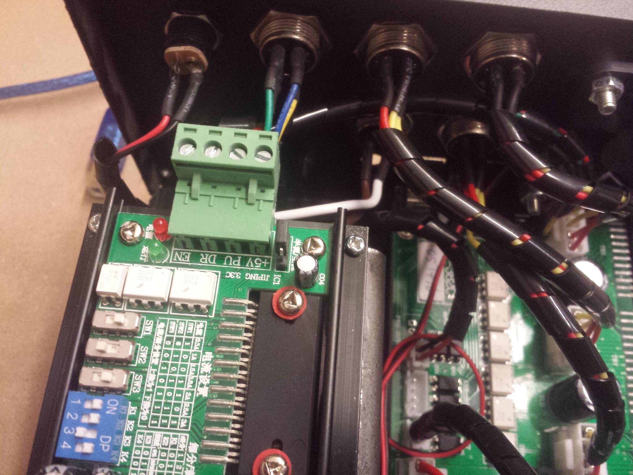

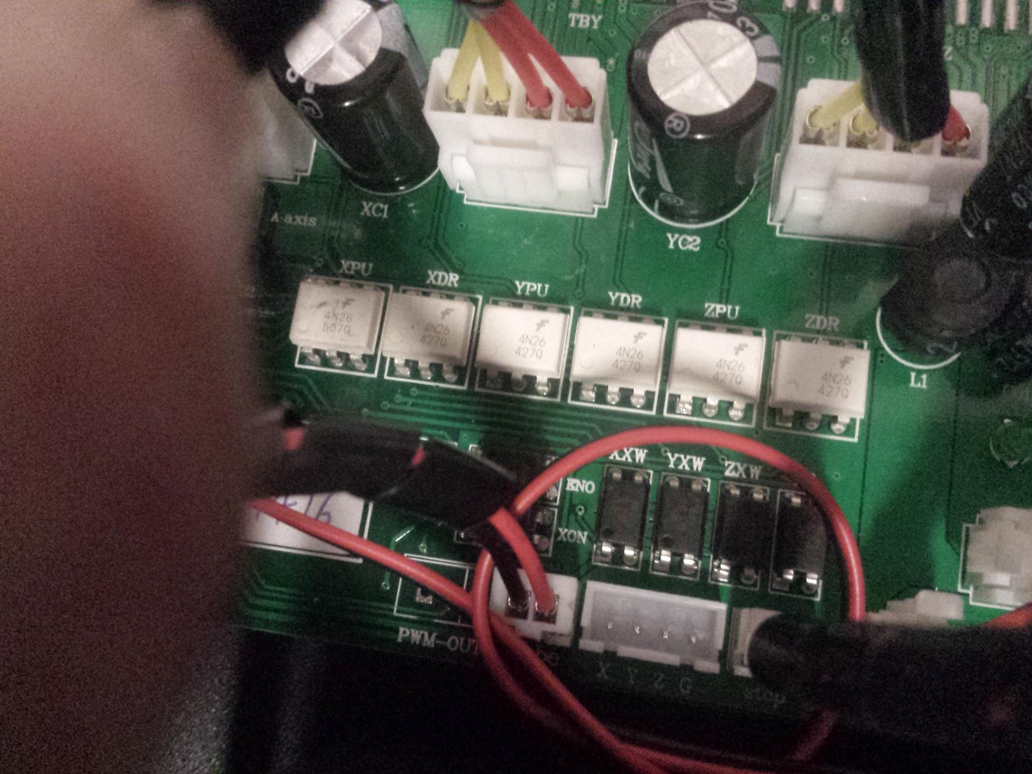

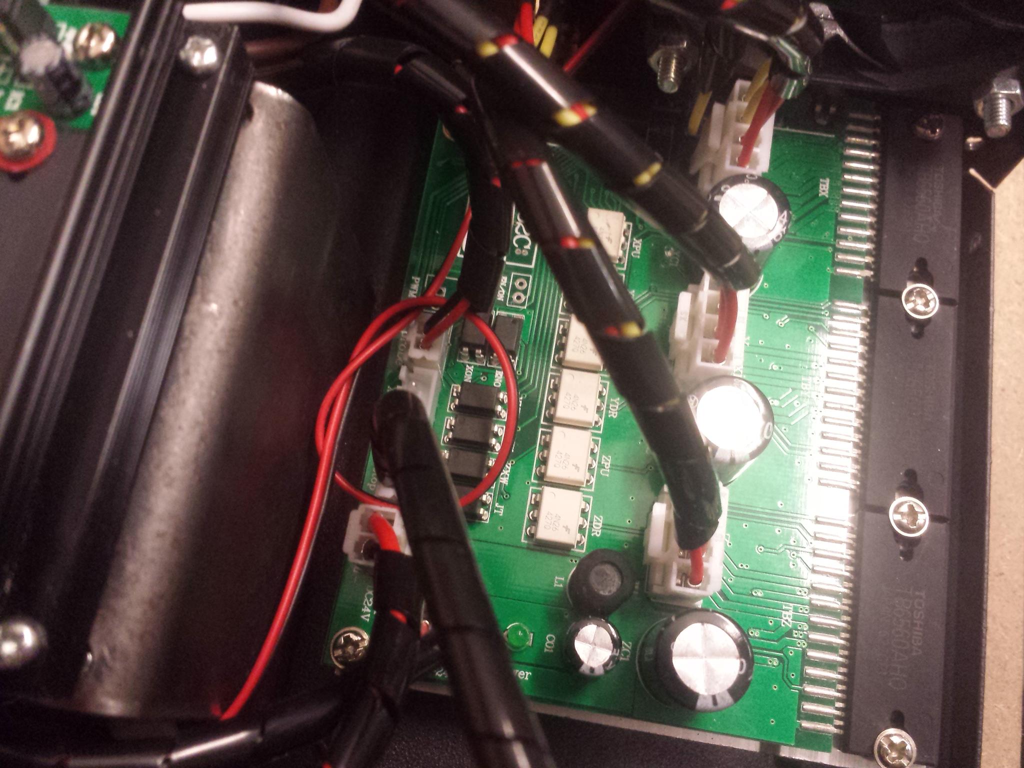

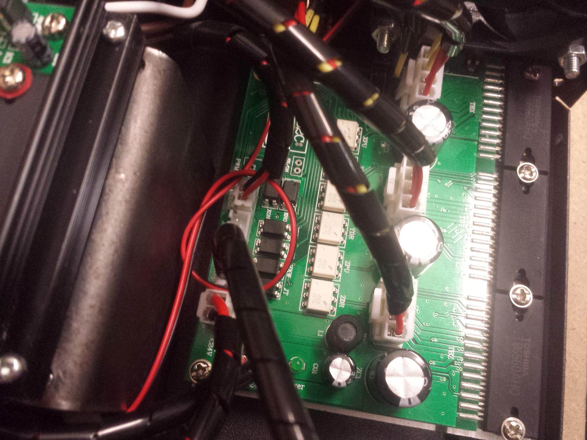

    Im at the workshop now, will take some more pics for you mate. Bare with me

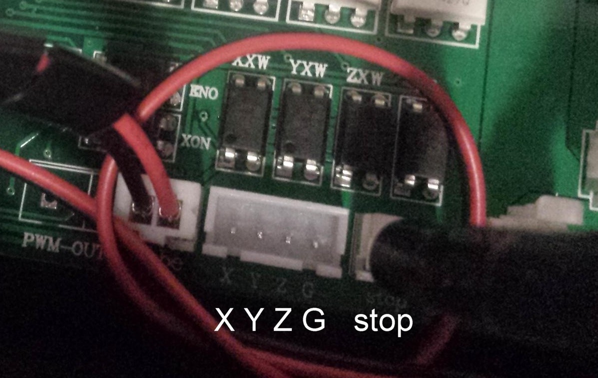

  5. Are those pics any good mate?
    yes
    this is good enough to see the ground and 3 switch inputs but not know which input is connected to which printer port terminal via opto-isolators
    since the 2 pin stop connector in this picture
    will be your E-stop
    you only have 4 printer port pins to test to find which 3 are for the X Y Z inputs here
Name:	3 axis limit switches.jpg
    John

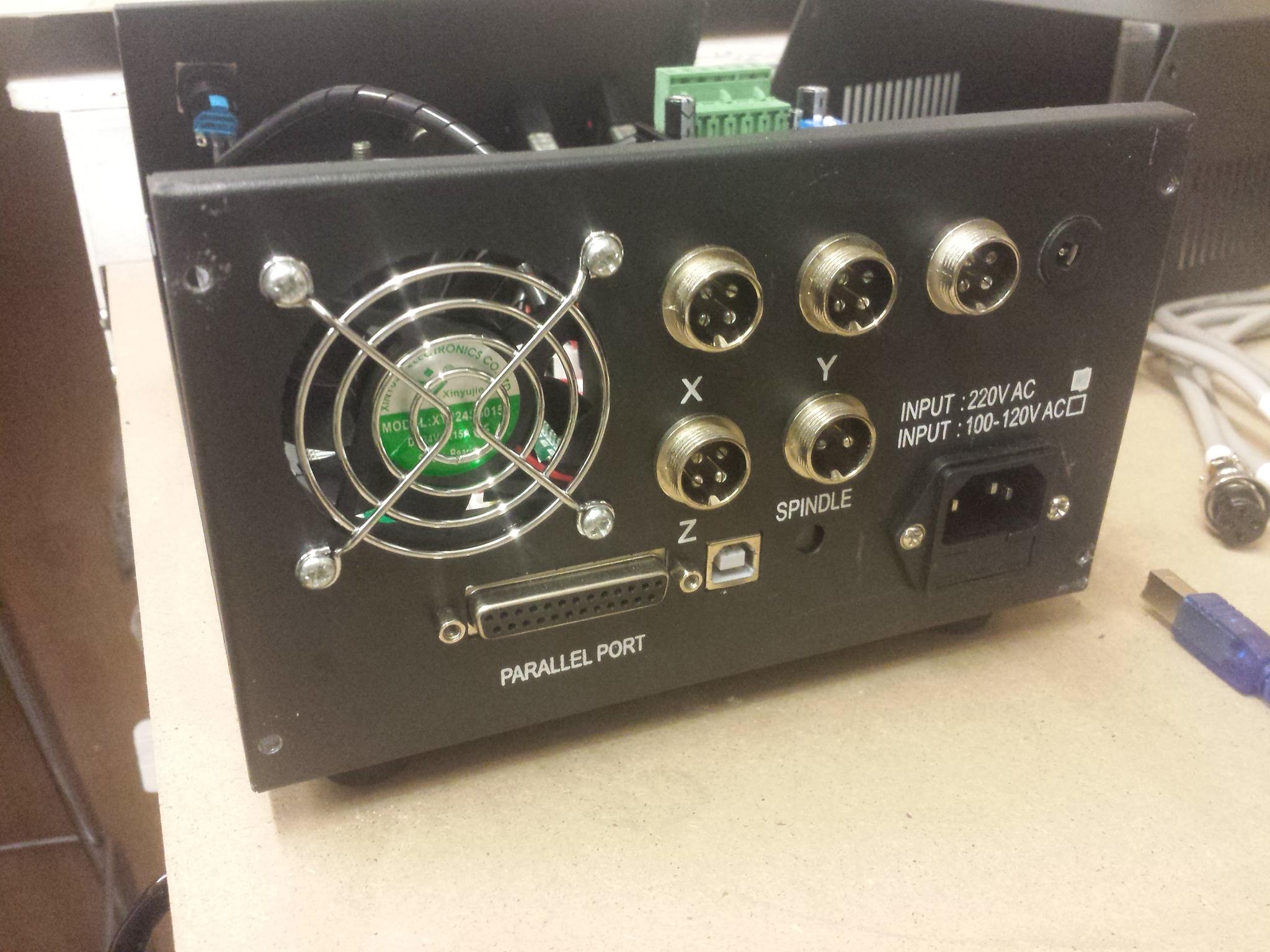

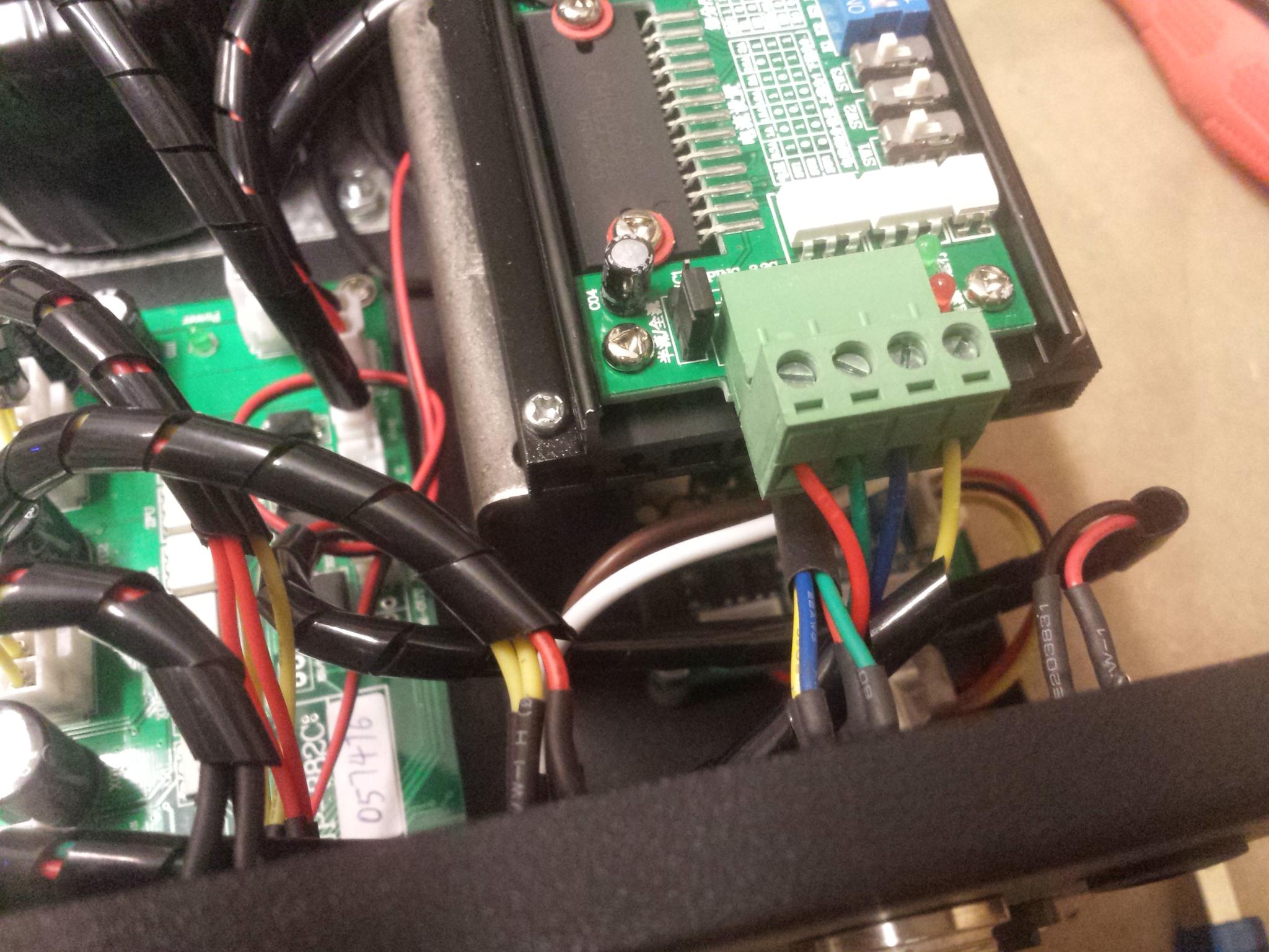

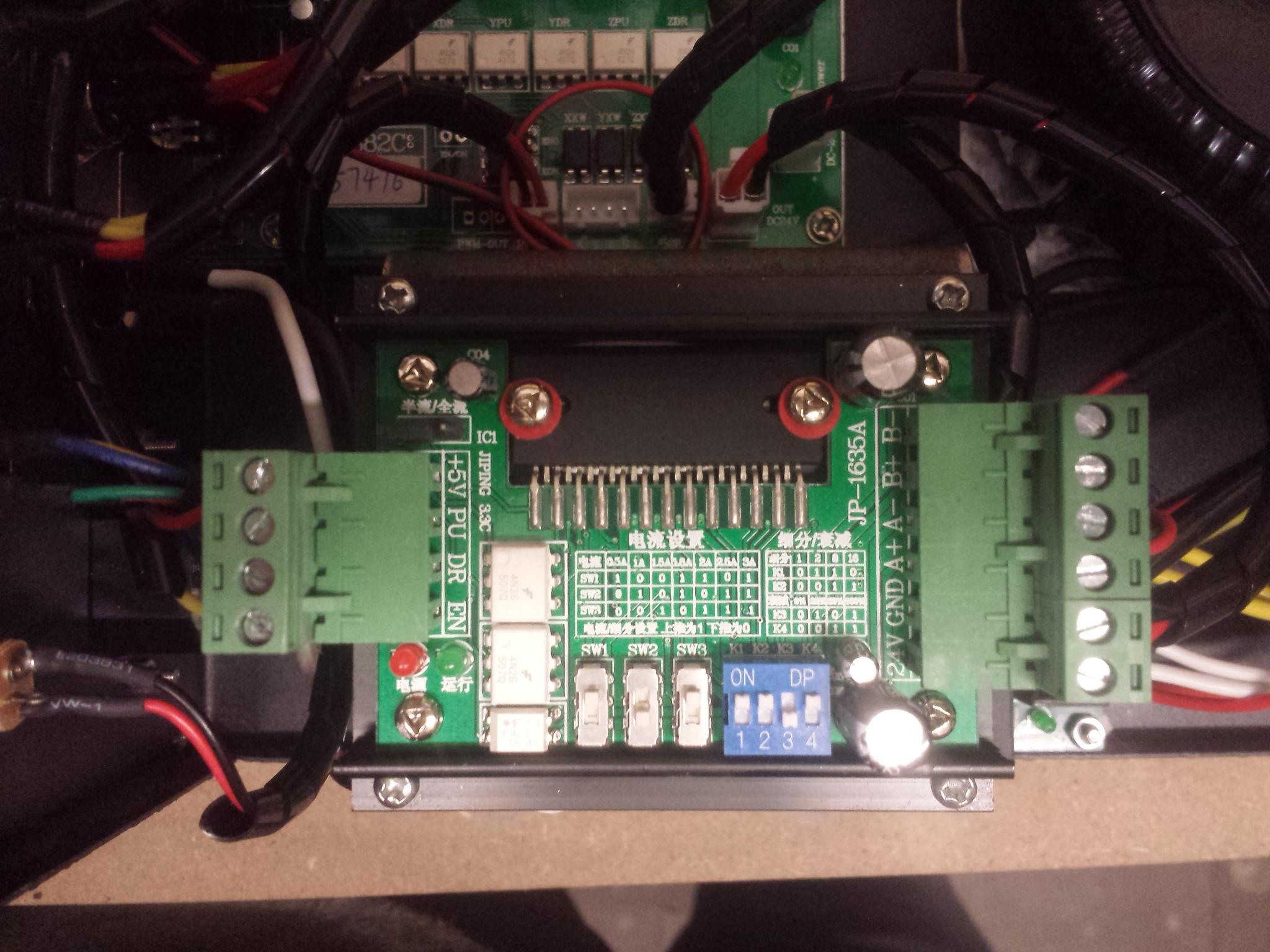

  7. well we have been doing some investigation, (my controller is usb not parallel fyi)
    I think the axis board is buggered, the x axis works only for a few seconds then stops, but on the screen the marker thingy still moves. I have contacted the ebay seller as to how to resolve this as the etsop button also does nothing at all to either the x,y,z axis the spindle or the software.
    Im thinking of buying a planet cnc mk3/4 board? but seems a bit extreme considering this is a brand new machine
    from this view your control box has a printer port connector
Name:	control box printer port and usb connector.jpg
    other pictures of the inside don't show enough detail to see how the printer port connector is or is not connected to the stepper driver IC's
    to be controlled by the USB port there must be a motion controller of some sort hidden under the PCB - possibly a copy of a a planet cnc board
    just in case you send the box back for exchange
    It will be better not to disassemble it any further
    John
    Last edited by john swift; 22-06-2017 at 11:06 PM. Reason: add ref to possible copy of a a planet cnc board
