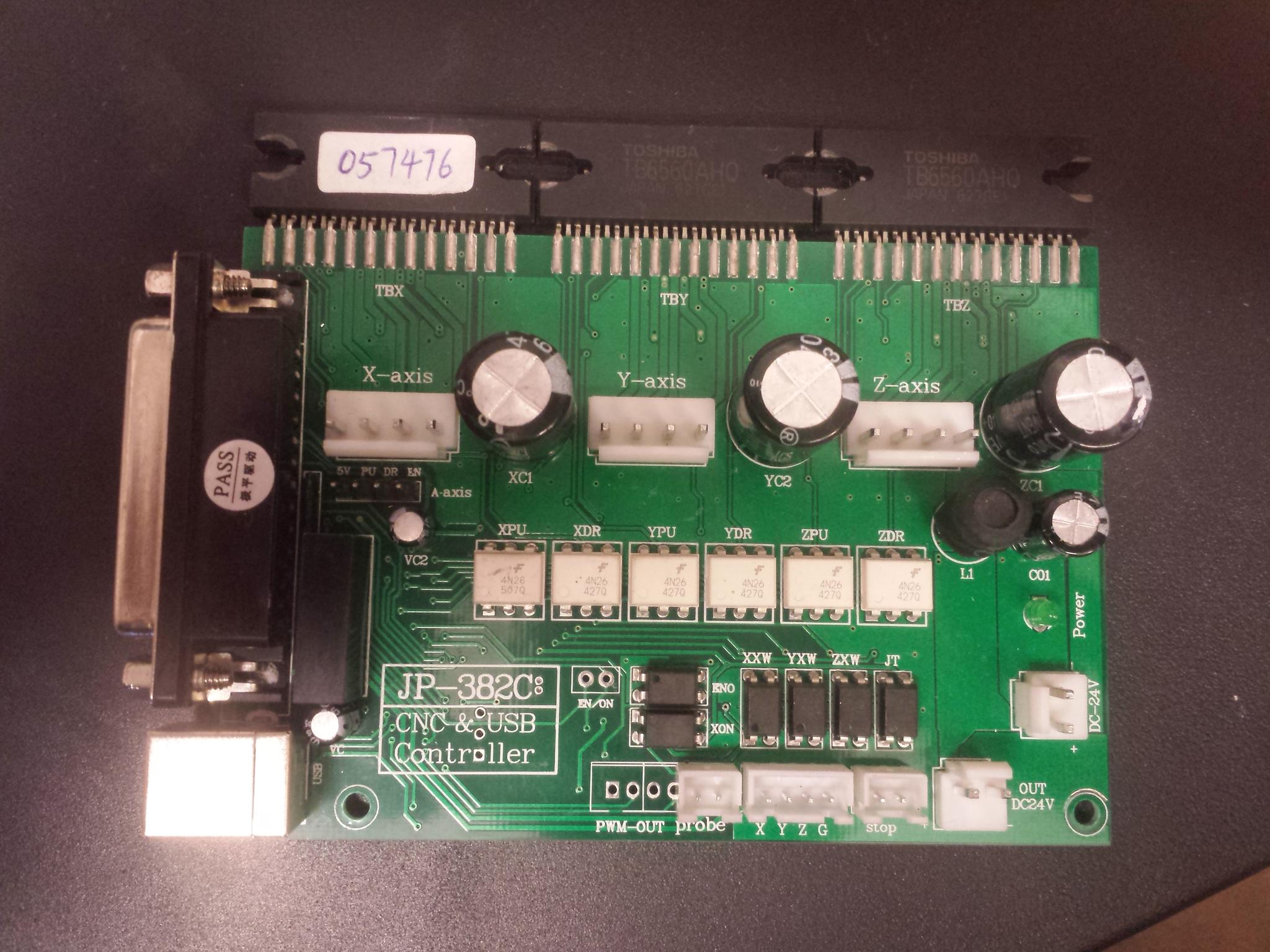

  1. not currently but I have a parrallel card I can install if needed, just seems another waste if I have already paid the money to have the planet cnc license
    What if its the drive, not the board? Dont be in a rush to buy

  5. Right chaps, im down the workshop armed with a multi meter. Can you direct me on what to do now lol
  6. There is something defo wrong with this board, Ive tried other cables etc and same result. Had the multimeter out and found the following out.
    when you apply a jog to the y axis, all 4 pins outs (2 yellow and 2 red) rise to 12.9v and hold
    When you do the x it rises to 13 then nothing except one stays on 26???
  7. So I think this was the problem with my box.

  8. I have decided to take the plunge and give up with this control box, as much as everyone have been helpful I'm just so out of my comfort zone with my lack of knowledge, it is easier to just buy a pre-spec'd box and assemble myself. I have no problem what so ever putting things together, its just going to take a bit of time learning what each part of a box/cnc setup does, going to be a steep learning curve but a fun one.
