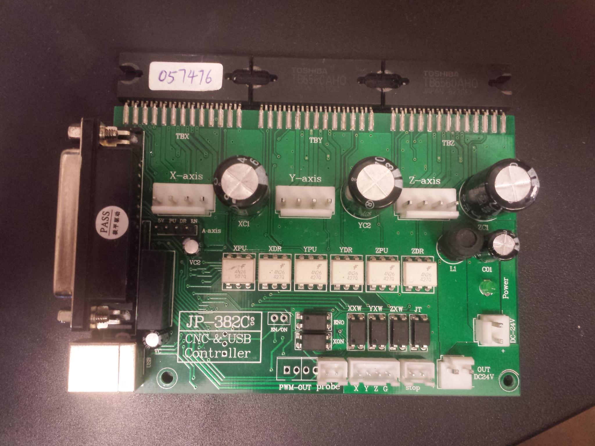

  1. Well been trying to get the machine to work only to find that there is something seriously amiss with it. Firstly the emergency stop button does absolutely nothing when pressed.
    Secondly the x axis isnt working properly. It spins the motor for a second then stops, but the illustration on the screen is still moving.
    A few people have said that this is a cheap planet cnc copy and that they are basically crap. I have spoken to planet cnc and they have said it is hit and miss if these controllers work or not, they have recommended buying one of their control boxes.
    Has anyone had any experience with these? Are they any good? Cost 550e so it more than i paid for the whole machine but if its worth it then I will get one.
    Any help would be great.

    First it would be better if you kept all your posts in one place as people have to trawl through the other posts to see what has happened.
    Can you send the machine back?
    This could happen if he axis is binding and then stalling can you check if the motor keep going when it is not physically connected to the machine?

  3. its nothing to do with the machine i dont think, as if I swop the leads around between the x and y then the x axis works fine, but the y axis now works intermittently.

    Do not take no for an answer, if possible send the whole thing back for full refund add the €550 you were going to spend on a control box. Then save up so you got €1500 and then get a 2nd hand one through the forums and you'll not regret it ;) I know you're eager to cut but it's nuts to pay that much for a controller for the kind of machine you have.
    You can get it working with an Arduino UNO, cnc shield & steppers for ~£25 with grbl.
    You have checked the wiring it might just be dodgy connections?

  5. I cant afford that at the moment, I am also woried about the scenario of me shipping the machine back to china, then it getting damaged and im left high and dry, or just with even more complications. If this control box is any good then I will be happy to purchase it and then upgrade the machine once I have learned how to actually use it. I think the control box should be more than up to controlling a bigger/better machine?

    I have suggested sending just the control box back and them sending a new one, I think this would be the easyest and easiest way to resolve this.

    Are those boards you mentioned? I was going for the planet product simply as I have the licensed software so thought I would get very good support from them? (which i obviously need)

    https://github.com/grbl/grbl
    it's open source 3 axis solution (No 4th axis) support is very good on forums.
    If you use an Arduino mega (Add another £5) 4th axis is possible with grbl
    https://zapmaker.org/arduino/program...e-on-mega2560/
    That said check you're wiring I bet there's nothing that wrong with the electronics just dodgy connections.
    Get that box with the electronics open and get some photo's from inside.
